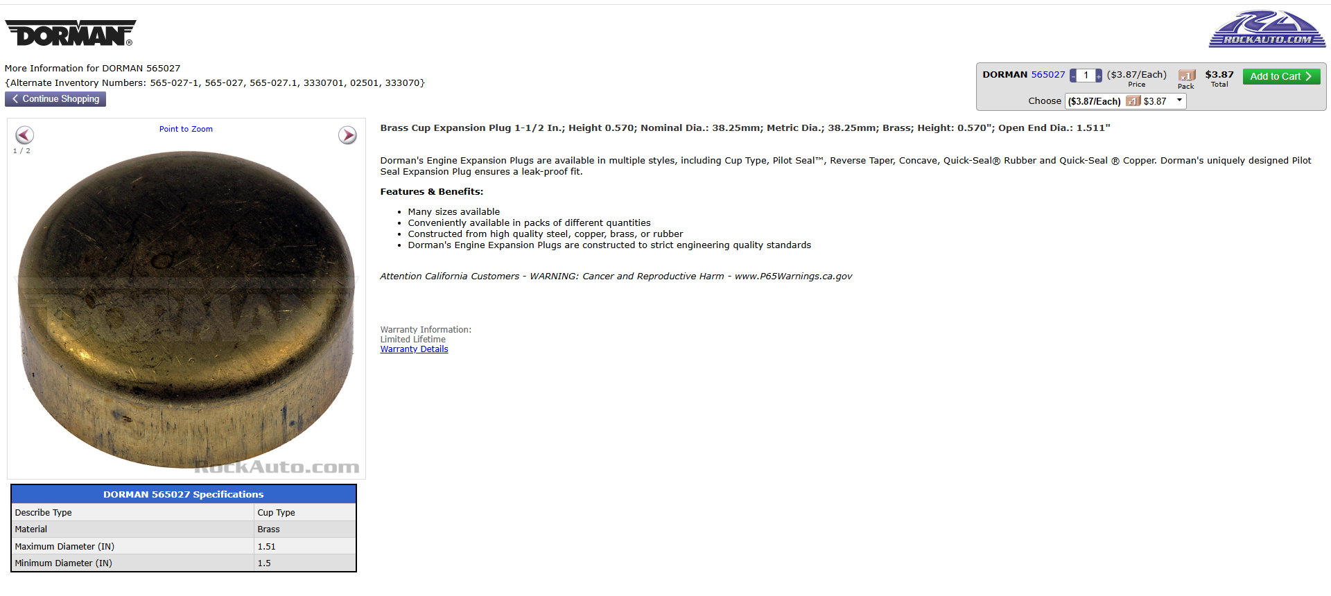

  11. Mr48chev
    Joined: Dec 28, 2007
    Posts: 36,000
    Mr48chev
    Rock auto is showing two sizes in their listing 1-1/4 inch and 1-1/2 inch. This is for a 1965 Cutl*** with a 330.
    Dorman is a very common brand of parts here but I don't know about the availability in Europe. You may be able to match the measurements though.
    You weren't far off in the translation as they are "core plugs" or "soft plugs" used to close off the holes from Sand Casting the coolant p***ages.
