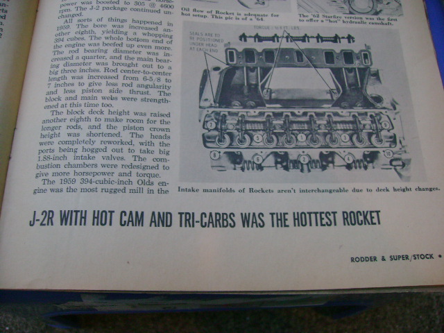

    As I was reading this thread earlier I also remembered a magazine from the mid '60's that had a very good article that answered most of the questions that were asked. But the one I remembered wasn't from PHR. It was a much more obscure magazine and it has excellent information about the interchangeability of 303 thru 394 Olds engines. I dug around a little and finally found it. Not to say that there wasn't also a PHR article but this is the one I remember.................... Rodder and Super Stock from August 1966. I believe I may have bought this issue specifically for the article. I'll try and figure out how to scan it later.
    http://www.jalopyjournal.com/forum/attachment.php?attachmentid=2022703&stc=1&d=1378338868
    http://www.jalopyjournal.com/forum/attachment.php?attachmentid=2022704&stc=1&d=1378338868
    http://www.jalopyjournal.com/forum/attachment.php?attachmentid=2022705&stc=1&d=1378338868
