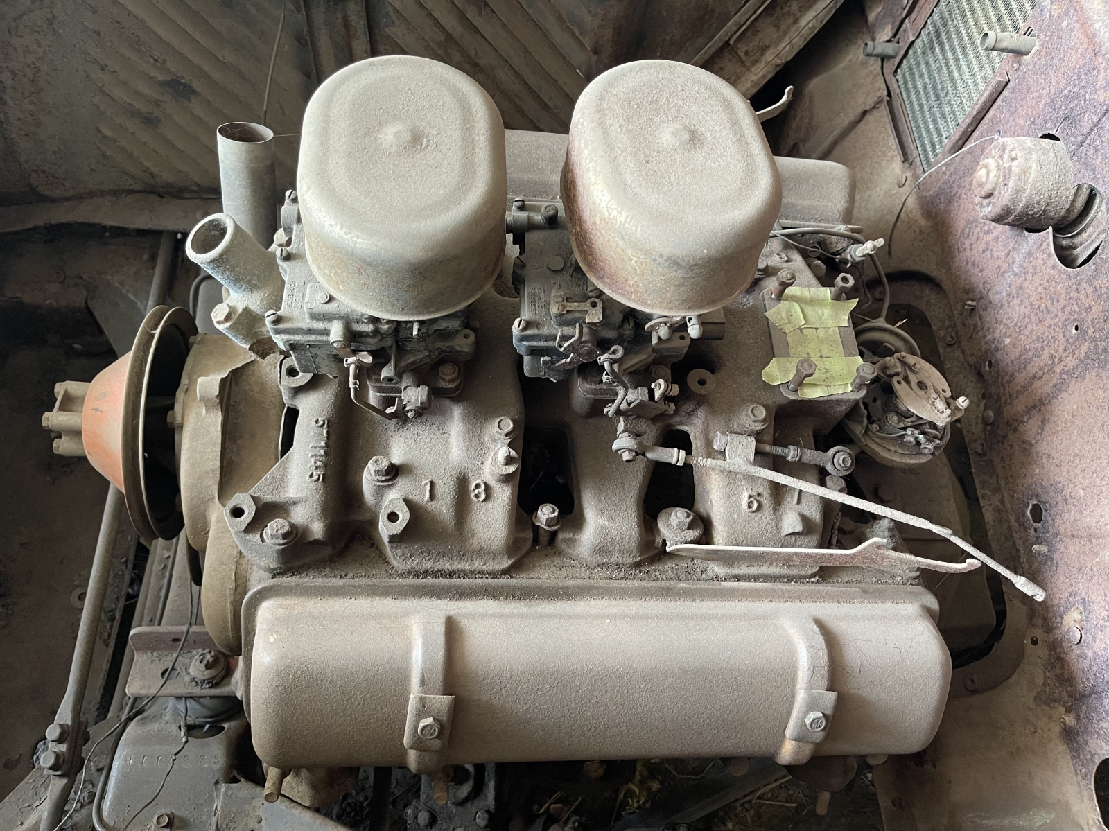

    Bought a 57 371 J2 Golden Rocket short block that I plan to build up into a running motor. Have had a hard time finding heads (shocker right?). Found a pair of 371 heads from 1959. Will these work/fit on my 57 J2?
    Thanks all for any insight.

    Those 59 heads might work but the 59 371 has a taller deck height that is the same as a 394,I would stay with 57 or 58 heads if possible.
