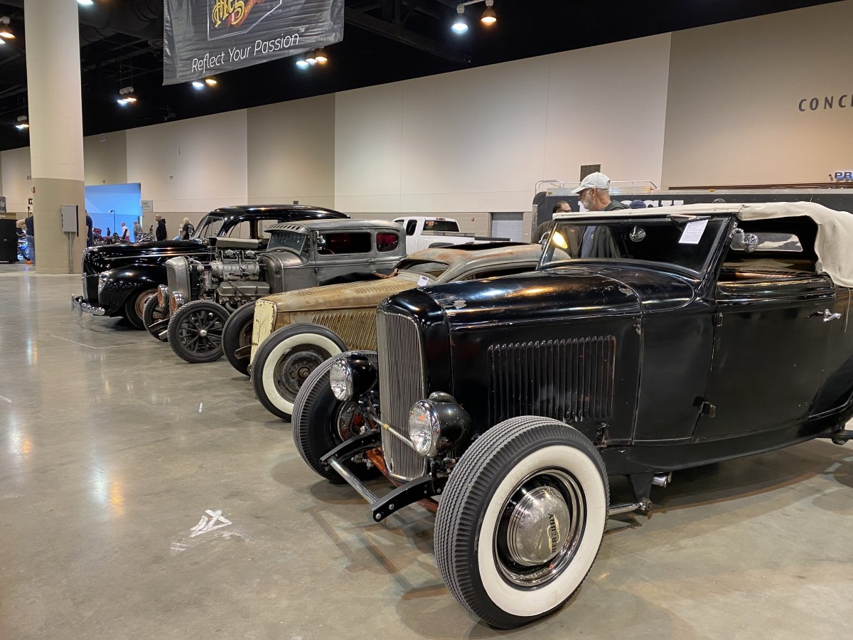

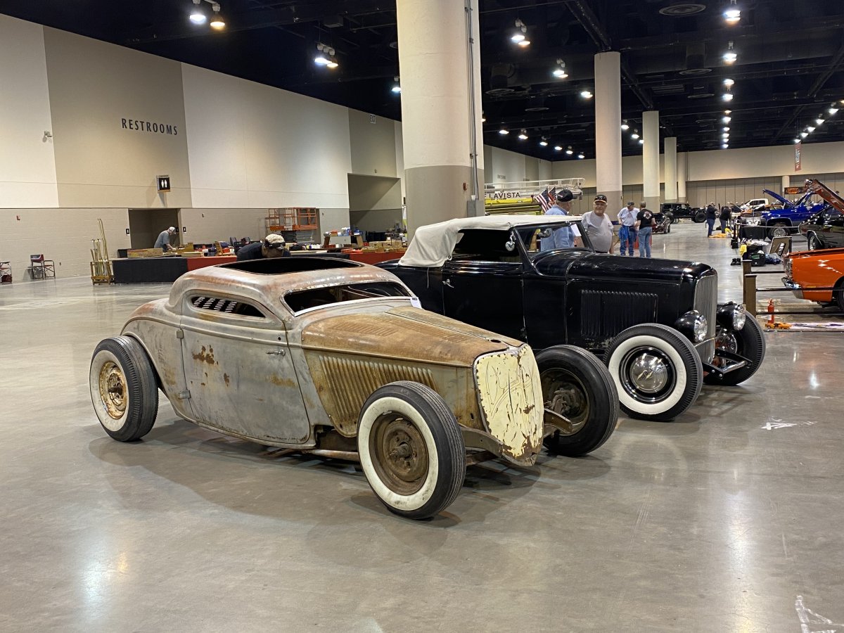

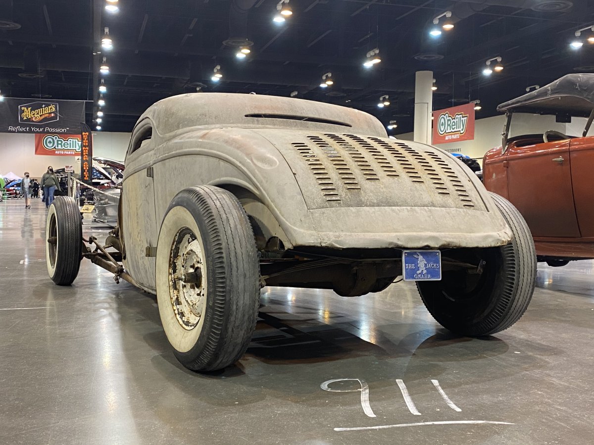

  8. tdog
    Joined: Nov 15, 2009
    Posts: 444
    tdog
    from Omaha, NE
    The show went great ! A lot of kind words and heard some new stories about the car . Had it sitting within an inch or two of ride height I was looking forward to walk around it to check out the stance and wheelbase (location of front axle) I am very pleased and going to move forward as.

  10. tdog
    Posts: 444
    tdog
    from Omaha, NE
    After the World of Wheels show last weekend we lined up the Omaha Coupe with Lincoln, Nebraska's Tim haith's 33 Ford Hot Rod 3w that he built all himself. He chopped his close to 2.5 inches. It was cool to put them side by side . 159971539_127345186061931_3102275943161441798_o.jpg 160157462_127345189395264_1259616491222198915_o.jpg 160300759_127345196061930_2220926192942851174_o.jpg 160569421_127345182728598_1739992826222181438_o.jpg 161783616_127345192728597_6943442635781972609_o.jpg 162069352_127345176061932_8524009017874749523_o.jpg

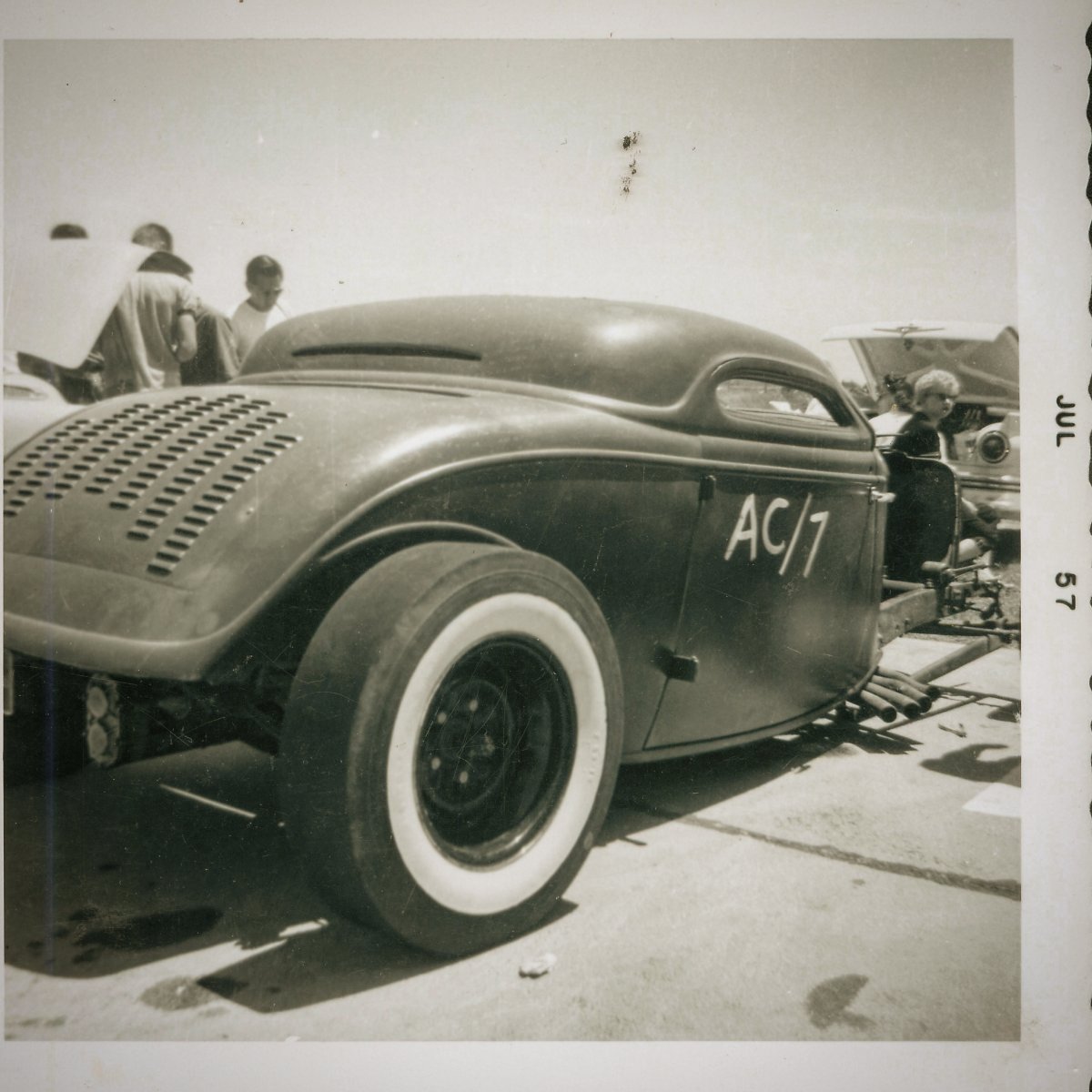

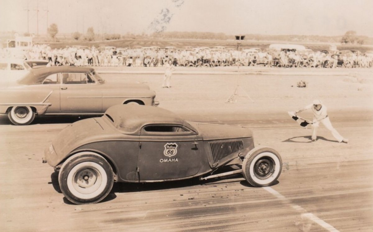

  18. tdog
    Posts: 444
    tdog
    from Omaha, NE
    I believe that amazing photo was taken it 1955 in KC the first race at the new drag strip . It is my understanding that the coupe took Top Eliminator that day . Thanks for sharing

  29. tdog
    Posts: 444
    tdog
    from Omaha, NE
    Getting the frame at mocked up ride height for the World of Wheels show .
