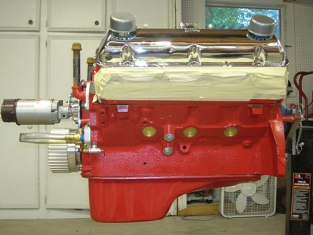

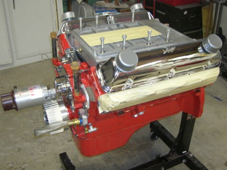

  1. One each bitchin 430 MEL just waiting on the blower and injectors. Eat your heart out Unclscooby,,,,just kidding of course

  5. unclescooby

  15. HENRY FLOORED: Believe me, back in the late 50's and throughout the 60's, Fords & a few Lincolns ran and ran good. Althought the MEL never got a big name due to the FE gettin all the attention, The MEL was a tough hombre to outrun if you knew how to make a it live. They were encridible torque monsters. Many a Hemi, Olds, Pony and thousands of SBC's bit the dust behind a MEL. The biggest problem with the MEL was the weight. But early on, the cubes they offered "off-the-shelf" provided more than enough to make up for the weight. We ran them as large as 545 CI with little trouble in 1960.
    LEON RENAUD: Damn, I'd love to see that one run again. Back in the early 60's there were several AG and AGS cars running the MEL and they were screamers.
    SPECS: 436 CI
    Block: 1961 430 MEL from a Lincoln Continental... Found in a junk yard
    Bore: 4.3 with +.030 bore
    Pistons: Ross flatop forged which I then had cut back to provide 7.0:1 compression. Got them off of e-bay
    Heads: Stock accept they have been flycut to use FE springs & retainers.
    Valves : 2.1 Int and 1.95 exh.
    Valve springs: Lunati FE. Got them of of e-bay
    Valve spring retainers & Keepers: NOS Isky FE. Got them off of e-bay
    Cam: NOS Isky 5Cycle roller (505 lift, 324 duration( Got it from Vintakes on the HAMB)
    Roller Lifters: Crower FE. Got them new from Crower
    Pushrods: Crower BBC. Got them new from Crower
    Rockers: Old Isky adjustable 1.5. Got them through a HAMB'r from a dead Lincoln racer in Tulsa.
    Flywheel: Old Scheiffer aluminum FE. Got it from BlownOlds on the HAMB.
    Clutch, Disc & TO Bearing: FE 427 heavu duty 11" inch clutch & plate. Got it off e-bay
    Bellhousing/Scattershield: Old FE. Got it off e-bay. Modified it to fit MEL
    Magneto: Joe Hunt Vertex. Got it off e-bay
    Mageneto Drive: Home made
    Injectors: Hilborn 4 port w 175M (nitro pump). Got them from a HAMB'r
    Blower: GMC 6-71 rebuilt. Got if off e-bay
    Blower Manifold: Weiand LME6-71. Got it off e-bay
    Blower drive: Old Isky pulleys. BDS Idler. Gilmer belt. The rest is home made
    Much much mcuh more,,,,later.
    Costs: If ya gotta ask, you can't afford it...LOL...and neither can I. So far, not countin about $3,000 woth of machine work I got free from a bud, I have around $8,000 in the engine
