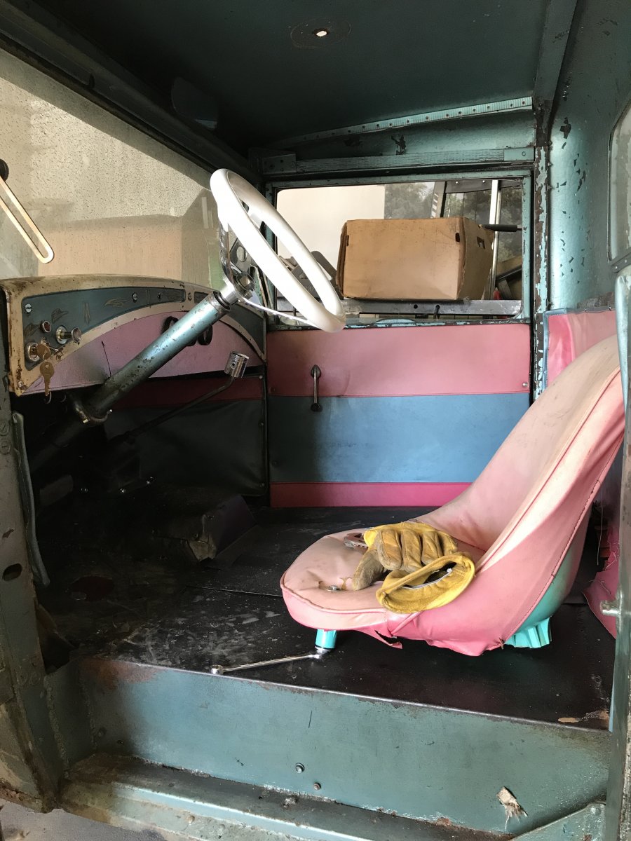

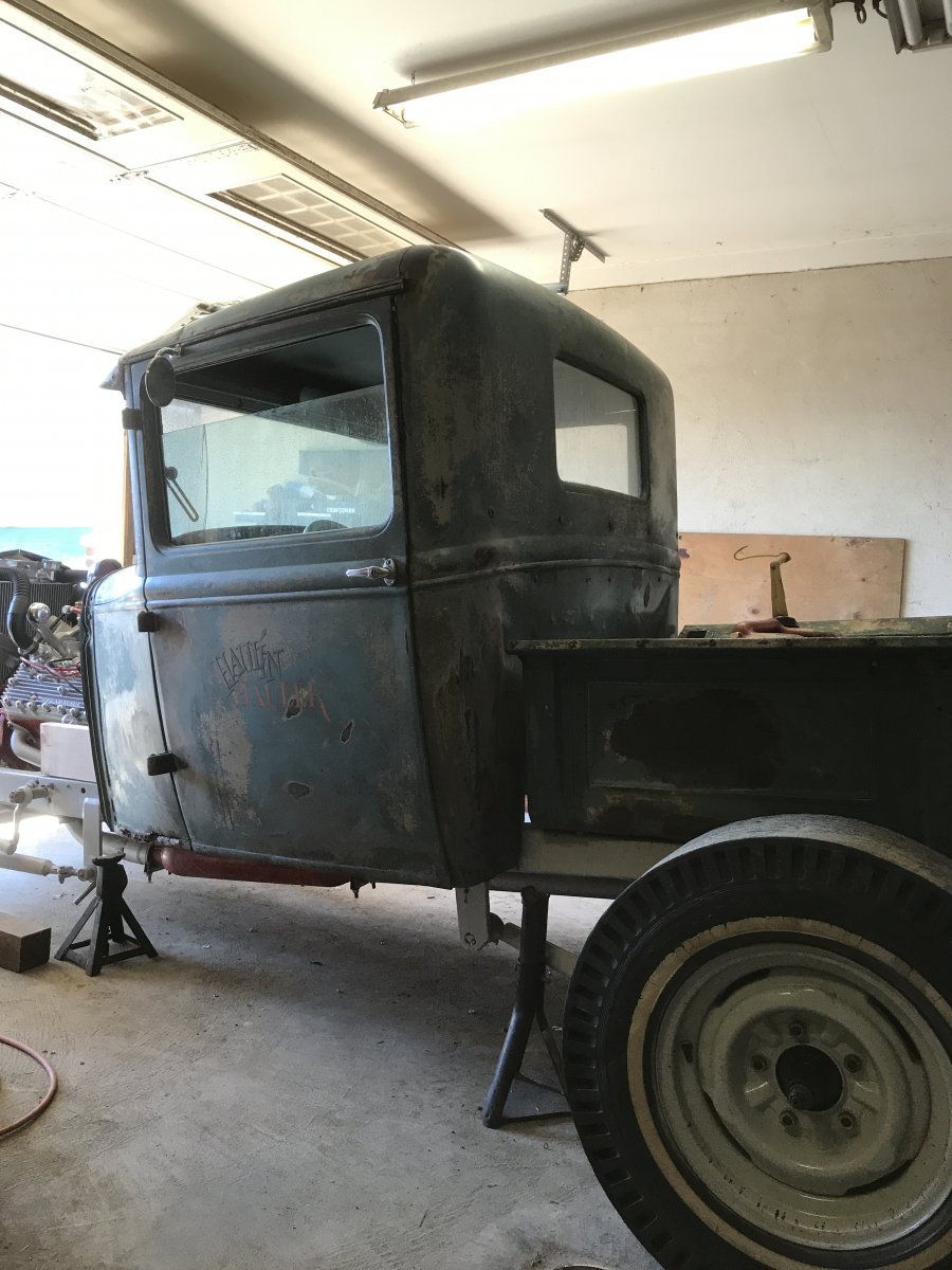

    The resurrection begins. Started removing some of the interior to see what changes had to be made to make it a driver, well besides being color blind in '57 they also weren't too concerned about structural stability. As the sign says "The Kids" must have built this one haha. '31 reconstuction 001.JPG '31 reconstuction 004.JPG '31 reconstuction 013.JPG

    That bar at the end of the drill bit under the floor was the only body mount, the floor was literally holding everything up and not very well at that there are big cracks in the top towards the back where the body has started to fall into two pieces. Those 5 5/16" bolts through the floor are the only things holding the cab on. Looks like this may be a little more involved than I thought.

    Too late it was built ****ed up haha. I've ordered all the cross channel and cross members to fix the floor and I've raised the cab to see how it would look channeled only the depth of the frame so you could actually drive it. Here's before and after pics. coming.

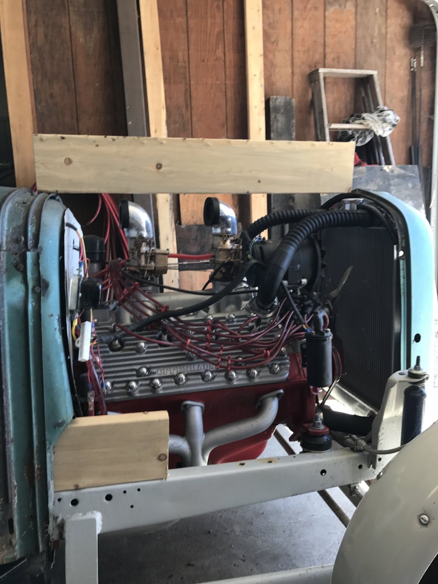

  11. Doodlrodz
    Joined: Feb 6, 2006
    Posts: 1,439
    Doodlrodz
    You can see by the 2x6 under the cowl it had to be raised 5 1/2" to get to the bottom of the frame and bring it up to where the radiator wasn't way above the height of the cowl.

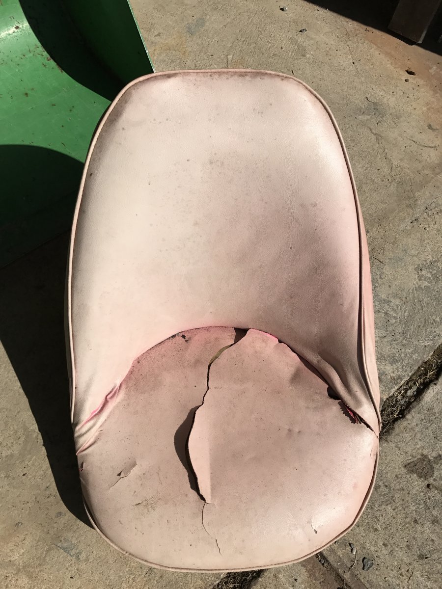

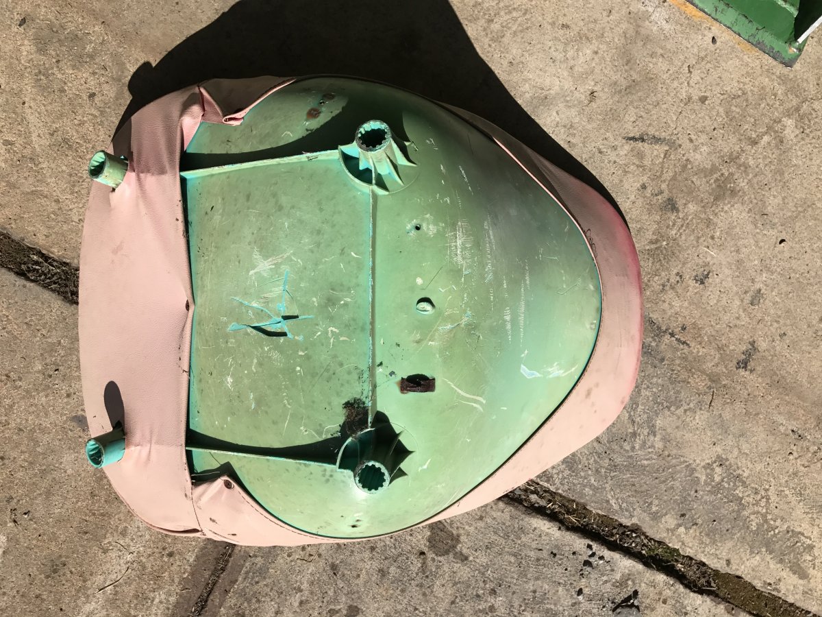

    I think "the kids" must have dropped out of school and taken their chairs with them. '31 reconstuction 005.JPG '31 reconstuction 006.JPG
    I'm keeping all the original stuff that I'm taking off just in case the next guy wants to go back to the way it was.

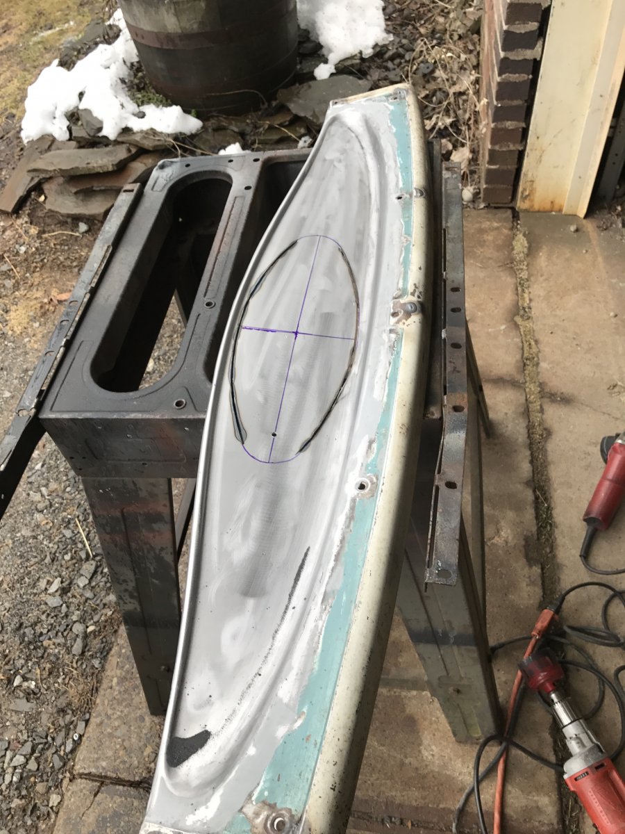

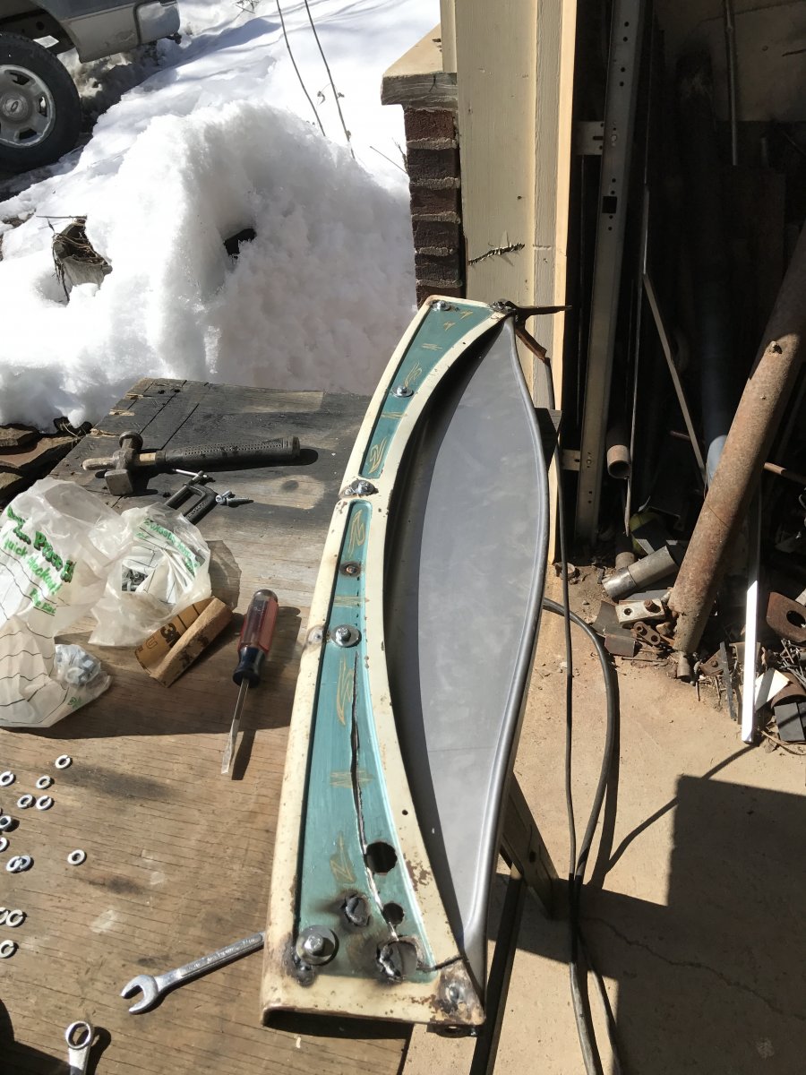

    paint 005.JPG Any OLD paint guys on here? I took my grille shell to a paint place today to see if they could match the color for me and they couldn't get a really good scan because there isn't a really flat spot on the grille so we looked at '57 colors thinking maybe they used one when they built this, the computer came up with a tropical turquoise that looked good on the screen but came out way off. The guy in the store said try to find an old paint guy they'd probably recognize the color. So here's some pics. if anyone can help. There is quite a bit of green in it and '57 Ford did have a Caribbean Turquoise that looks close on the online pictures. paint 008.JPG paint 006.JPG paint 001.JPG
    The first picture shows the difference between the inside of the doors and the dash.

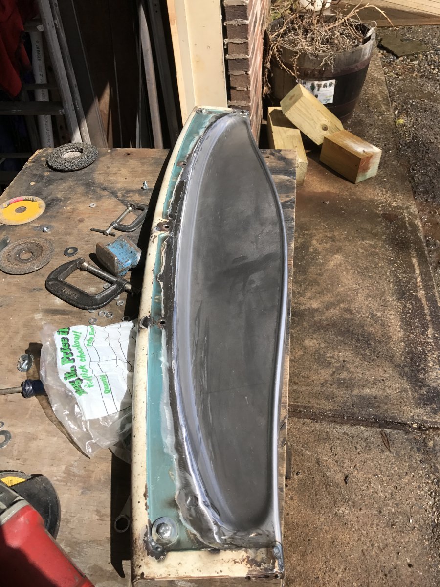

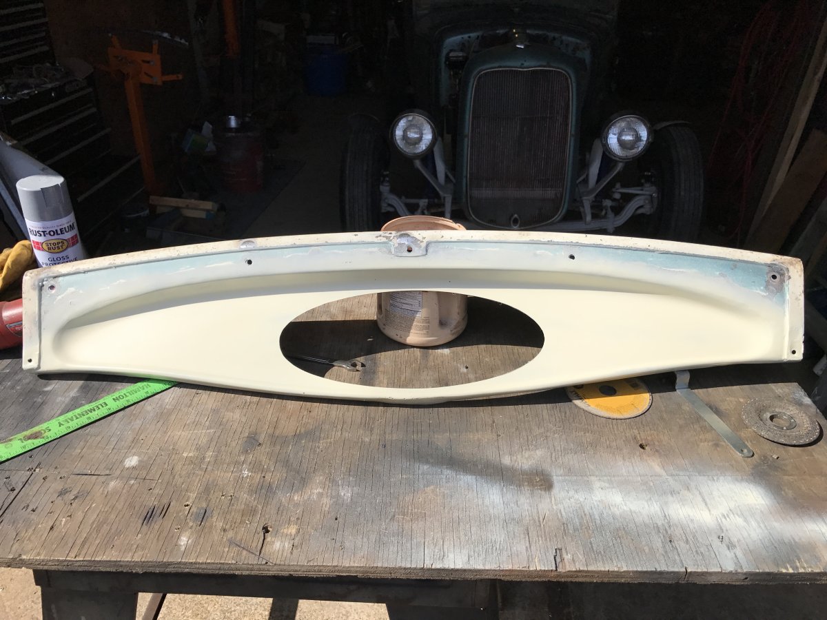

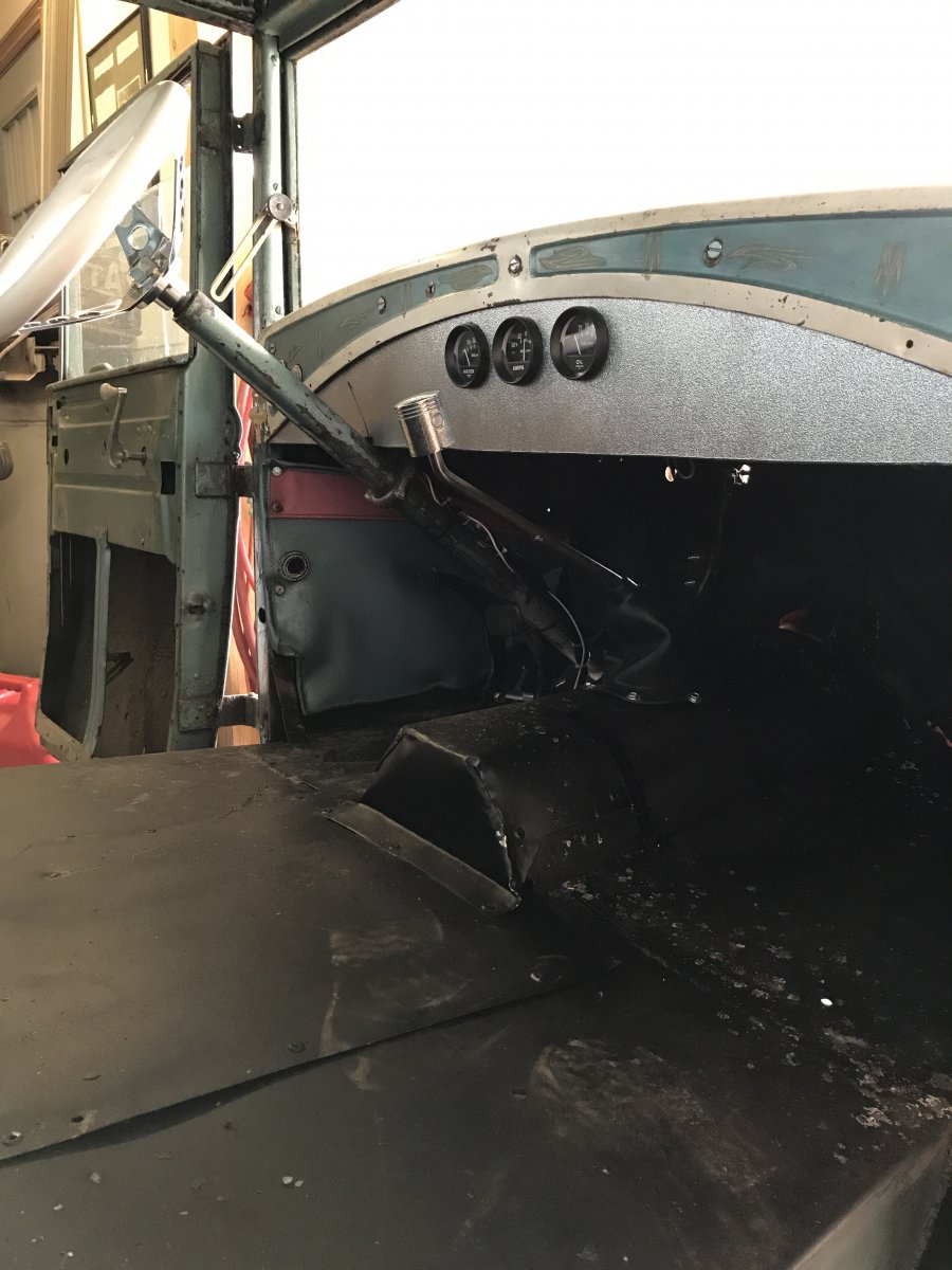

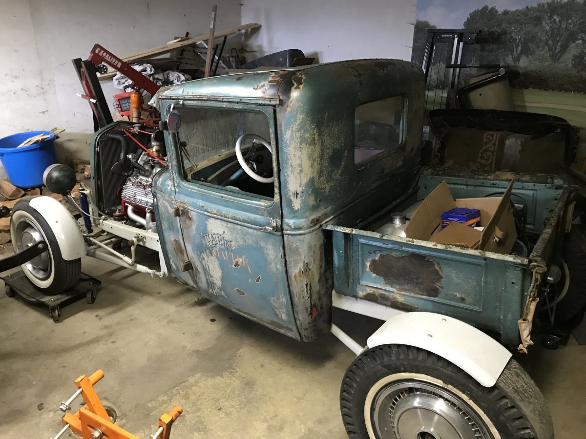

    Thanks guys, yeah cool is one thing but what good is it if you can't drive it? I guess that's why it sat in a museum for many years. I have almost all of my parts now to tackle the floor all I need is for the weather to improve so I can roll it outside. Still struggling with the dash color, I've painted it and stripped it 4 times now and don't like anything yet. I'm thinking maybe paint the lower portion a bare metal look like it was originally and leave the dash rail as it was. When I got it the old stewart warner gauges were gone and the lower portion of the dash was plastic. I bought a '32 style dash that was supposed to be a bolt in but turned out to be a project in it's own, I thought the old girl deserved some nice gauges and found these '32 Plymouth gauges I love 'em but they're almost too nice. I don't think it came out too bad for doing everything with a 4 1/2 inch grinder haha. '31 reconstuction 016.JPG '31 reconstuction 018.JPG '31 reconstuction 027.JPG '31 reconstuction 030.JPG '31 reconstuction 032.JPG
