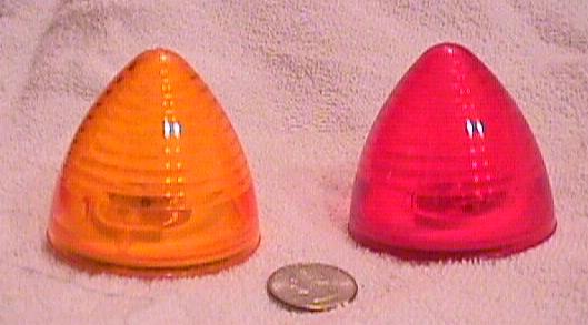

    Yorgatron, the NAPA part number for the lenses is 680-2001 and they are a whopping $1.39 each. Damn, cheapest parts I've bought for a hot rod in awhile. [​IMG]
    Here are a couple of the lights that the NAvistar dealer carries here. They are made by Trucklite and are a big $3.50 each. They are a bit longer and look really slick tunneled, even better in pairs. You gotta cut the plastic base off them though because they are sealed with a little Mickey Mouse bulb in them. I use 1157 LED bulbs behind them because of the heat.
