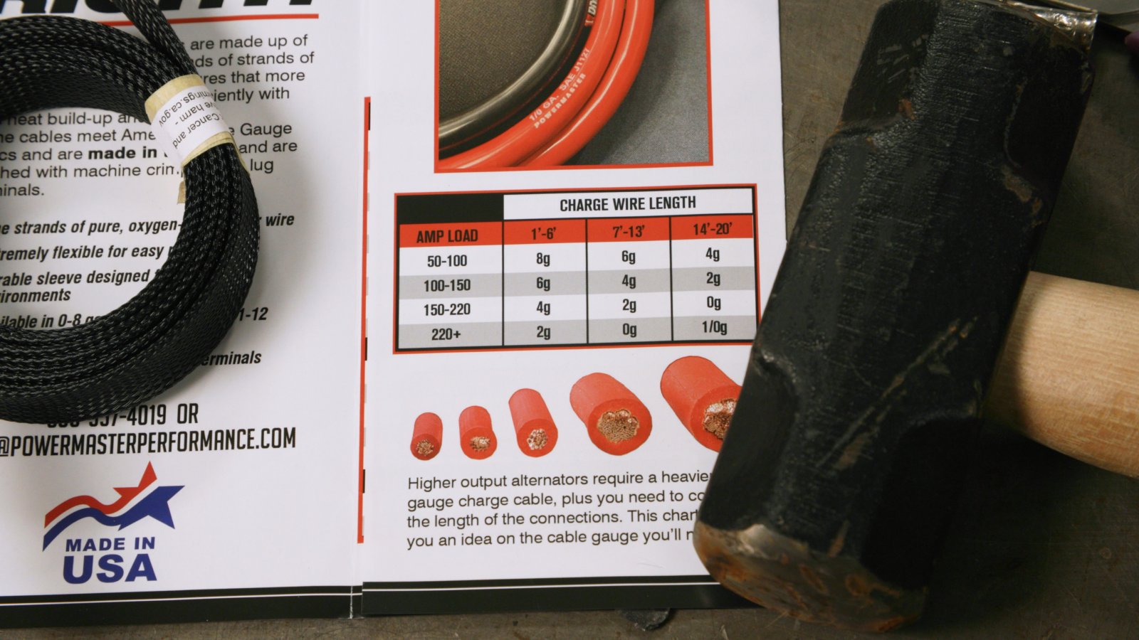

    Get yourself a cheapy voltmeter, test the battery with the key off, key on, then with the engine running around 1500-2000 rpm. The alternator has an exciter built in (more than likely) so at idle, it won't give the best reading. Compare said readings. In a perfect world, you'll get a 12-ish volt reading with the key off, slightly less with the key on (depending upon accessories), and +14 volts when the alt is charging. Anything less, something is bad, but I would suspect the alternator. When you go to swap it out, I would look at your alternator cables. They're probably too small, see this chart from Powermaster and compare to your alternator.
    Depending how the car is wired, I would reconnect what's at the alternator post now (you might have a wire that goes to the fuse panel) and run a new correctly-sized wire to either the same post on the starter as the battery cable or directly to the battery and a similarly-sized cable from the alternator's housing to a good ch***is or engine ground. Wouldn't be a bad idea to install a 100-amp Mega-Fuse inline on the +12v alternator cable either, but this isn't always a simple job due to space constraints, etc. If the rest of the wiring system is good, that should be a huge step in the right direction.
    RRanchero Rick and AHotRod like this.

    The one-wire alternators usually need to be "excited" to a preset rpm (1800 - 2000) to begin charging upon each start. Also the one-wire (aka charging wire) should be of sufficient gauge according to the manufacturer (6 or 8ga.). As mentioned the voltmeter ga. is a necessary tool to chase electrical issues.

  18. Rick, I have a one wire alternator on my 1950 Buick. Simply ran an 8GA wire from the alternator to the same post on the starter as the Pos Battery cable is hooked to. Effectively, to the battery. Left all other wires in place. Installed a volt meter/gauge hooked to a " key on" post , don't remember just where. It has been this way since 2012. Others are correct, a little throttle "blip" is needed to excite and start charging, but bet most of us do that blip anyway. Running direct will not cause nor allow an overcharge as the "regulator" is built into the alternator.
    My 1992 daily driver has 4ga cable from the alternator. Bigger is better?!
    Ben
    RRanchero Rick likes this.
