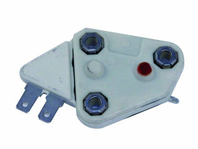

  11. trevorsworth
    Joined: Aug 3, 2020
    Posts: 2,057
    trevorsworth
    Right you are. I'm meaning the internal regulator- this guy:
    1971BB427 likes this.
  12. squirrel
    Joined: Sep 23, 2004
    Posts: 60,245
    squirrel
    Hopefully he meant the voltage regulator that's inside the alternator.
    The other possible parts that could be bad include the field and stator windings, the diodes, the brushes, and....what else is there in there? Another small diode set?
  13. jaracer
    Joined: Oct 4, 2008
    Posts: 3,106
    jaracer
    If that's the regulator your alternator has, you should be able to see that small tab through a half moon shaped hole. That is the little tab that you ground to full field the alternator.
