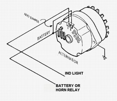

    If it's a true 1 wire it shouldn't need the jumper from batt. terminal to excite it. That picture is what someone might do to make a 10SI self exciting.

    That's a pic of a regular , ordinary 3 wire hook-up .

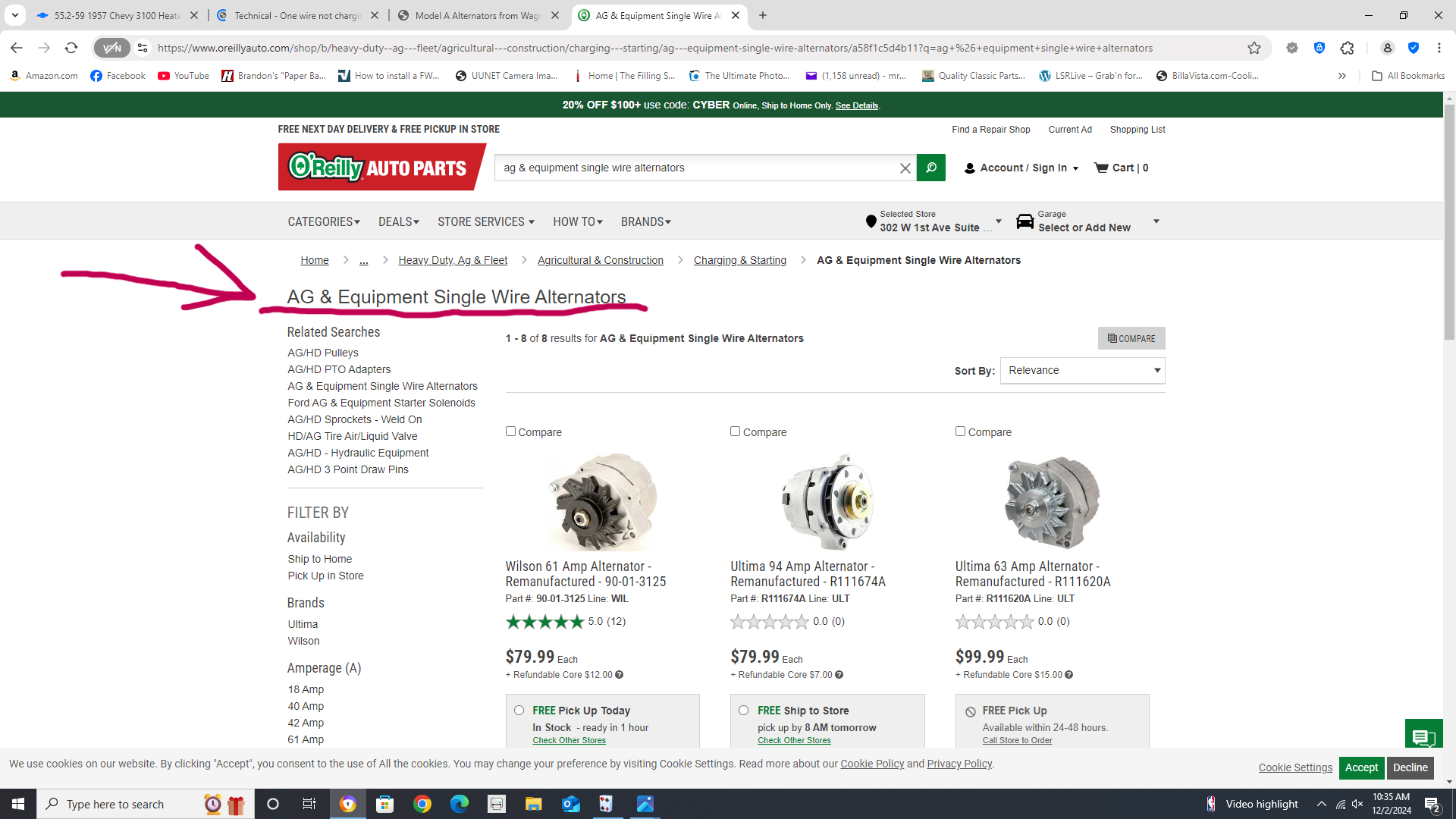

    Not that hard to find a one wire alternator either if you ask for one for a tractor. I agree 100 % that it isn't that hard to wire a standard 3 wire alternator that you can find everywhere for as little as 35 bucks rebuilt.
    The street rod magazines screwed with guys minds back a few years ago with the Clean no wire showing NOT TRADITIONAL engine compartment thing and got the one wire nonsense started.
    You could walk into most farm equipment dealers or farm country parts houses and buy a one wire alternator to put on your 9 N Ford tractor or Farmall , older diesel or Oliver tractor that ran a magneto ignition long before STREET RODDERS decided that they could get out of hiding two wires on the engine if the alternator only had one wire to begin with. That is the only ******** value of a one wire alternator on a gas powered non magneto ignition car or truck that is street driven. Mag ignition tractors don't have ignition systems except the kill switch.
    When you buy a one wire alternator you are not buying a hot lick street rod item you are buying something designed to be used on a farm tractor that does not have an ignition system to run an exciter wire from clear and ******** simple. Screenshot (1668).png

    Sort of. A normal 3 wire hookup wont use the jumper from battery output terminal. Usually use a switched 12v. off the ignition switch so that terminal isn't always hot. The drawing is the shortcut guys do.

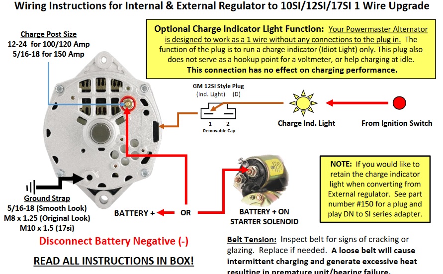

    I’ve been using this one for 5 years including the I-did-it light. I believe it’s a PowerMaster instruction sheet!

    Not always a "short cut guys do"; couple '80s GM cars I had were factory wired with the battery to terminal 2 jumper.
