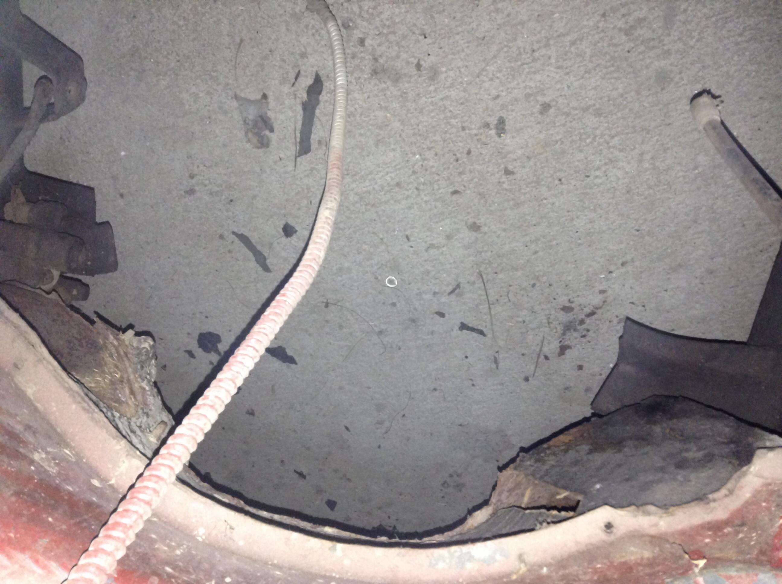

  11. v8juice
    Joined: Dec 28, 2013
    Posts: 280
    v8juice
    I made my first actual repair. I patched a 1/2 rust hole in the trunk floor. I thought this would be a good place to start as it won't show later.

    I used a wire wheel to remove about 5 pounds of tar mixed with nails :eek:from the edge of the trunk floor. underneath I found galvanized sheet metal riveted on to cover rust holes. I'm going to try to fix all of the "rust repair" the correct way.
