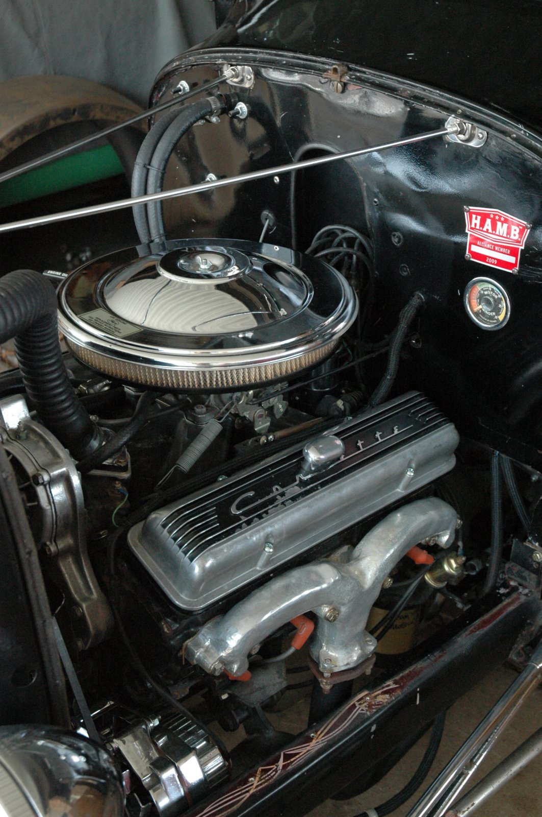

    Every single self-respecting hot rodder has used an air cleaner just like that many times over and they work just fine. They will flow plenty of air though the filtration is a little weak. The chrome probably won't last long either unless you keep right after it.
    Personally, I like a larger air cleaner that sits down over the carburetor. Many times I've used a stock air cleaner ***embly as the basis of a custom one by cutting all the shrouding away so the filter element shows between the abbreviated bottom plate and the trimmed top plate. It's efficient since it uses the stock air filter element and looks racy as heck in a kinda dirt track sorta way, especially if you use a taller element in place of the short original one. Best of all, if you shop around it could be free.
    I've made several over the years for both 2 bbl and 4 bbl carburetors, the principle is the same. Here's my latest creation made from a stock-type recessed bottom plate with a thin 2" filter element and the top cover from a gennie '57 Thunderbird air cleaner. I'm trying to keep the car loosely period correct to the late '50s and this seems to do the job. Maybe it'll give you some ideas...
