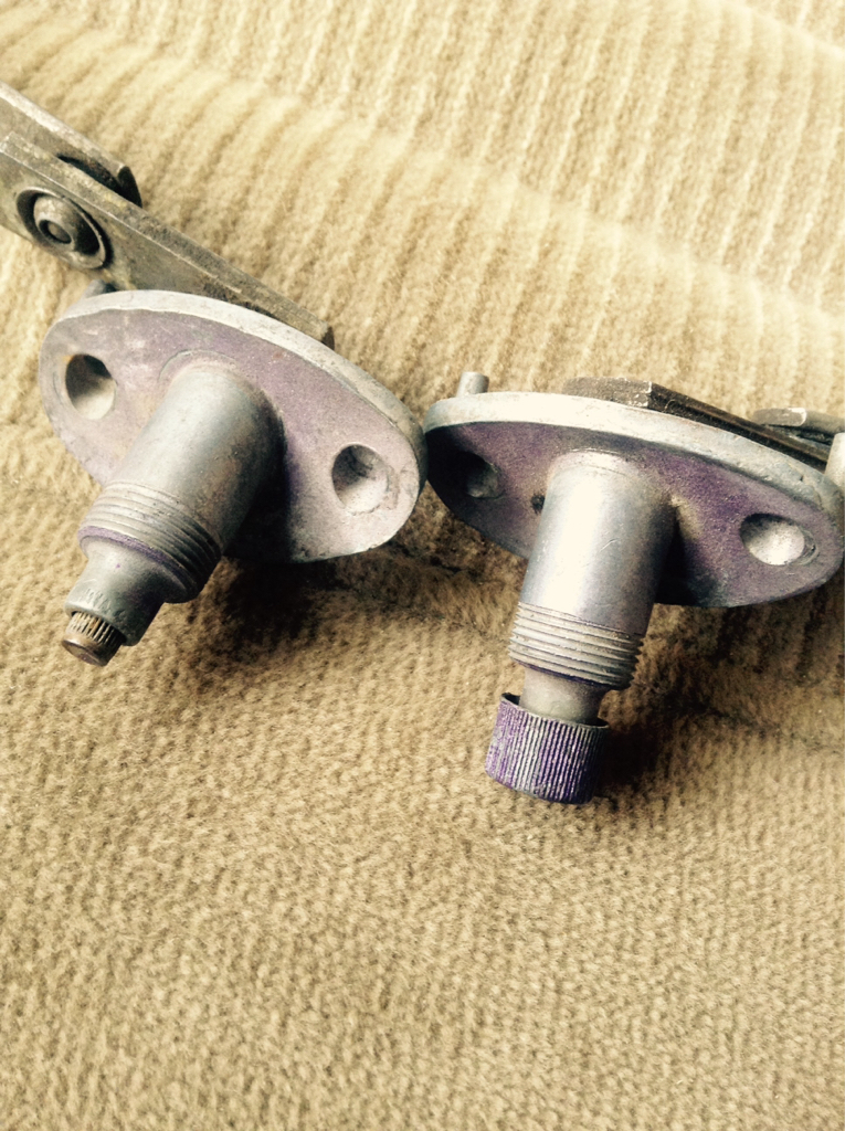

    Any time you have a wiper problem the best advice is to call up the folks at New Port Engineering, the wiper experts. Although their primary business is to sell electric wiper conversions, they have tons of knowledge and might be able to direct you to the parts you're looking for.
  12. v8juice
    Joined: Dec 28, 2013
    Posts: 280
    v8juice
    Thanks for this info. I'll have to call and see what they say. I'm actually considering doing my own electric wiper conversion.
