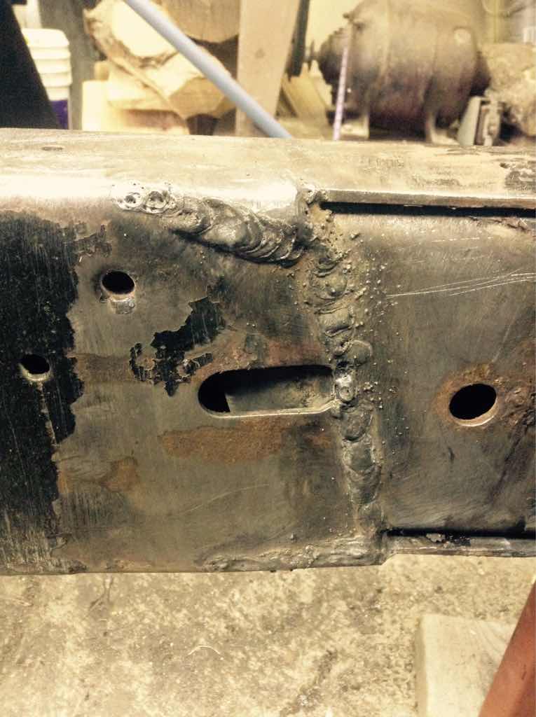

    Thanks for the video on shortening an s10 frame after watching it like a dozen times I made the first cut. ImageUploadedByH.A.M.B.1414342011.365766.jpg

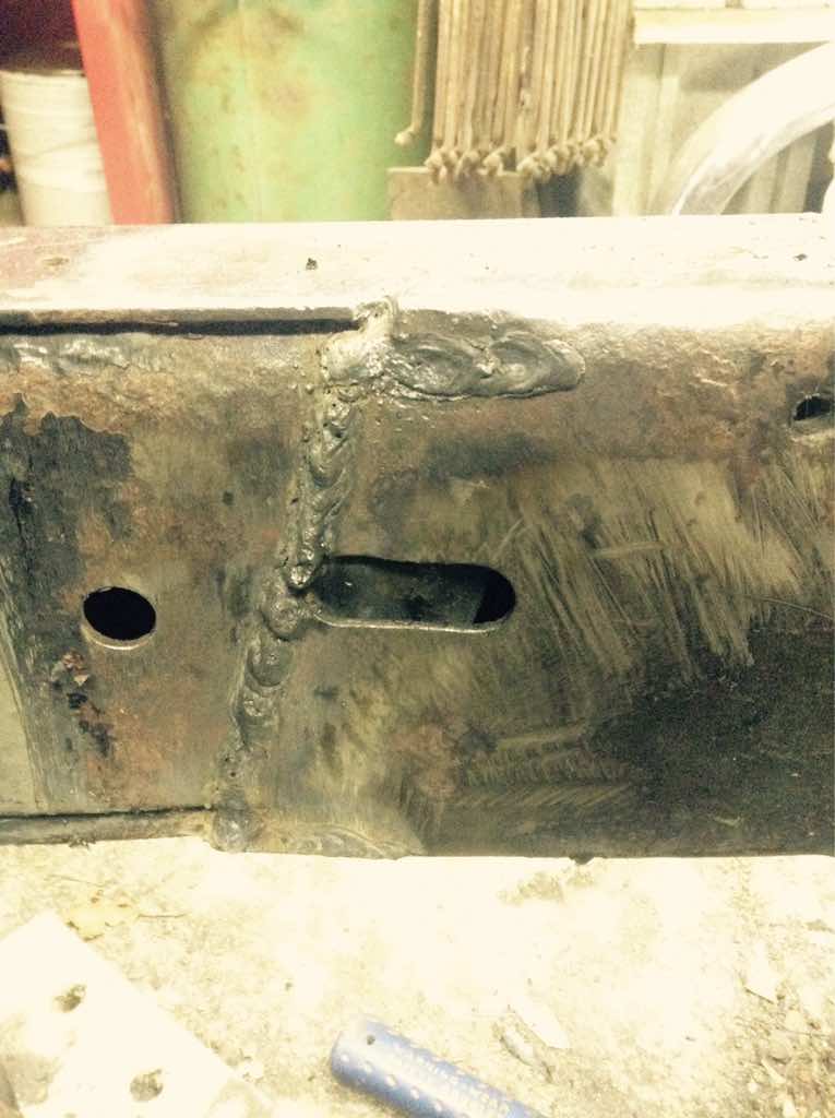

    Now the welding ImageUploadedByH.A.M.B.1414342175.879660.jpg ImageUploadedByH.A.M.B.1414342195.711023.jpg
    I still need to figure out how to fill the gap where the back part of the frame was expanded.
    gas pumper likes this.

    About the gap: Just pie-cut the top and bottom back an inch or so, heat and bend it to close the gap, then weld.
    Carry on, Sam!

    Since I don't have a way to heat the metal I just did the pie cut like missysdad1 suggested then used some clamps and a hammer to bend it. Welding the underside of the frame was the most difficult part. This evening I rolled the frame back under the body and then lowered it down. I guess my next step should be remounting the engine? ImageUploadedByH.A.M.B.1414461437.154918.jpg ImageUploadedByH.A.M.B.1414461462.404483.jpg
