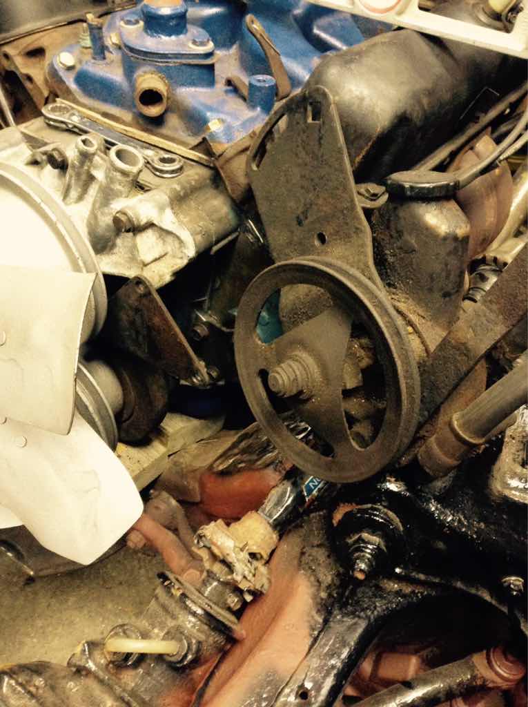

    It looks like I might need to do something different with the power steering pump ImageUploadedByH.A.M.B.1415409856.606719.jpg I don't think I could mount it in the stock position on the motor without putting the engine back where it was before. I might make a mount for the s10 pump or switch to a manual box.

    Use a later style GM PS pump with a remote reservoir. They're REALLY small and will fit in tight confines much easier.

    Hi Sam. Looking good. The engine position looks good and your power steering pump can be repositioned easily. Check your measurements to the radiator core support to be sure you can get the radiator between that and the water pump. You may have room enough to stand the radiator straight as the hood is tall on that car. Now that your frame is shortened and rewelded you can remove the S10 trans cross member and build a new one to fit your trans. You have our numbers if we can help and will give you a call and stop by when in your area.
