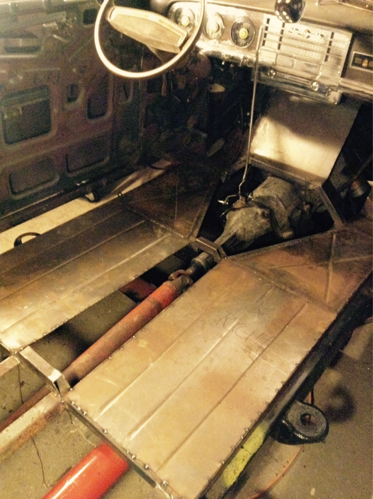

    Thanks to Bob for letting me borrow his bead roller. Here are the floor pans I've made so far. ImageUploadedByH.A.M.B.1426377381.007268.jpg
    hemi v8 and patmanta like this.
  9. missysdad1
    Joined: Dec 9, 2008
    Posts: 3,307
    missysdad1
    Lookin' good! Don't forget to add stiffeners or some other structure to bolt your seat to. The sheet metal by itself isn't strong enough and you'll find your seat rockin' and rollin' beneath you as you drive. Nice work on the bead rolling!
