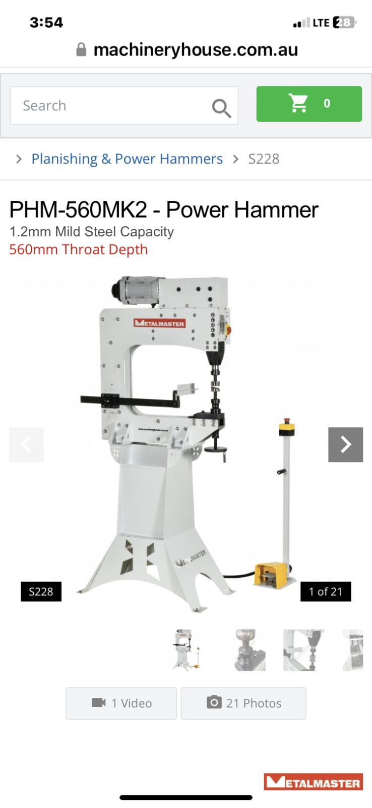

  13. Hey mate, I’ll message you regarding the power hammer. I think we should be able to work something out for yeah!

  18. I talked with my motor expert and my electrician, and 1 more.
    That Aussie motor is 240v 50 htz. Will run fine on 220 60 htz.

  20. My motor guy re did my bachoven meyer nibbler motor. Swedish origin,
    He also said if it burns up, it won’t but if it does we can fix it, rewind it, or repower it.
    Illustrious Hector likes this.

  27. You have 250 v 3 phase in the U.S, yes?. If you have a 250 10A 3phase service, you only need to connect 1 of the phases and neutral to get this thing working. It has a 240v, single phase motor rated at 1.5 HP, so it will draw around 5-6 amps. (it says 240v/10A in the specs, but that is the rating for the single phase service it needs to be connected to. Not to be confused with the actual power rating of the machine.) The 60Hz supply frequency will make it hammer a little faster. I have been converting 115 V , 240 V and 315V 3 phase stuff for many years, there are always solutions if you get stuck.
  28. And if that’s a problem I’ll spin it with a VFD at 50 hz. Or I have to make a decision on what is the best way to make it go after it’s here. Vfd, or rewind or repower. Once I see the shaft size, the mounting style, the HP, the coupler element,,,,
    Outback likes this.
