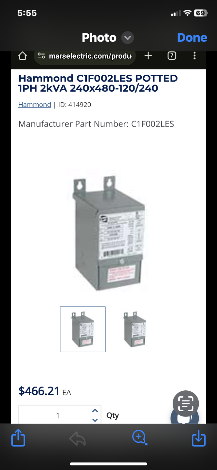

    Could you please provide me a manufacturer and model number of what you’re talking about?
    This is the one we’re going to try,
    Maybe I miss spoke or mis understood the exact function. This one isn’t very large or expensive
  8. What is your measured phase-to-phase voltage? Tool Current draw and/or recommended circuit size?
  9. Also, allowable voltage tolerance? +/- 5%? 10%? I've never seen any equipment that couldn't tolerate at least 5%, most will stand up to 10%. Keep in mind that actual voltage can vary by quite a bit depending on service load as well as local utility grid load.
  10. The provided cord on the thing is dinky at best. Like 16 gauge. The “machine” is tagged 250 volt 5 amps input. That goes into the supplied VFD.
    The motor is also tagged separately and purposefully mounted to obstruct the tag. info isn’t “standard” like what I’m used to seeing obviously. 1.1kw 3 phase 240 +/- 10%
    There’s also some motor tag information for running 380 volt ( Three eighty )
  11. The small cord doesn't surprise me, the euro-spec stuff has always run the wire harder. I helped install some Dutch-sourced gear years ago and we had to change all the supplied cords/wiring out as they were too small to meet current NEC specs. I asked the tech they sent if those cables got warm, his reply was you could warm your hands on them in the winter.
    The reason I ask for your measured at your panel phase-to-phase voltage is the 'nominal' voltage is rarely the same as actual. A '110' volt source could be anywhere from 107 to 117 volts to the neutral. A '120' source could be from 117 to 125 volts. This will obviously affect the high voltage output because of the ratio involved. Virtually all of the 220V to 240V xfmrs I've looked at have a 1.09% ratio (or .92% if going the other way), so with a '110V' line-to-ground of 115V, that puts your phase-to-phase voltage at 230, not 220. Multiply that by 1.09 and that gets you 250.7V. All this ***umes you have a single-phase service or a Delta-connected three-phase. If you have Star-connected three phase (120/208V nominal) or particularly low phase to ground voltage on a single-phase service, a different xfmr will be needed.
    ***uming a 5% +/- voltage tolerance and 220V minimum between phases, the machine should run on voltage anywhere from 237V to 262V. You may not even need a xfmr. If you do, this one or a similar unit should fill the bill...
    1-Phase Buck/Boost Step-Down Transformer - 240V Primary - 220V Secondary - 22.94 Amps - 50/60Hz: Amazon.com: Industrial & Scientific
    Less money, more capacity (5 KVA). Use a 15 or 20A two-pole breaker to feed it. I'd recommend using stranded wire, the terminals in those offshore VFDs run small and don't like solid wire.
