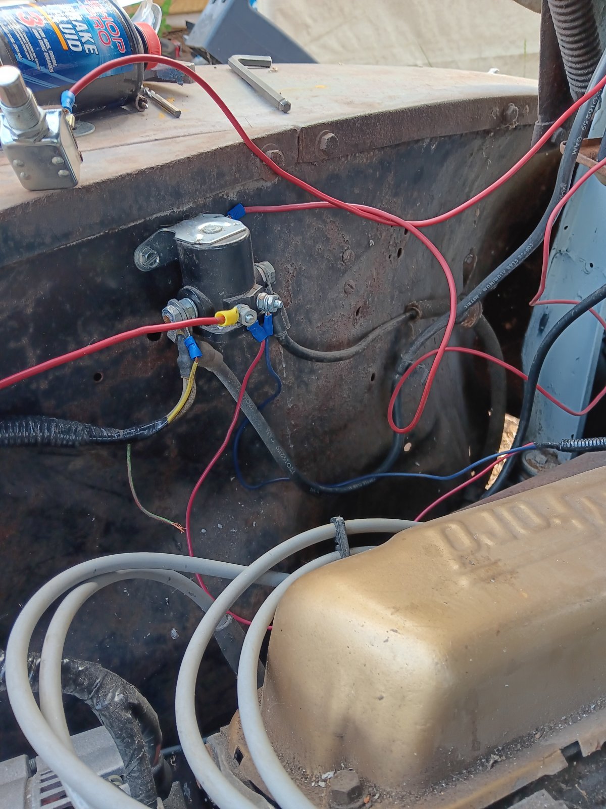

    What did i miss. So I got my 351w wired with a momentary switch to get it running. I push the ****on and it fires up then I let go of the switch then it immediately dies.
    If I hold the ****on down it'll keep ruining but wouldn't that keep the starter tuning?
    Any ideas???

    we can't see how you wired it, so it's hard to say. We can make a few guesses, but then it's a guessing game.
    draw a schematic or take some pictures or describe what is connected to what.
    sounds like there's no connection from the battery to the coil positive terminal...which is what an ignition switch does when you turn it to "run" position

    The blue wire goes to the + on the coil and the red wire goes to the duraspark box

    The blue wire to the coil is connected to the I terminal on the relay, which is only energized while the engine is cranking. You also need a wire from the battery positive (through a ballast resistor) to the coil positive terminal, to make it keep running.
    thanks for the picture!

    I think I get it now. The I terminal is to get it started and I need itt wired from the battery to a ballast to the coil.
    But hey I got it to start with not much effort so I count that as a win
