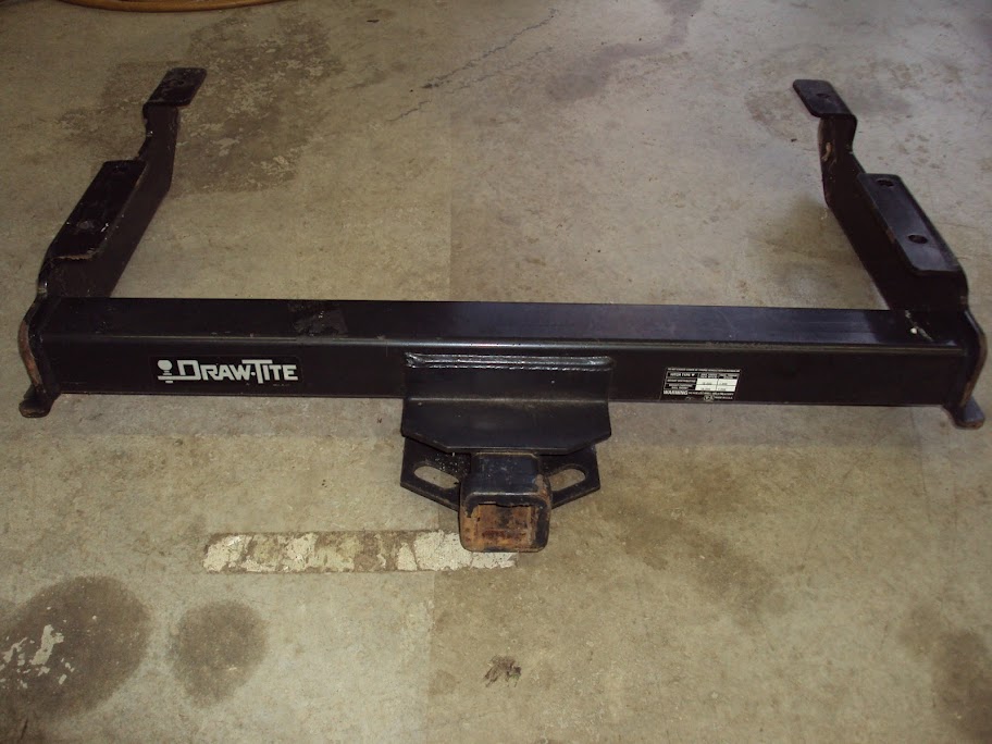

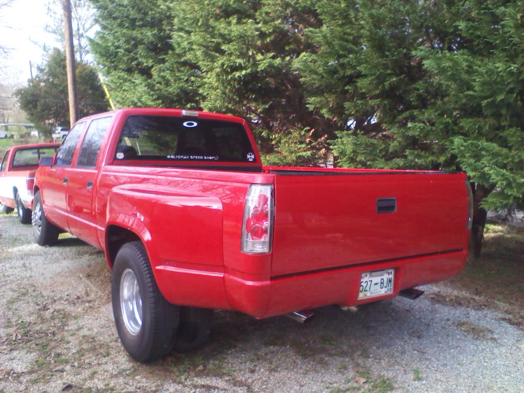

    I've been fitting up a flip down tag to hide a receiver hitch. I had a dually fixed like that. Worked great, and hid all the hitch when you weren't using it. Not so much the full roll pan, just the hidden hitch.
    What do you think?

    Did you get a hitch set-up yet? I am doing the same with my 57' so I can pull an old travel trailer. I have been playing around with what hitch I can modify to work it all out. I agree the 57 doesn't need a roll pan and looks good with no rear bumper.

    I have one that I'm going to fit in there. It's gonna be upside down from it's original configuration, and MAJOR overkill, but with a little bit of original rear roll pan magic.... You'll never know it's there. ;)

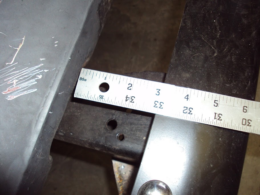

    Here's the gap between the '59-66 bumper to the lower grill opening. If you shortened your brackets 3 1/2", you will have to re-group. Looks like 2 1/2" would be the right number here.
    I'm thinking maybe some kind of nerf bar... ?

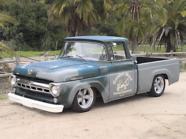

    Like it a lot but I may be prejudice. Tucking thefront bumper in really improves the front looks to me. Here is a pic that was my reason for building one.

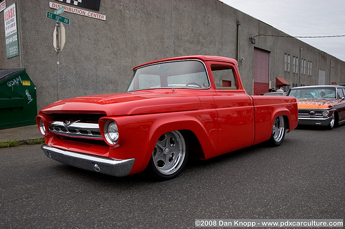

    Yeah, the green truck is really cool, and one of my favorites. Not so sure about his red one... :confused:

    Here's the red one mentioned above..... Not a Hamb truck, but there are some aspects of it that might appeal to us. ;)
