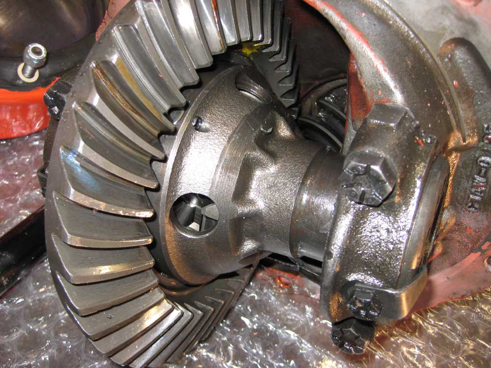

    Looks like you have 31 spline axles. That rearend probably didn't come in that truck. It might even be a Trak Lok that someone would want. I'd just put it on the shelf though and use the Locker.

  9. I talked with a friend this weekend who told me I may have jumped the gun a little with my comment about the 2 hole in the axle flange, sounds like that is a true statement when talking 62 & up. He said he didnt think early trucks had anything but 28 spline axles. Maybe someone has swapped it out. Is it a 5 on 5 bolt pattern? My friend is CASTEEL on the HAMB, he has a 58 F100 and you have talked with him previously about yall's Sports (Buisness) Coupes, he has a 31 Sports Coupe. Sorry if I gave your wrong info.

    Alright, mystery solved. It's a 31 spline rearend with a Trac Lok. Obviously didn't come stock in there....
    Like suggested, going on the shelf. :D
  11. I see from the casting numbers on the case C7AW that is a case from a 1967 vehicle. You scored twice, once with the strange unit and again with this one. COOL !!

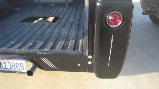

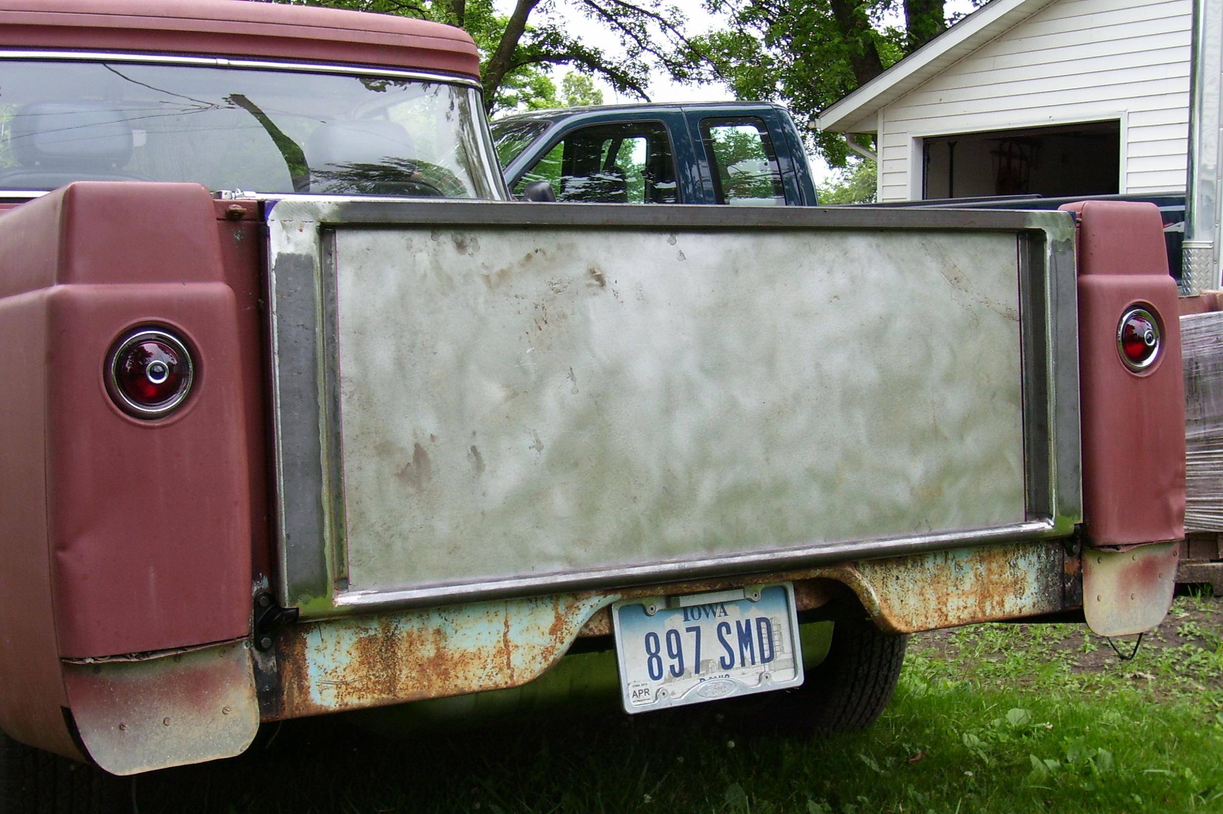

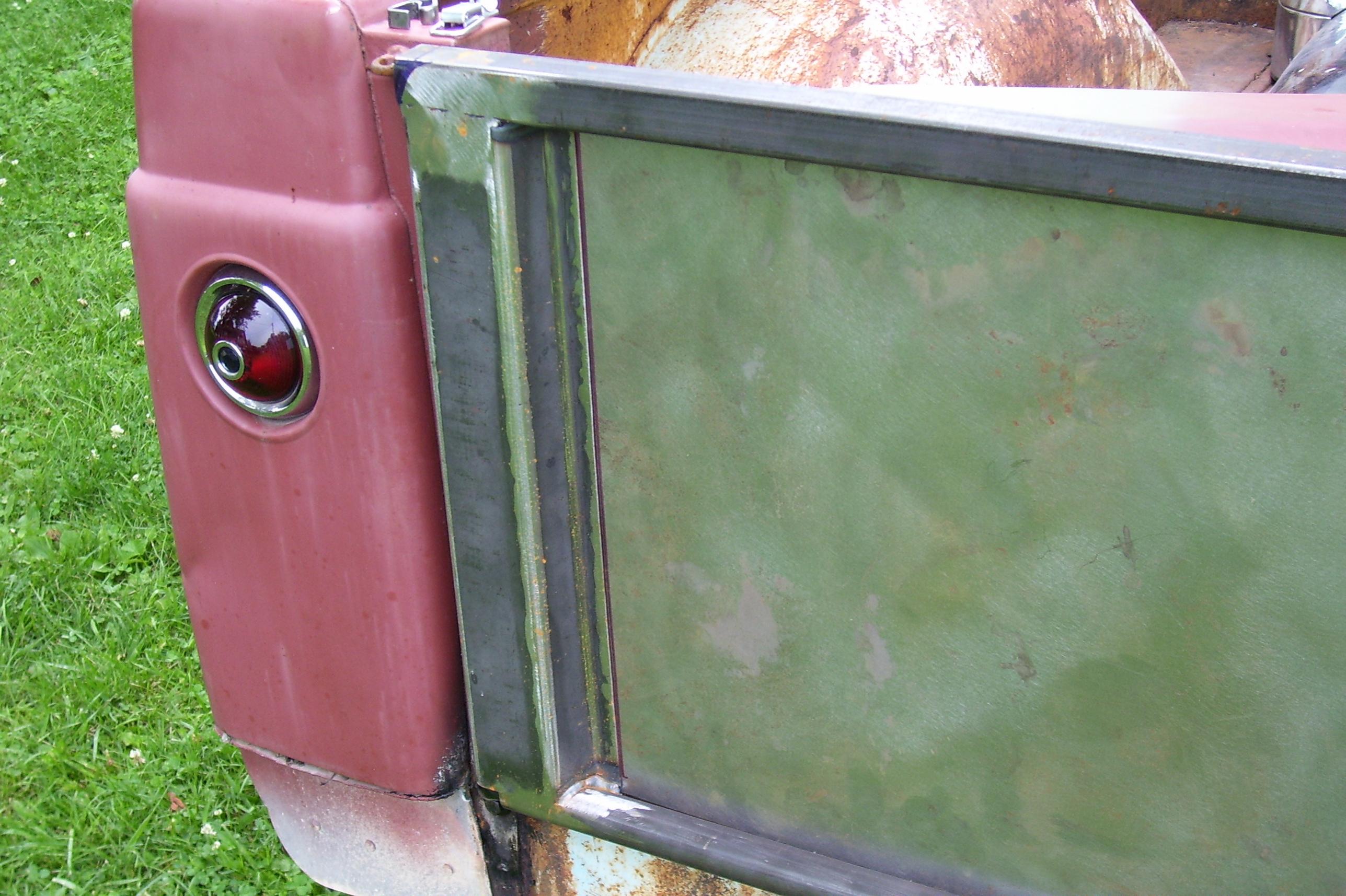

    Here are a couple pics of pontiac tail lights. Need to open up the holes in the backing plate on the bed. These are attached with all thread through to the inside bed panel, then capped with the nut of your choice. They look cool !!

    I used the Pontiac lights on mine. I just opened up 2 holes in the inner box side to get a socket thru with the nut inside it. Leaves 2 small holes in the back panel of the inside of the box. Worked fine.
    SPark

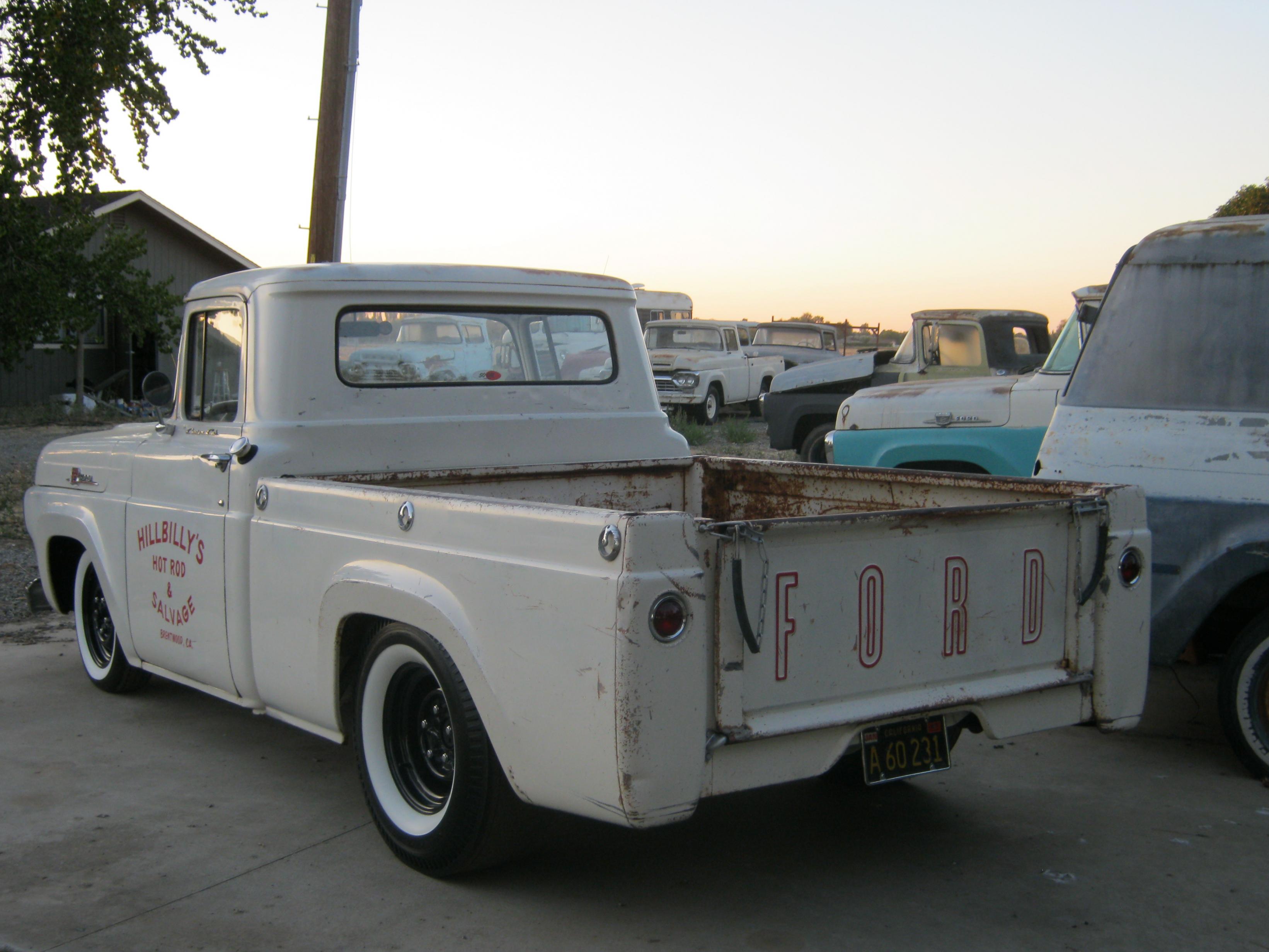

    I love the white walls on the truck on the far right. Can you tell me the brand name and where you found them? Thanks.
