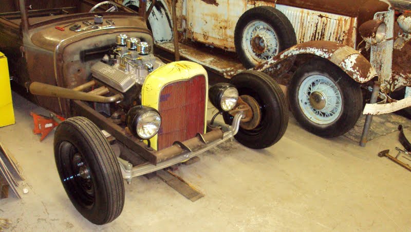

    My sedan has been sitting without any progress since march. Finally got tired of it. Worked on welding up all the brackets and crossmembers tonight. Here's some pics of all that. Rich (kwiksilver) started this car, so credit him with the first few pics...
    Here's a question for the m***es... Is the front frame section too long on this car? It's 48" from the cowl to the centerline of the front axle. I'm thinking about getting it a little closer to '31-'32 wheelbase. What do you think? Don't hold back....

    Car looks good, but I'm with you on the front end. Would look better if it was a little shorter. What are you gonna do to fix it?

    Stock '31 wheelbase? What do you think?

    I know progress this soon will shock anybody that knows me... But here it goes.
    The wheelbase from the firewall foreward was WAY to long for me. So I've measured and thought about it long enough. Here's what I came up with.
    Went to the back yard, scabbed an A model front cross member. Moved the front axle back 7". Just so it right in front of the grill shell. Moved the spring back behind the radiator (10") so it works with the A model crossmember.
    Here's the pics of the progress. Let me know what you think.

    Damn thats a huge difference. Looks alot better. I wasnt sure about it. I thought it looked good before. Good job Kevin.
    Keep us posted with progress.
  10. I like the new wheelbase too, big improvement.I look forward to following the build, keep us posted.

  12. Yep looks better shorter. Good start!

    The shorter wheelbase has much better proportions.
