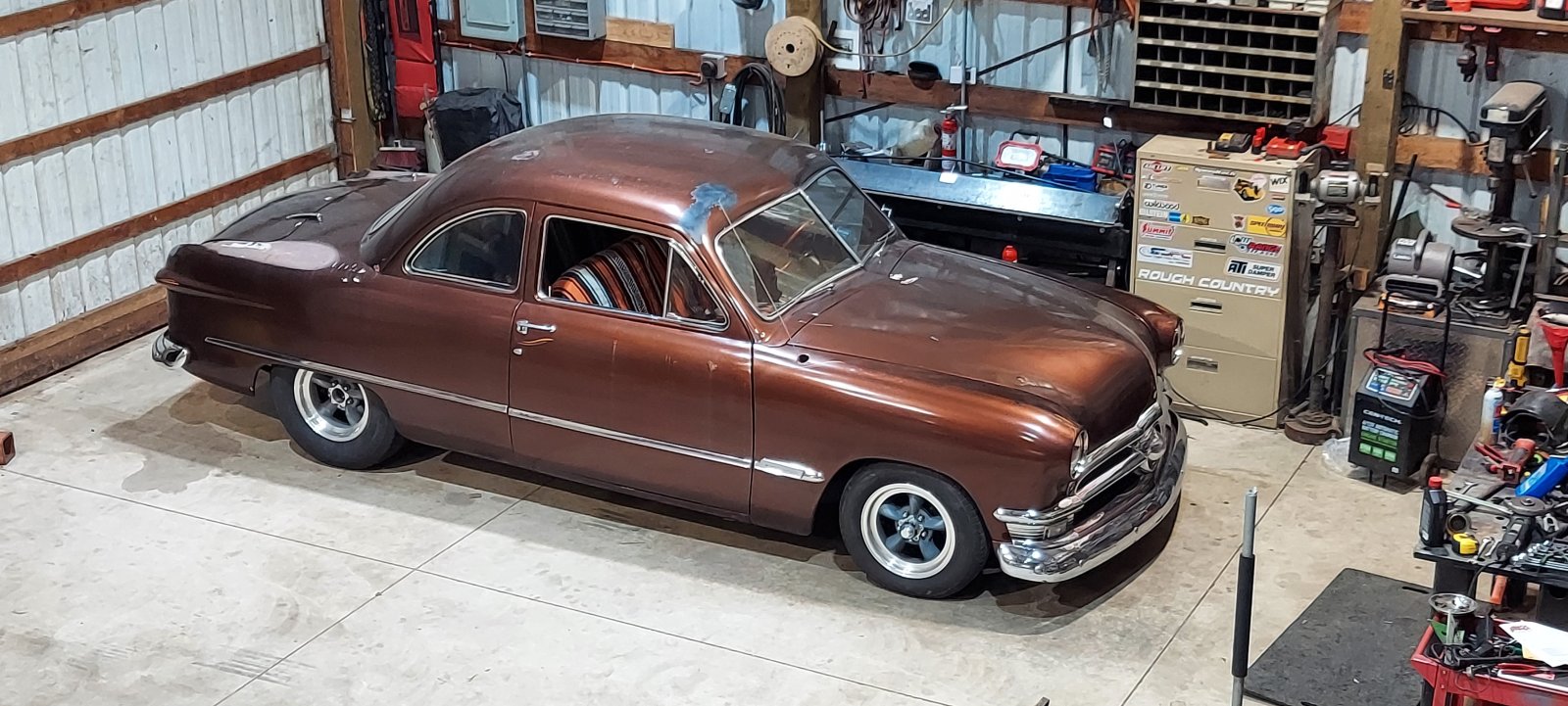

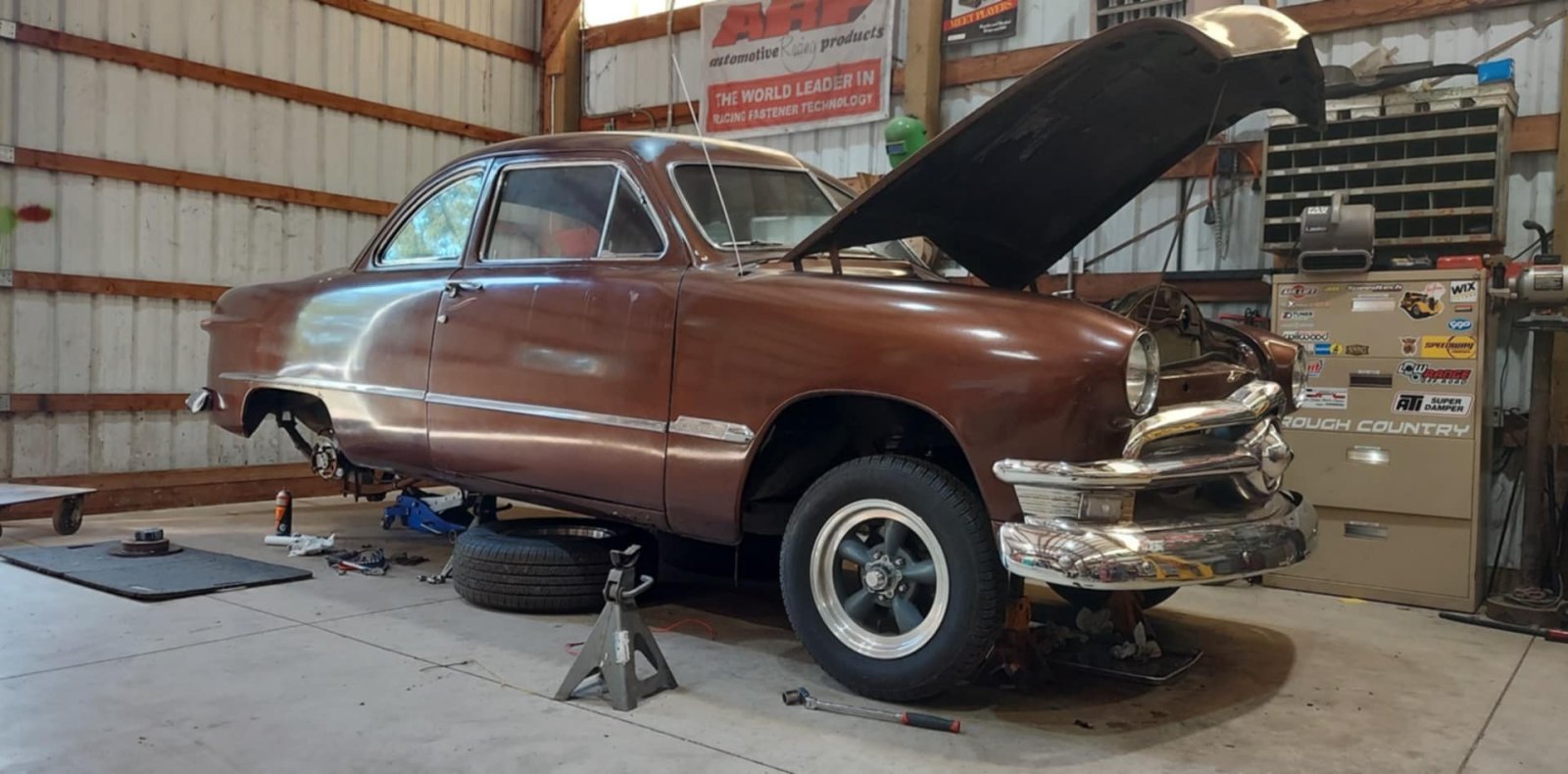

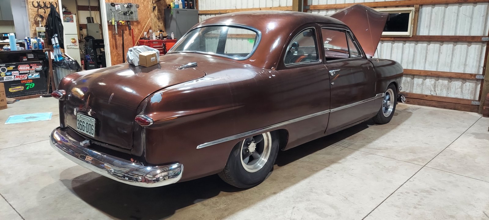

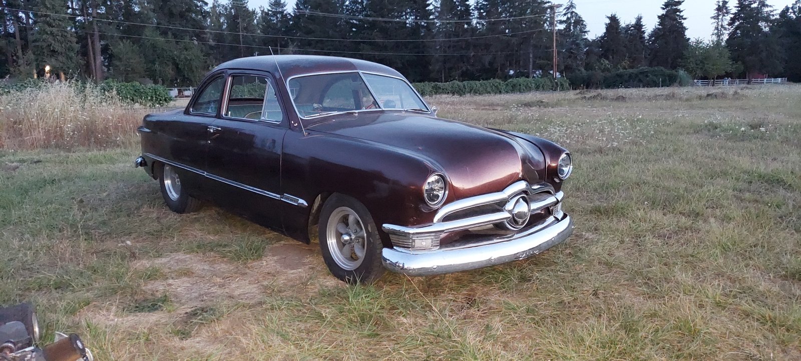

    Getting to be car poor these days. Couple months ago we traded my wife's OT Jeep for a 50 Ford Sedan project kinda g***er style. Was a good trade but the more I dug into it the worse it got and you could see truly how hacked it was. The decision was made to sell it, which I ended up selling it to a great home..more on that one later.
    So a friend of mine had this 50 Coupe up for sale and offered it to me for a really low price so we jumped. The car was brought up to Oregon from California by another friend.
    Details on the car: 330hp 351 Windsor, c4 w/firm shift kit, 4 wheel disc brakes, pacer front clip with power rack, hydroboost brake set up, ford 9 inch with 3:73 gear. The car was neglected the past couple years so I'm doing my best to bring it back to what it was..this car is QUICK! The paint is a little crusty and so is the interior..anyways here's some pics of the wife's new ride!

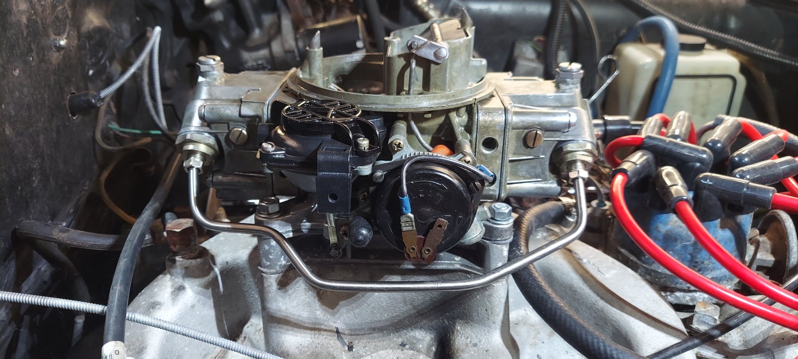

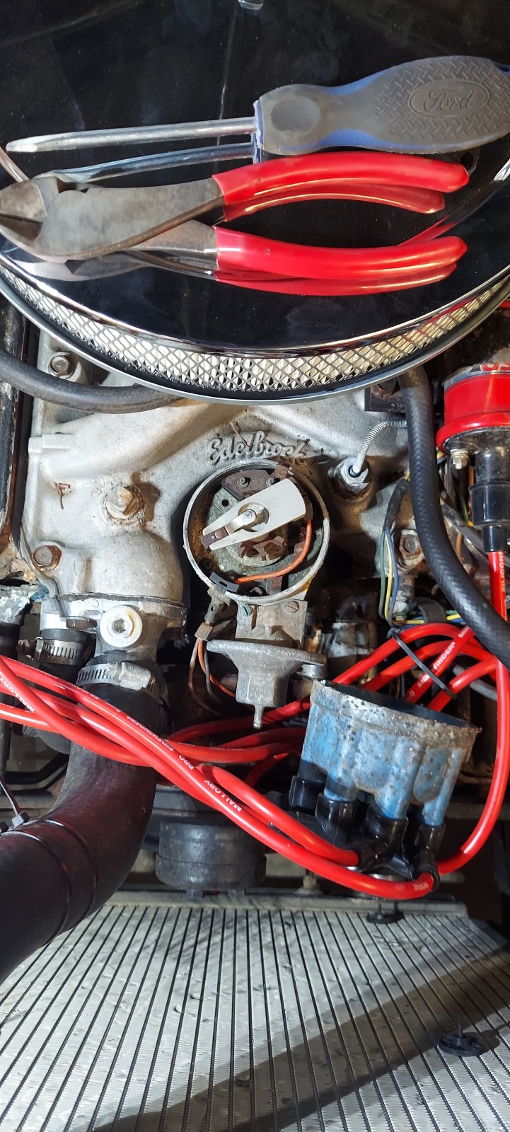

    The mechanical fuel pump had failed and a HF electric pump was put on by previous owner, he also put a ****py edelbrock on it..I barely made it home.
    I had a 650 Holley rebuilt for it with the ford number for a boss 351. Now battling the ford duraspark box that's failing, I pulled the distributor tonight to have a friend run it and we are going to install a msd box. I've used to brand new fuel pumps now, one failed after 30 min of run time, the second seems to be better.

    Rake looks good - sitting right.
    Buff the current paint and call it a day.
    Crusties are fine.
    Typical bugs to work through.
    Distributor cap looks old, plastic looks dried out - may have a micro carbon track,
    go buy a new one, inexpensive upgrade.

  7. Sounds like you have a good deal going there. On the Duraspark, I replaced mine with a 4 pin HEI module.

    I rather like the looks of it. Pacer front ends are usually way too wide for most early Fords though and hard as hell to find parts for.
    If you haven't done so already put a good inline filter between the tank and the fuel pump because the pump ****ping out quick may be due to crud from the tank messing with the valves in the pump. I've had that happen too much with old rigs that sat a lot.

    Distributor is back in with new cap n rotor.
    Msd box is in, need to buy some more wire tomorrow for the power lead.

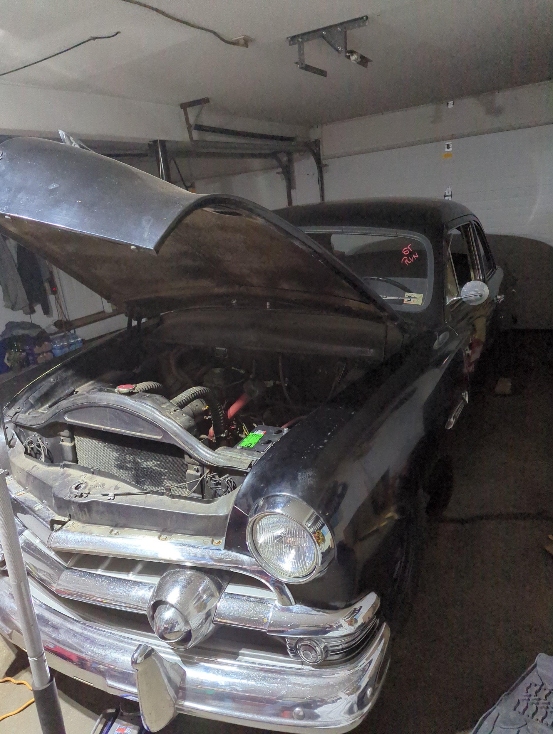

    And on side note, the guy who's wife bought the blue 50 and surprised him got to see it today and he's in love with it! Already had the kids riding around in it, grinning ear to ear.

    I removed the bad mechanical fuel pump, put a block off plate on then installed a Carter style electric fuel pump in the rear. I just got it hooked up last night and the car runs again.

    Your mechanical pump may have been fine, the arm may not be correct for your application , found this myself a few years back. When building my y block I came across several thing that should work but did not, fuel pump was one, at a glance the new one looks the same but after trying to run it, careful measurement shows the arm only getting half the stroke, tested it out of the vehicle and it pumped just fine, sent it back, then tested the old one which worked, put it in and 5 years on it’s still working

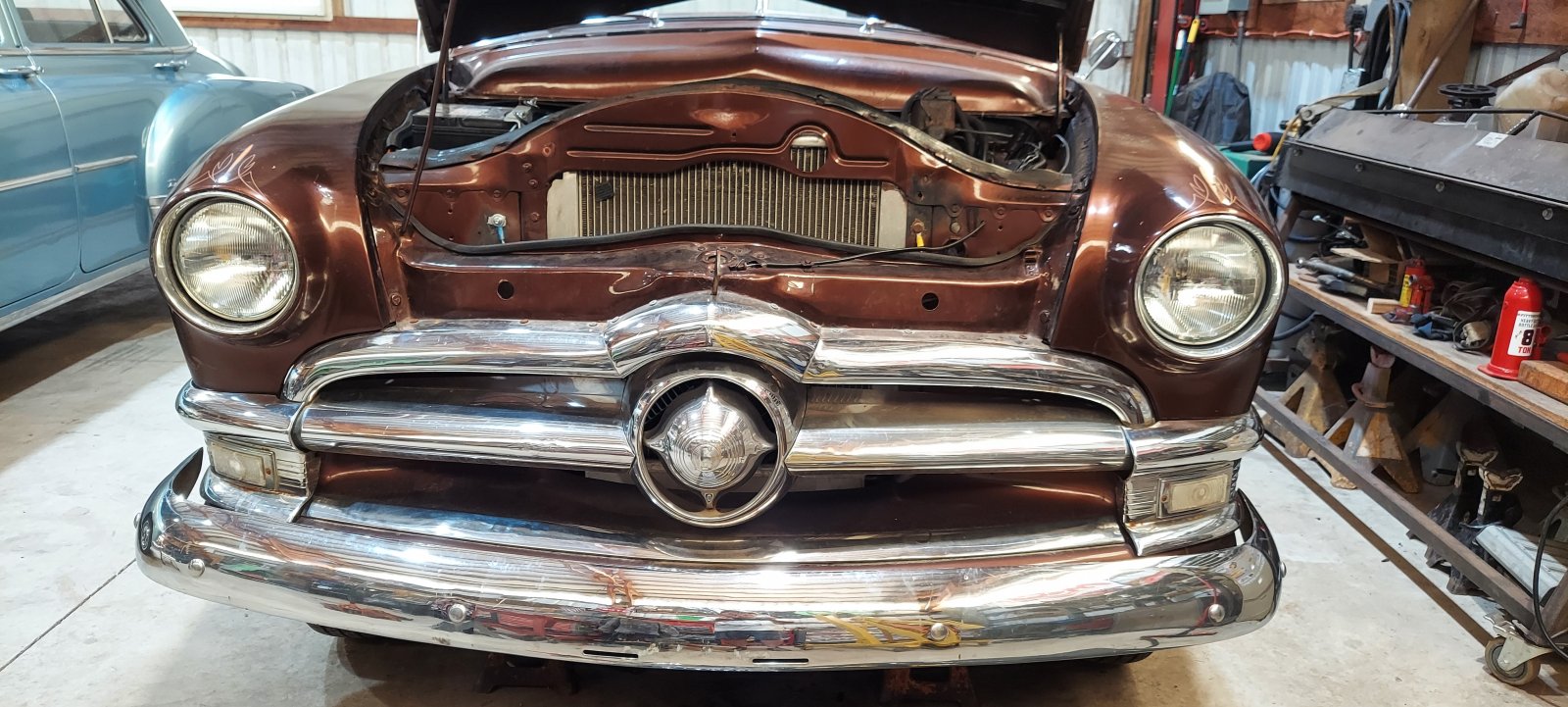

    Ugly *** headlights are gone!

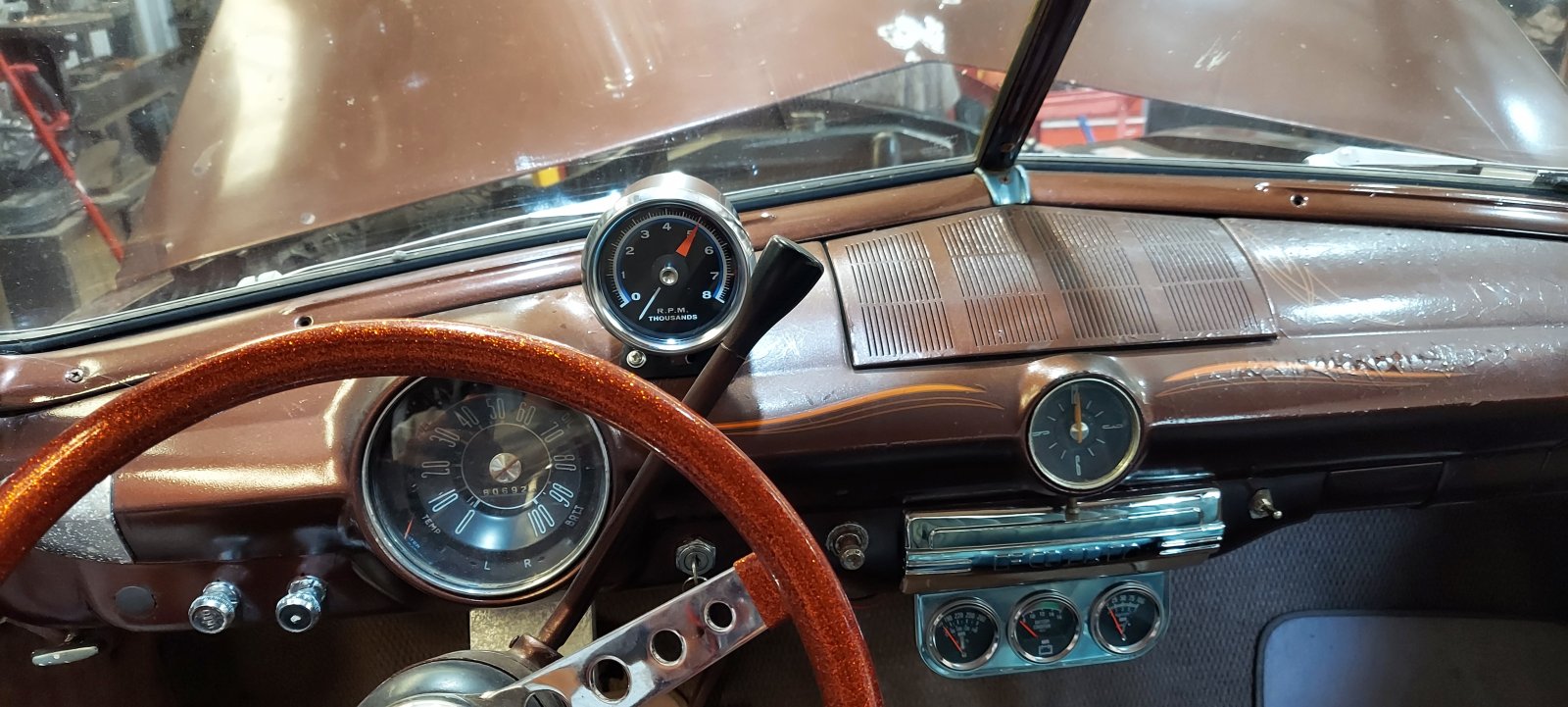

    And lastly I installed a new tach I had sitting here.

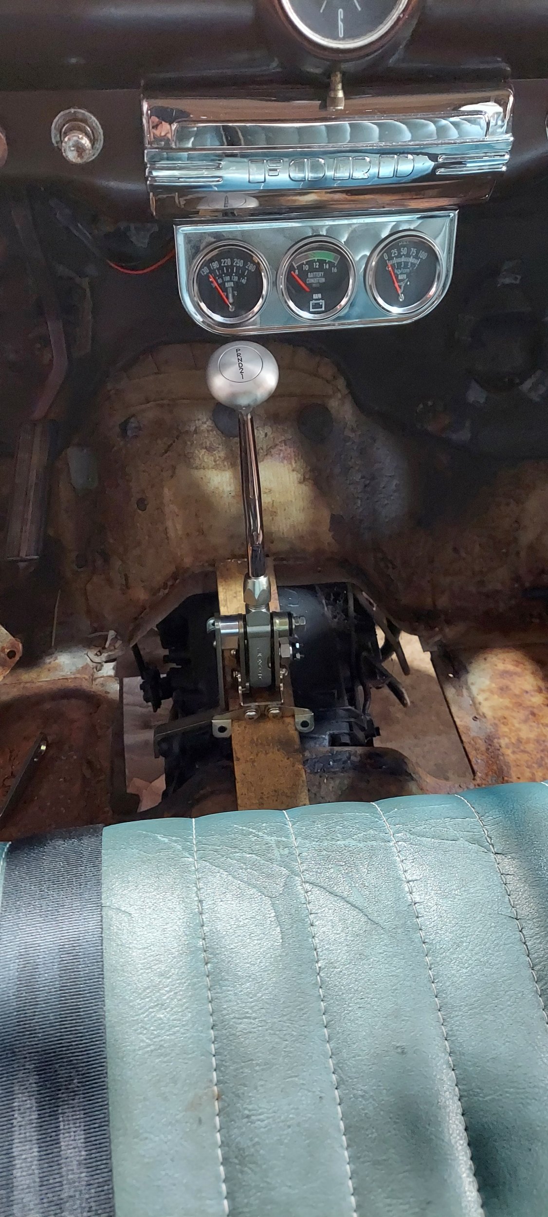

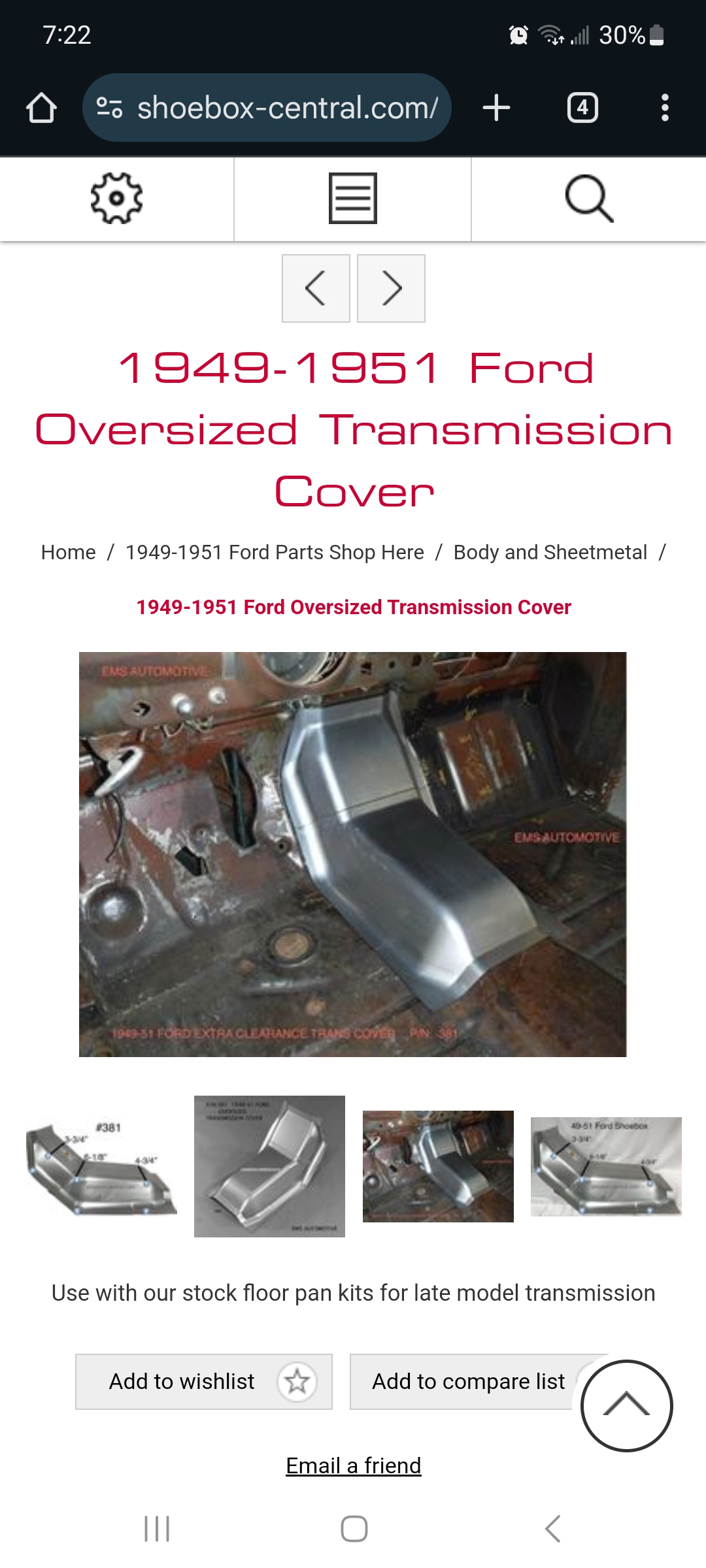

    I bought a Lokar shifter brand new from a friend yesterday, it's a floor mount cable style..I thought piece of cake and that'll solve the issues I have with the column shift...ha
    Now I need a taller trans tunnel because there isn't enough room for the shifter.
