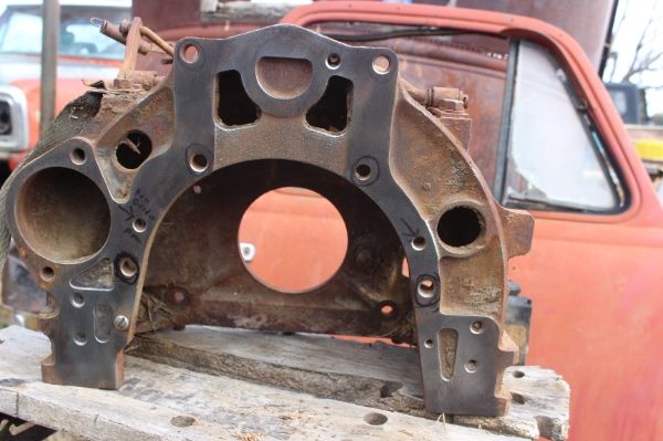

    The big issue is going to be the motor mounts on the bellhousing, you may have to get creative there. It may be simpler to use a 48/53 Chevy truck bellhousing rather than the 55 bellhousing as it works with the 139 tooth ring gear on the 50 Car flywheel and lets you keep your stock starter. Or use the 55 flywheel with the early engine.

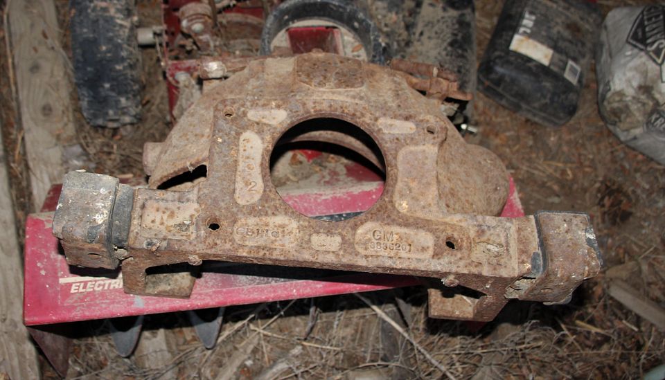

    Your 55 bellhousing does have a front side similar to this one? This bolts to the back of a 216/235 or 261
    This is the backside of that same 51 Truck bellhousing (47/53) in the other photo. From some quick reading on another Hamb thread you have to do some t******* on it to work in a car.

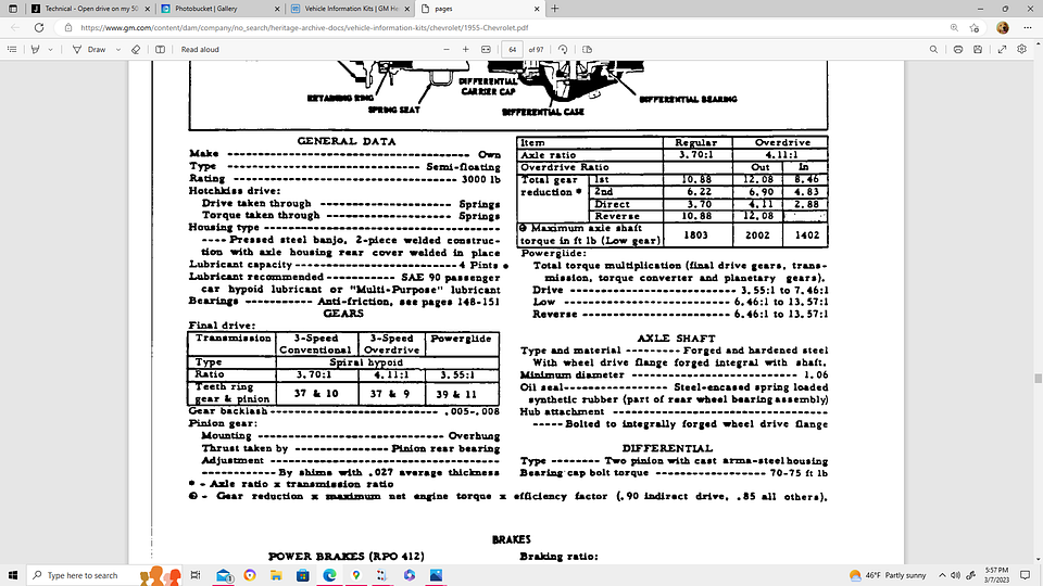

    According to the GM Heritage site a 55 3 speed standard has 3.7 Gears an over drive has 4.11 and the powerglide has a 3.55. That was standard issue when they left the factory. From the GM heritage archives 55 chevy car pfd pages (gm.com)

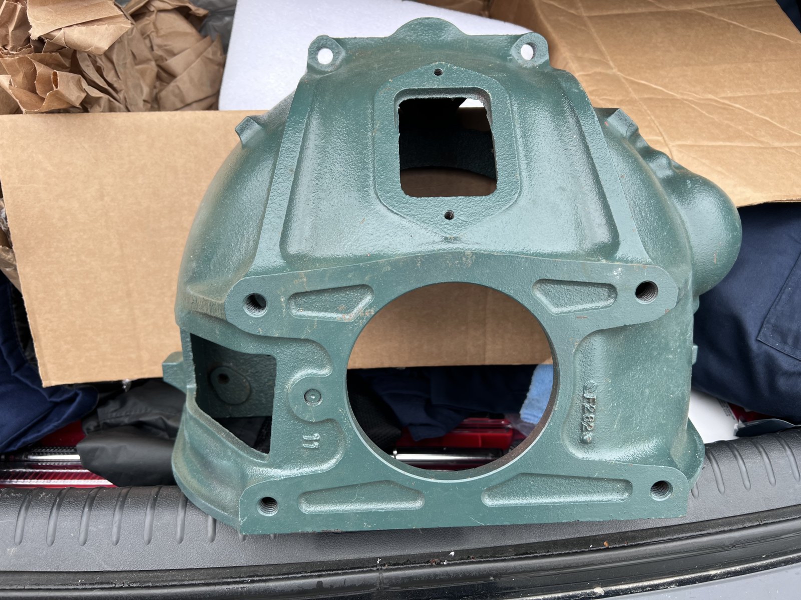

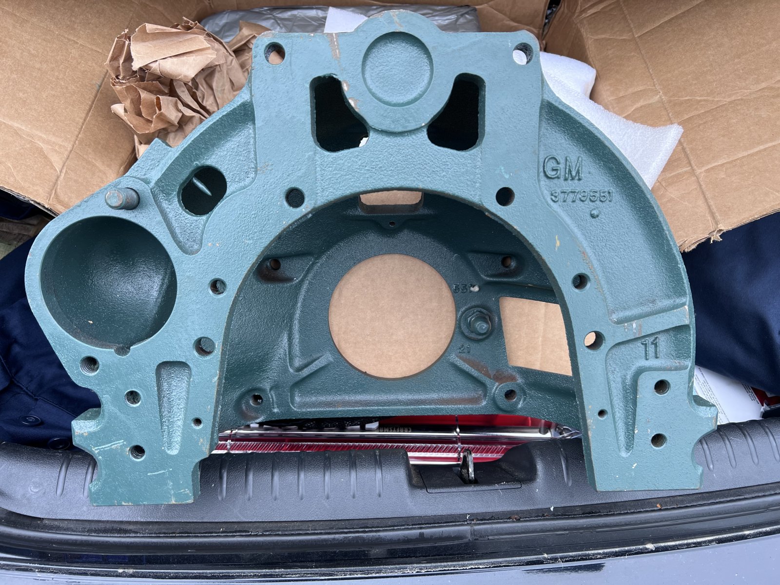

    This is the bell housing I’m going to be using, it’s from a 62 impala. Will this work? D05C1B47-AF5A-4121-93A8-D17E6966E7B1.jpeg
