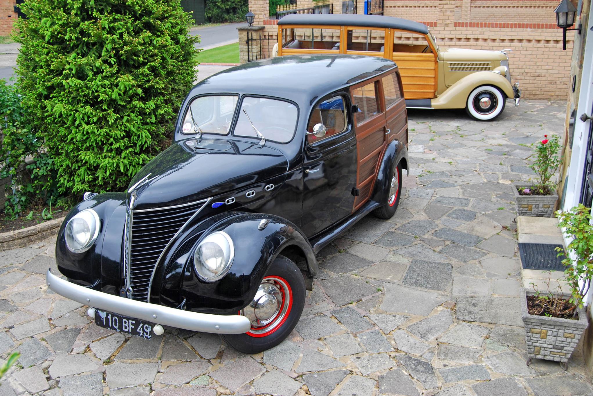

    Hi Guys and Gals,
    I'll apologise up front for asking the same question that I posted about 4-5 months back as I lost the thread (spme might say I lost the plot!!!)
    So, to start afresh I'm planning to put a modern engine and trans in my French-built Matford Ford woodie, which is based on the late 1930s Model 60 car.
    I've lined up a local chassis engineering specialist here in the UK but am looking for suggestions for adapting the rear suspension after I discard the torque tube. I didn't really want to fit radius rods as the car is pretty light and the four cyilnder motor will be 100hp so I wont be smoking the tyres...
    I'd appreciate any suggestions and especially any photos that can steer me in the right direction.
    Colin
