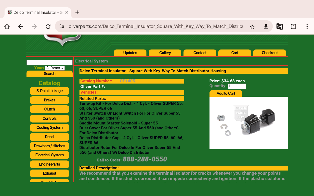

  25. 2OLD2FAST
    Joined: Feb 3, 2010
    Posts: 6,063
    2OLD2FAST
    from illinois
    Kinda doubt that ...
    bschwoeble, Blues4U and firstinsteele like this.
  26. 2OLD2FAST
    Joined: Feb 3, 2010
    Posts: 6,063
    2OLD2FAST
    from illinois
    I think this it what they're referring to ... Screenshot_20250324-020248.png
    tractorguy and firstinsteele like this.

  28. squirrel
    Joined: Sep 23, 2004
    Posts: 60,271
    squirrel
    That's the part on a Chevy 235...the Mopar version might be something else, I was trying to get him to show us where the part goes on his distributor. It's confusing.
    Basically it's just an insulated terminal block, to get the points wire out of the distributor.
