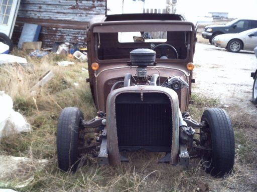

    Okay need your help and advise here.
    as of now i don't own a radiator for my RPU project yet.
    I'm running what i believe is a '46-'47 59AB flathead motor.
    The grille shell i'm running is a '32 truck grille which will be cut about 2 inches small to fit the cowl height of the 1927 Model T body.
    My question is... what year radiator do i run with this set up? suggestions?
    hence, i don't wanna use a brand new aluminum one either ( even though they cool better) for the look i'm going for as i'm not running a hood and will be very visable.
    The radiator needs to fit the grill shell which will be chopped about two inches, plus it has to have the water pump outlet's, two on the top and two on the bottom.
    Ideas or any leads on where to find a proper one?
    thank you and best wishes,
    cab

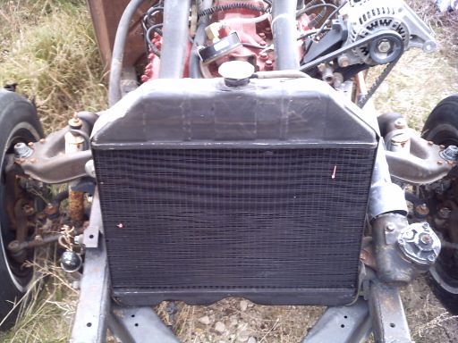

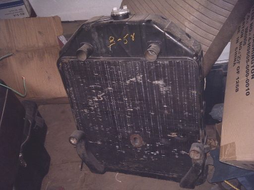

  5. 31ACoupe
    Joined: Nov 14, 2005
    Posts: 1,416
    31ACoupe
    It looks like you are going to need to mock it up and do some measuring, not much room for the motor and the radiator per your picture. I had to cut my radiator a bunch and it cost a bunch to make it fit. Might want to check out the COE flatty radiator from early ford trucks, it has the bottom hose outlets raised up the radiator about 8" which would allow you to fit the radiator down lower in the frame. I have one and can maybe get a few pics if you want.
    george

  9. 31ACoupe
    Posts: 1,416
    31ACoupe
    cab....here are a few pics. my coe radiator with the raised bottom outlets and the 50 F1 radiator I had chopped down.
    george
