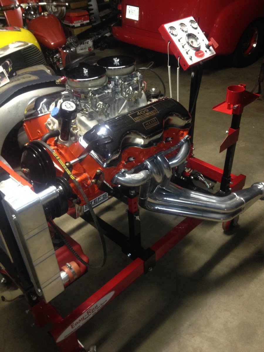

    looks heavy duty
  2. Over build it and you never have to rebuild it.

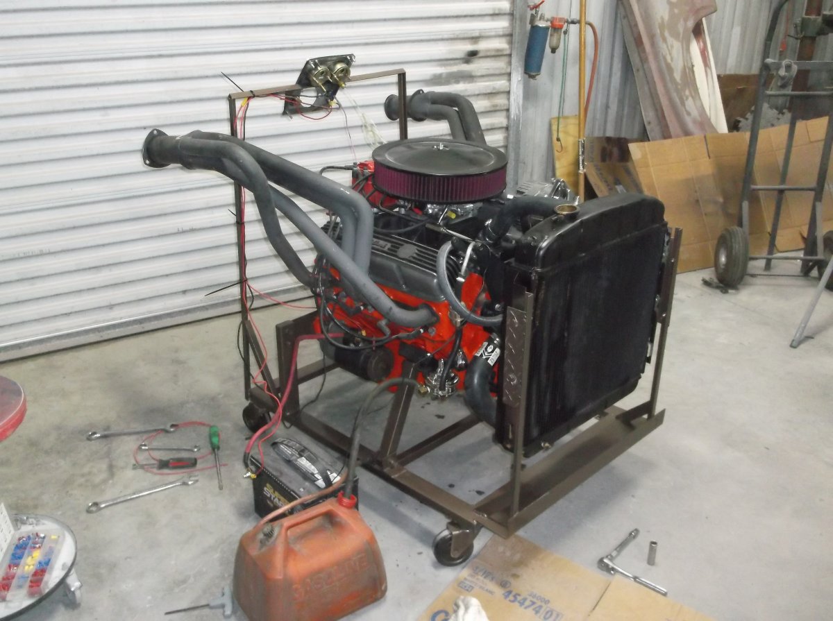

    2 hours and the s****s out of my metal barrel made my test stand. DSCF3392.JPG
