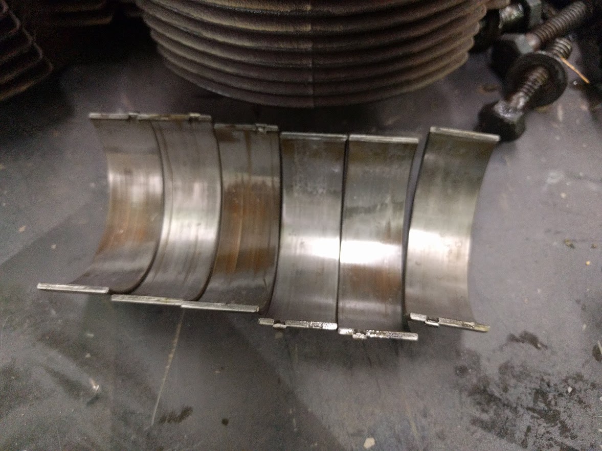

    But if you're the courageous type, we'll all tell you our stories about driving a car with a little bit of a rod knock on road trips for thousands of miles, and made it home OK. Here's my Corvair rod bearing pictures. 5000 miles to California, up the coast to Seattle, back down to Monterey, then up to Utah for the eclipse, and back home. No problem with the little knock at light throttle at speed.

    ^^^^^ both 56’s have a couple of bearings like the one on the far left. Nothing has left from within for years.
