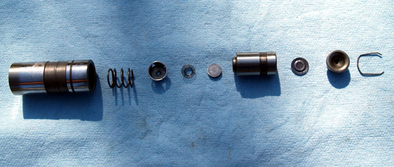

    If they are hydraulic, you can pull them, one-at-a-time, dis***emble them and clean them out.
    As long as you put them back together properly, and back exactly where they came from, it will be fine.
    That will only cost time, gaskets, and fluids.
    This is a common hydraulic lifter. No voodoo magic in there:
    And yeah, the timing set could have an issue. Those aren't much coin.
