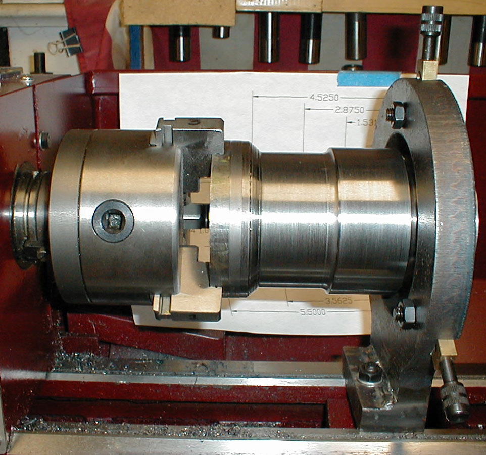

    I know what you are saying. But, there is no way I can hand torch like this:
    I only made the one steady rest.
    http://www.accuratepower.com/Rest/

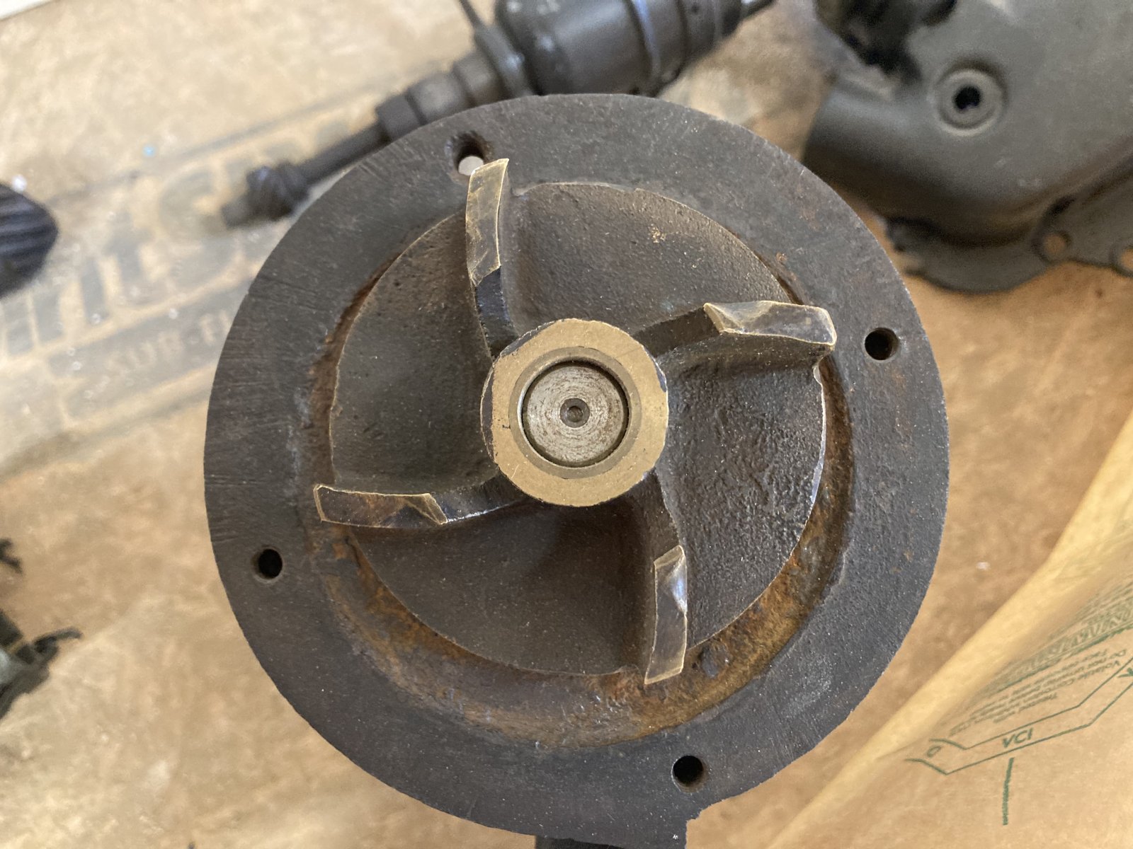

    Look into a “Vectorizing” app for your phone. It will cost you a few bucks but will allow you to convert a high contrast pic into a .DXF file. I downloaded “Vector Converter” recently for $10 with no subscription. Here is a water pump impeller that I happen to have a pic of, and the steps to turn it into something useful. I’m not suggesting that anyone needs to buy CAD/CAM software, but rather letting you know it is possible for the vectorized photo to be used by anybody with a CNC plasma table
    original pic;

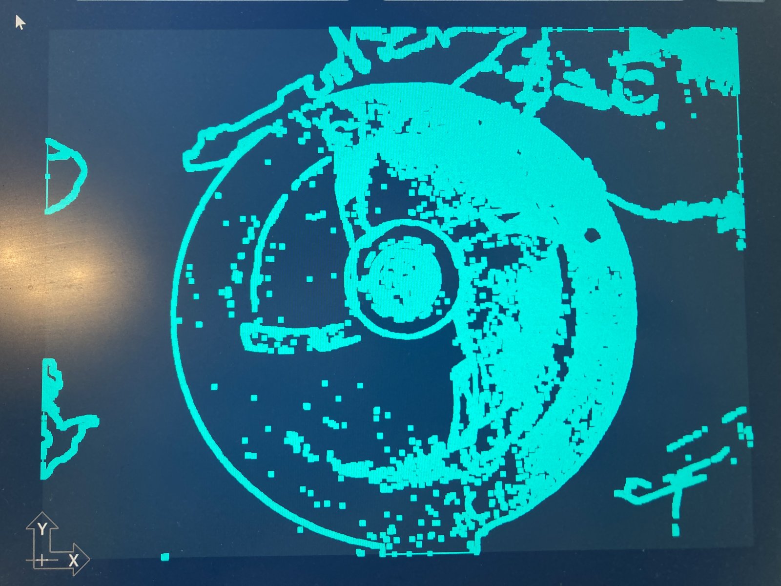

    Vectorized;

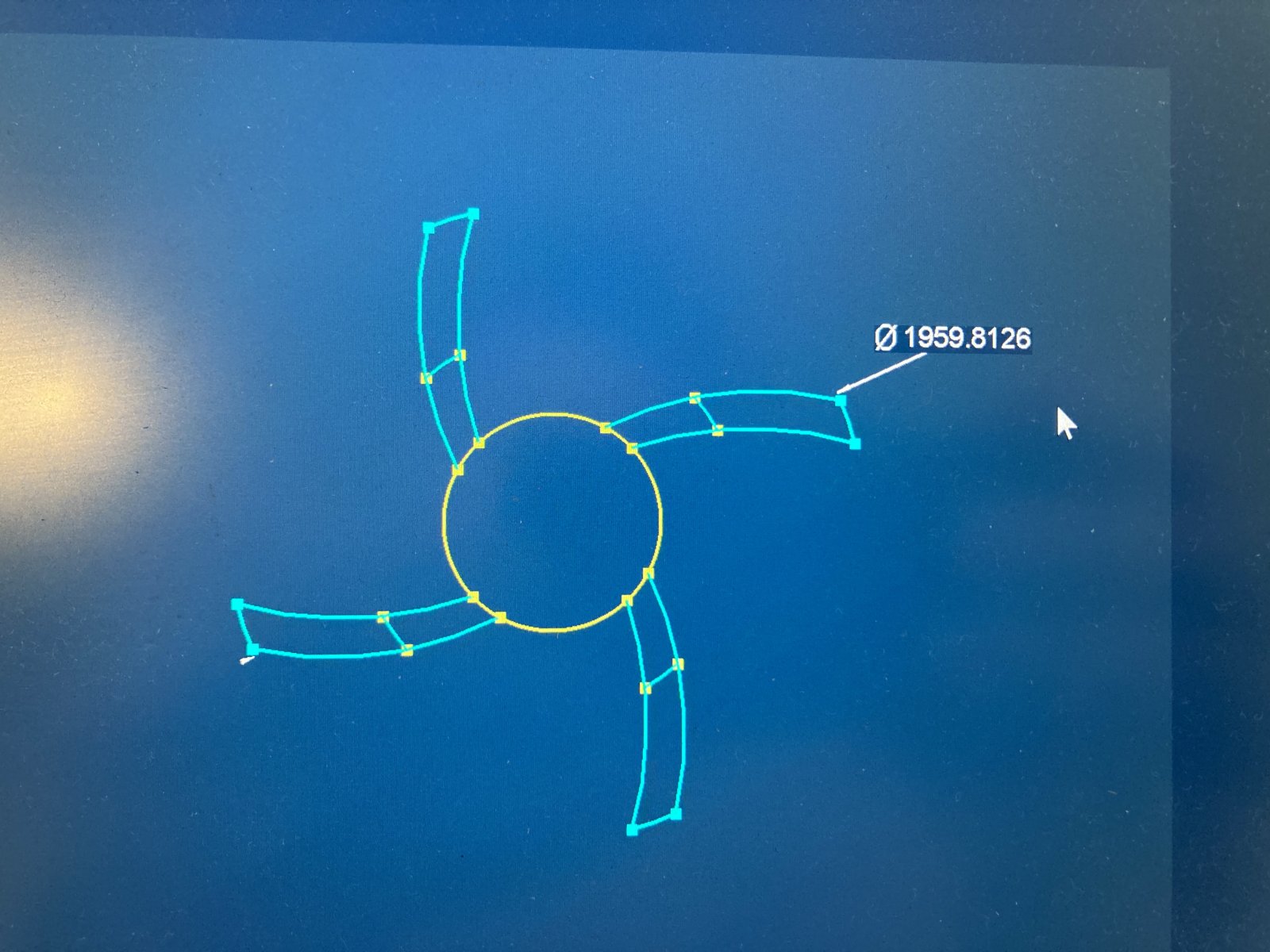

    Trim off what you don’t want and create geometry that closely follows the original contour. In this case I created 1 vein then copied the other 3

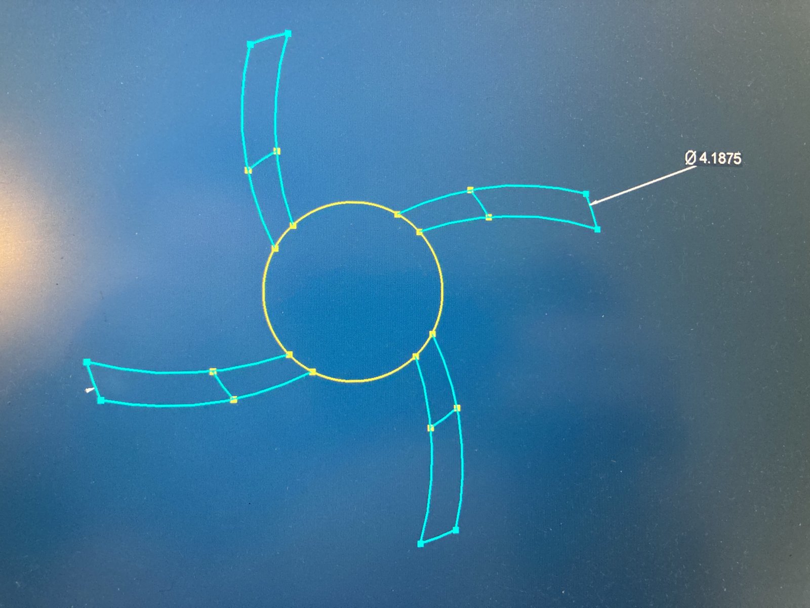

    Then scale down to a useful size;
    DUN!
