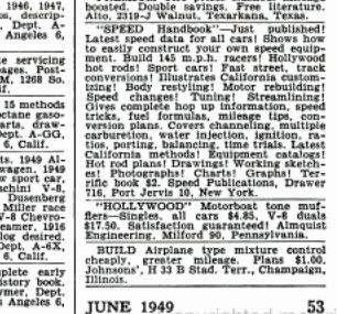

    Yes, You can still buy the reprint...
    A local has a very early edition of that book, 1948 I think.
    California Bill ran ads in the back of late '40s popular mechanics and mechanix illustrated.
    The earliest ad I've seen was in Pop Mechanics June 1949 issue:
    Bill had a speed shop in the late 40's at 6195 Figueroa in LA where he would box frames if that's what you wanted

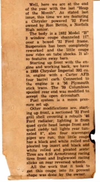

  23. Anyone got any OLD pics to verify this?
