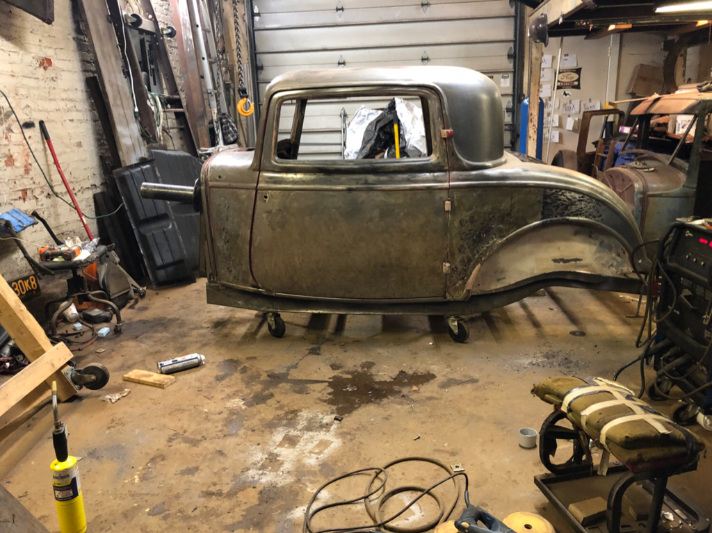

  6. Bend the bottom hinge back a bit two whacks with a heavy hammer to get the top and bottom even, then portapower the A pillar and front door opening about 1/4 in it'll spring back to 1/8th bigger that should do it. these are old bodies they want to be bent back into shape.

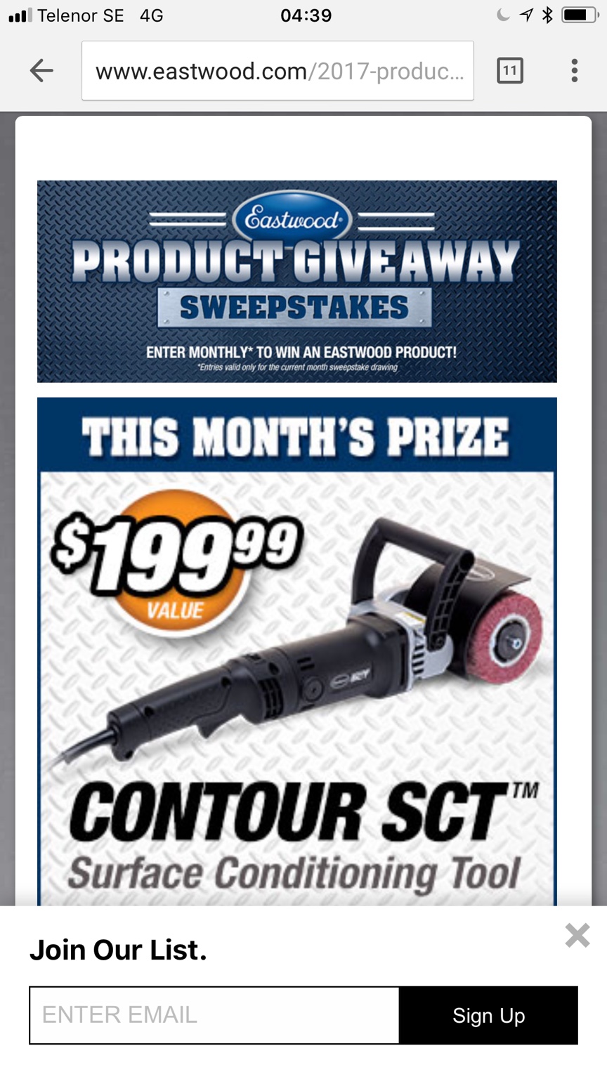

    Hope Flop doesn't mind me helping out - he's using a burnishing machine - a scotchbrite type material drum that runs on an angle grinder type machine. I think Eastwood have them but I've seen them on the 'bay. I'd add that this simply provides the final finish - the finishing magic on the magic that's performed earlier!

    Something like this?[​IMG]

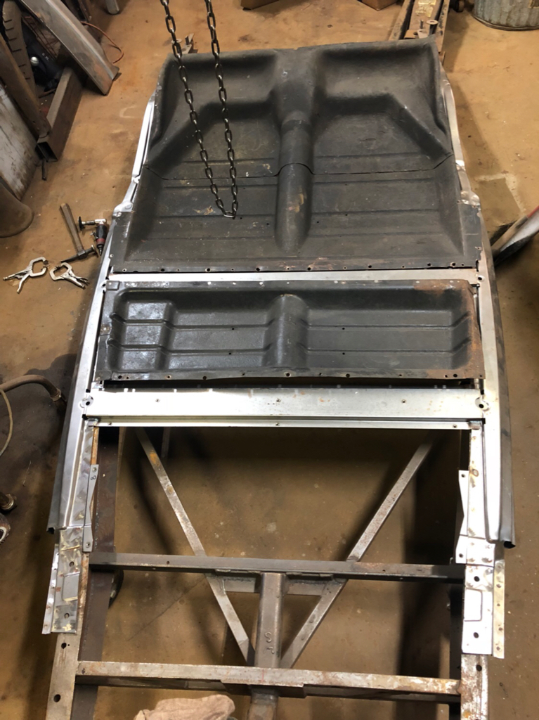

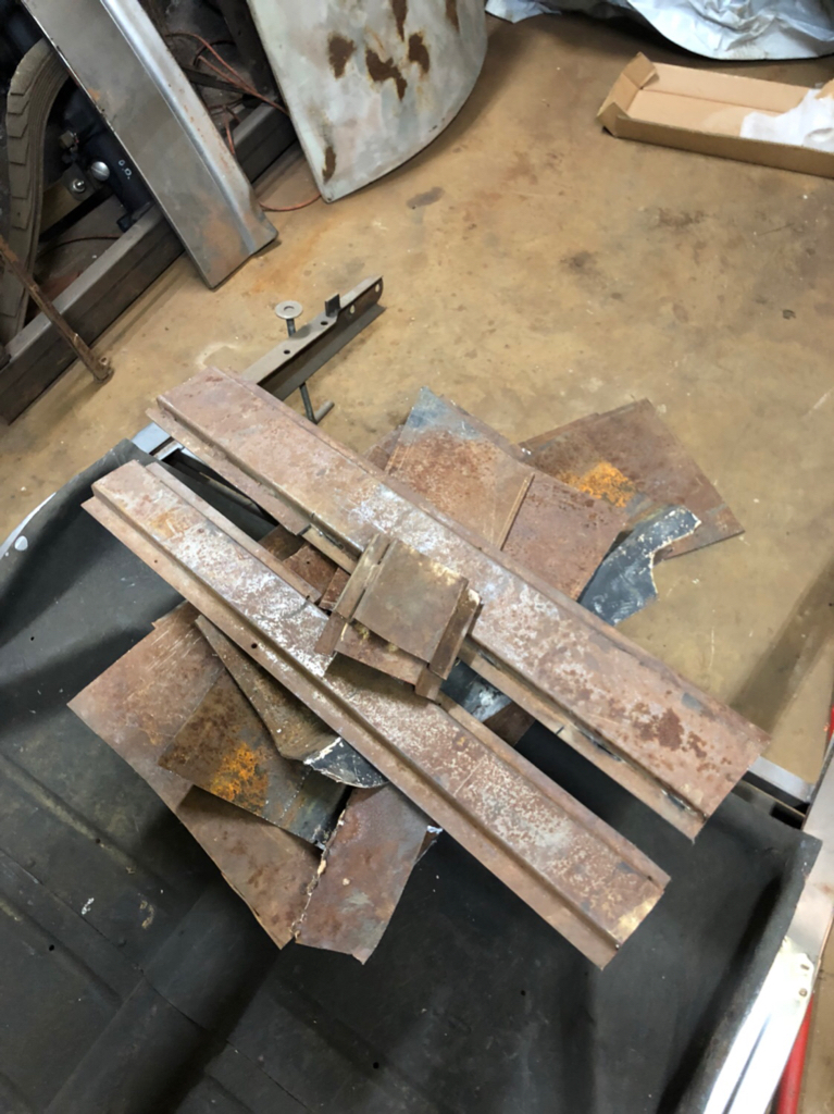

    T******* some fat . Back floor was plate steel
    Welded directly to the wheel well . These folks didn’t believe in spotwelds
    New subframe 1932 floor pans
    Als27T, tb33anda3rd, Gotgas and 4 others like this.

    Fine makes a rat tail grinder with variable speed and what they call a "sinus" wheel. It is essentially scotch bride in a drum shape. They are not exactly cheap but more readily available than Eastwood stuff. I used to sell them. But have moved on.

    75 dollar fine drums compared to 19 dollar Eastwood drums . I’ll wait a few days for shipping lol [emoji3][emoji3]

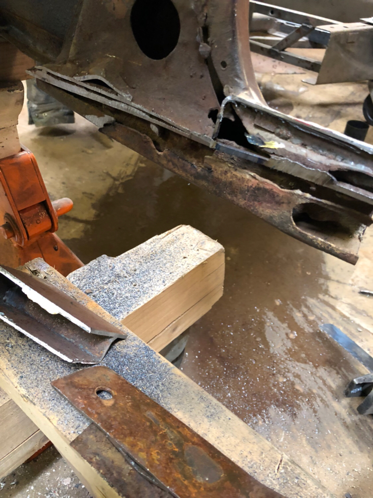

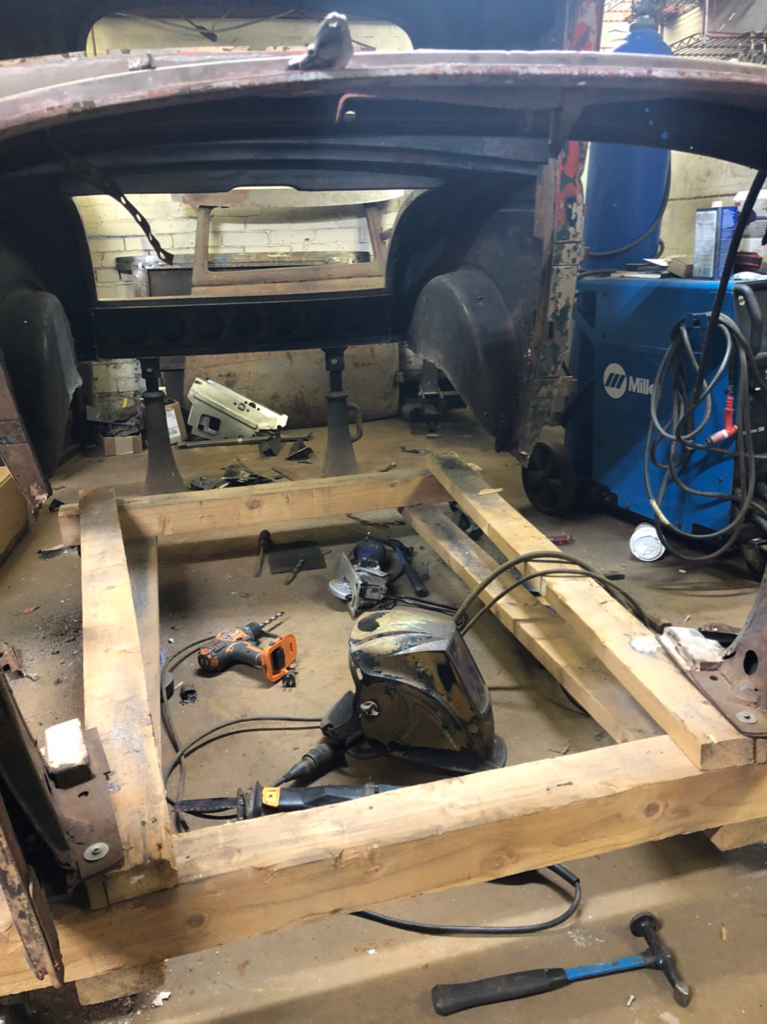

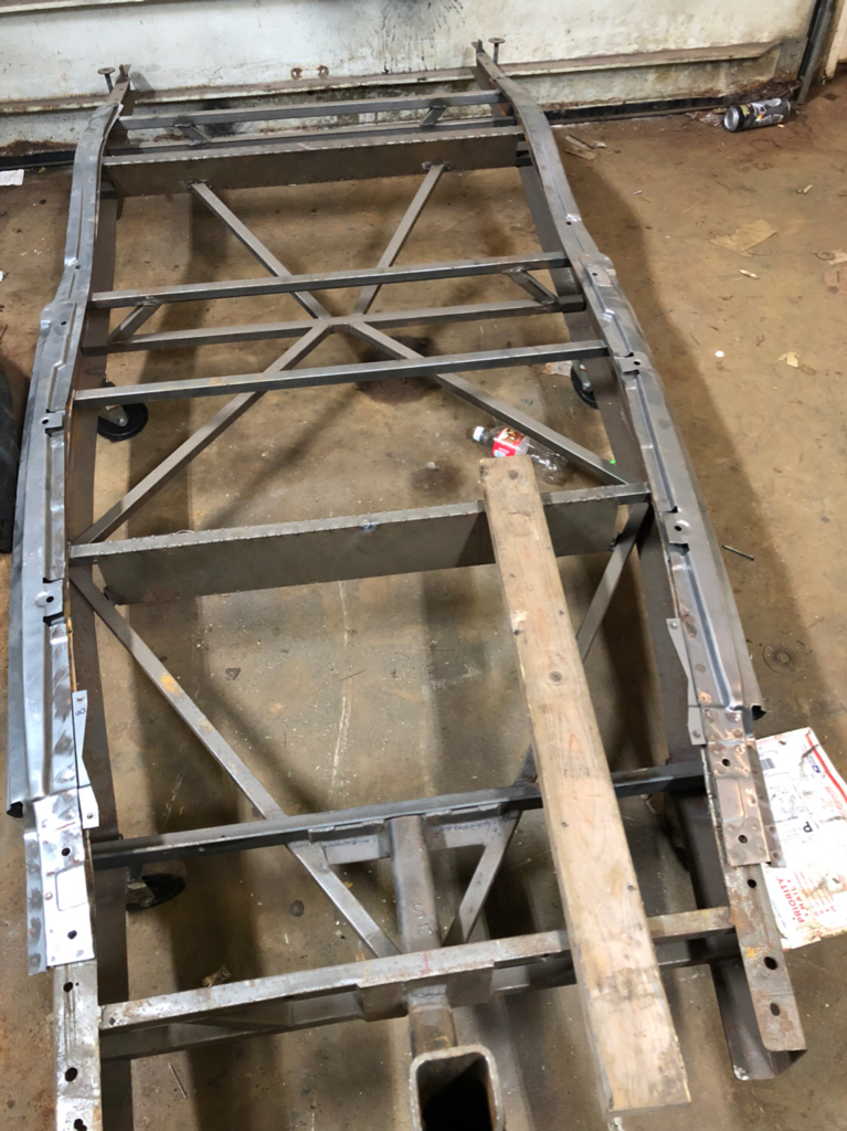

    Inside rocker prime
    New subframe level square and ready to go
    Burning out lead
    1/4 inch plate subframe
    Old b pillar braces out
    Cut the rockers out
    Not much left
    S****
    Als27T, joel, tb33anda3rd and 4 others like this.

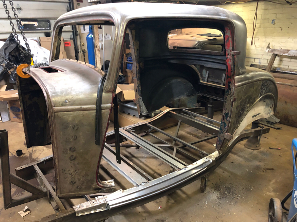

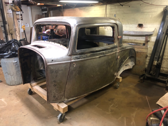

  29. Flop
    Joined: Jun 8, 2006
    Posts: 3,885
    Flop

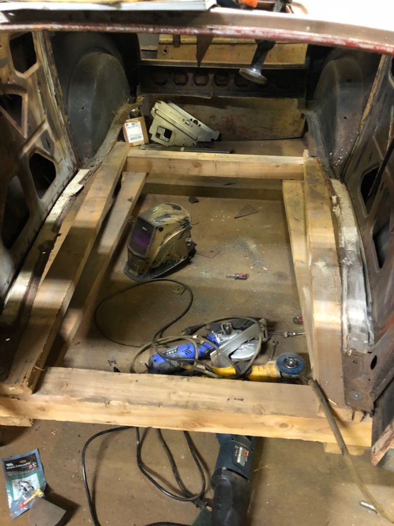

    Cutting plate steel out still .
    Have to put a hole in for the hinge screw
    Ready to sit on its new subframe
    Hey now !
    Thank fully the car opened up and we ya e some door gaps now
    Start at the b pillar to get a gap and work forward then get it attached to the subframe
    Als27T, tb33anda3rd, ls1yj and 9 others like this.
