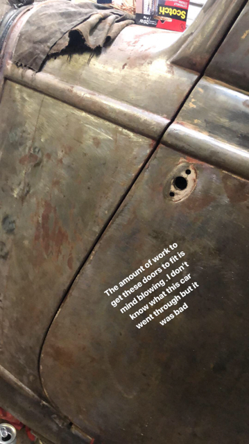

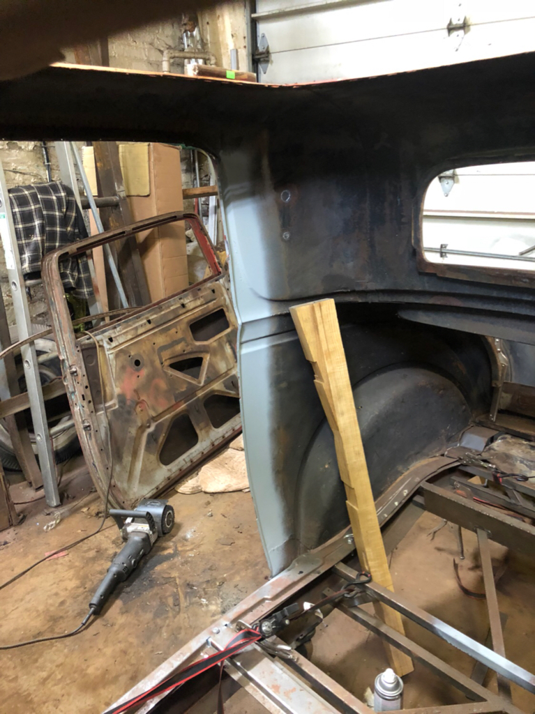

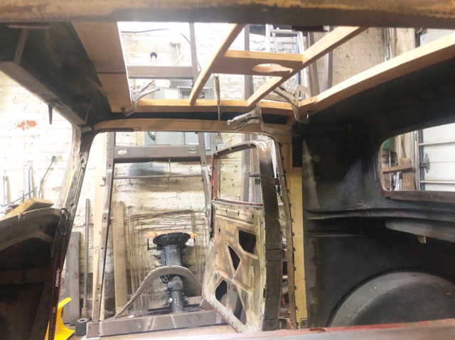

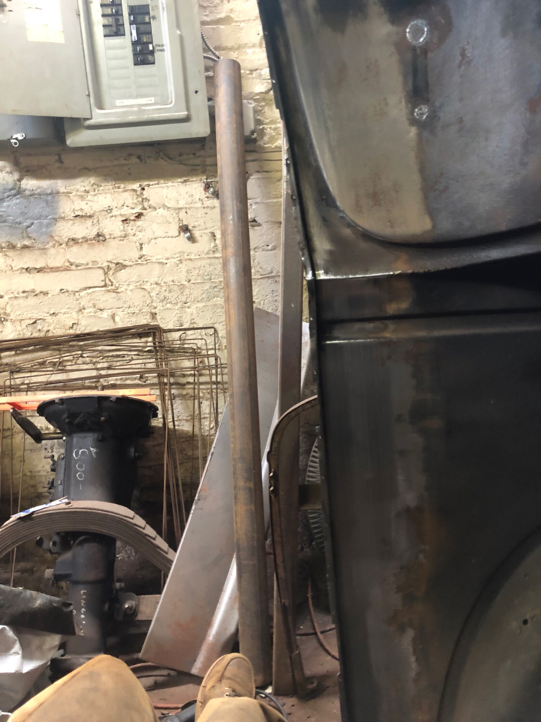

    Fixed the inner bracing instead of buying new
    Finished getting all the bracing out
    B pillar is twisted in a ton
    Subframe extensions
    Got the drivers door doing what I want

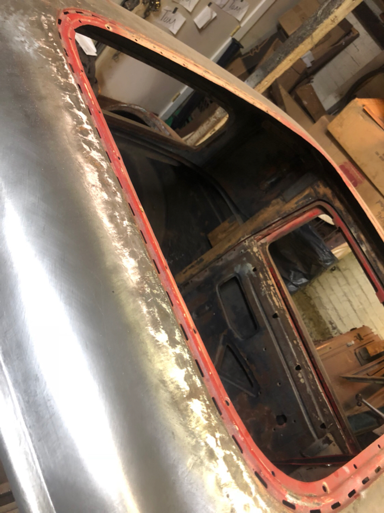

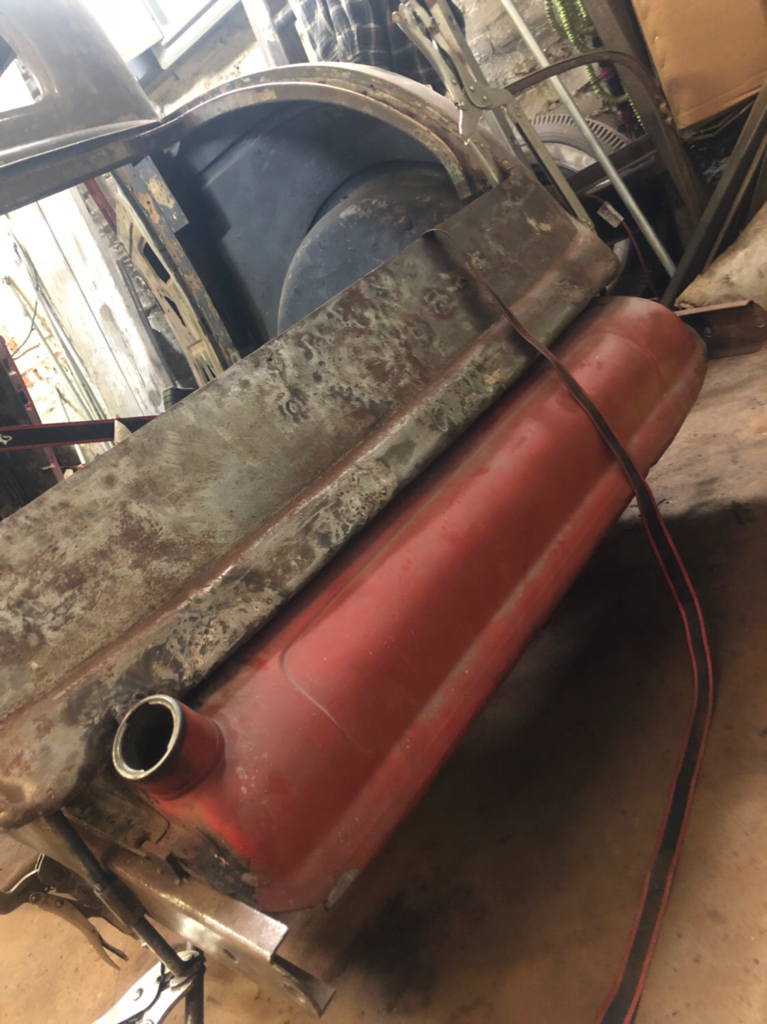

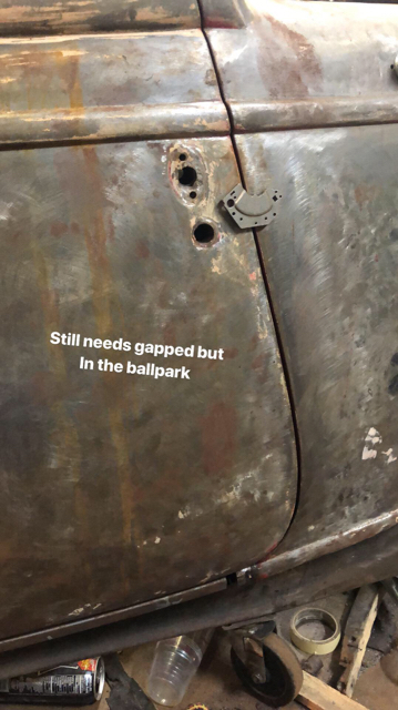

    Got this side fitting right . Door flows into cowl nicely
    Nice gap to the tank
    Also got the body lined up to center the tank in the reveal .
    Als27T, AHotRod, tb33anda3rd and 6 others like this.

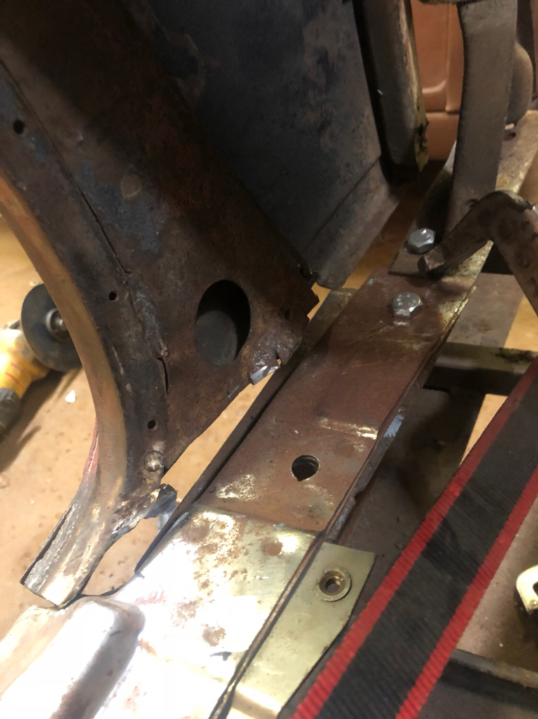

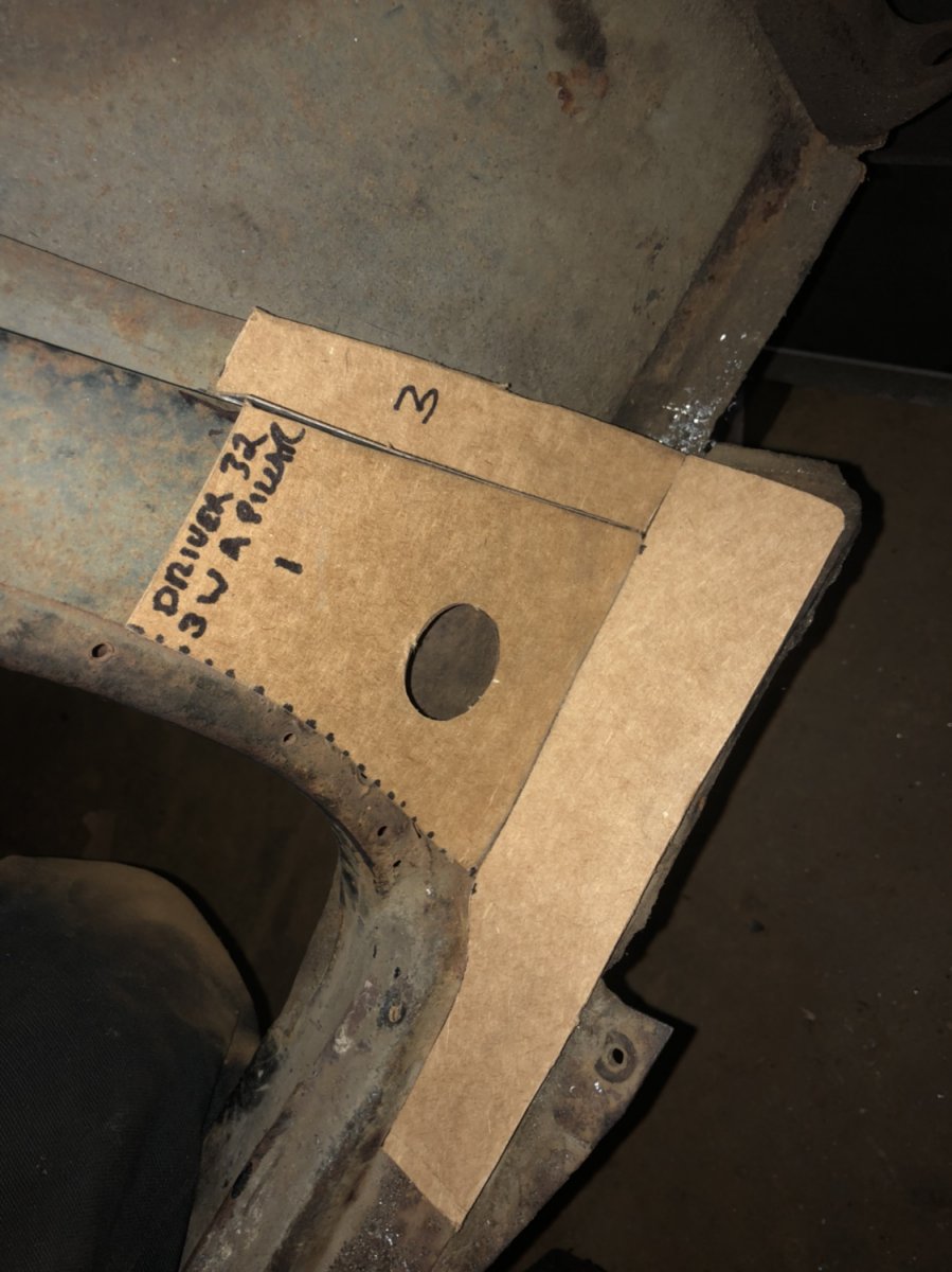

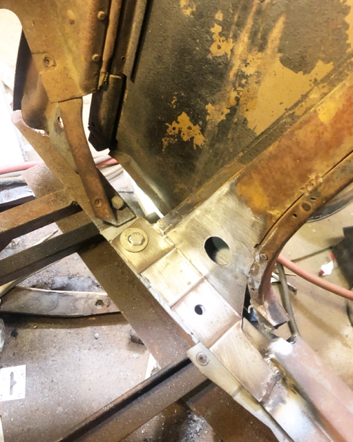

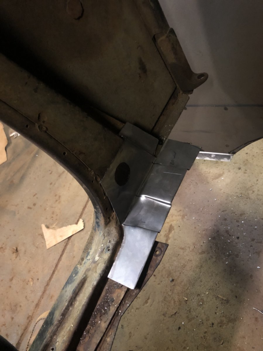

  11. Flop
    Joined: Jun 8, 2006
    Posts: 3,885
    Flop

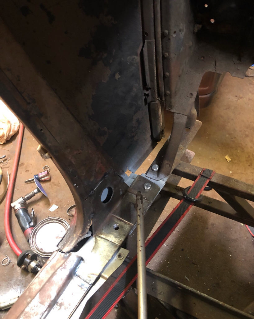

    New inner lower A pillars as these ones are shot
    Quick piece out of 20 gauge to see if it was right ...
    Now onto 18 gauge
    Als27T, ls1yj, tb33anda3rd and 3 others like this.

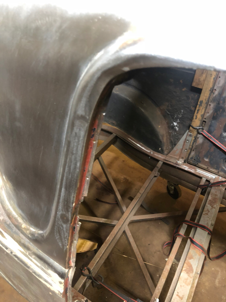

    Cars attached in the drivers side to the subframe .... no detail work to be done til the whole car is fitting together well

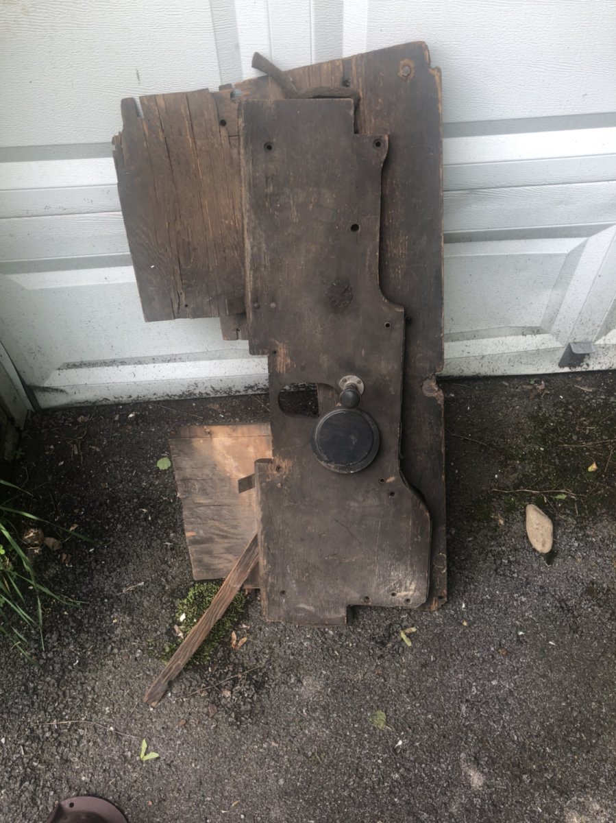

    All stripped ready for the wood
    Fix some
    Dents
    IMG_4332.JPG make the wood look stock with the nail in nutzerts
    Als27T, ls1yj, AHotRod and 3 others like this.

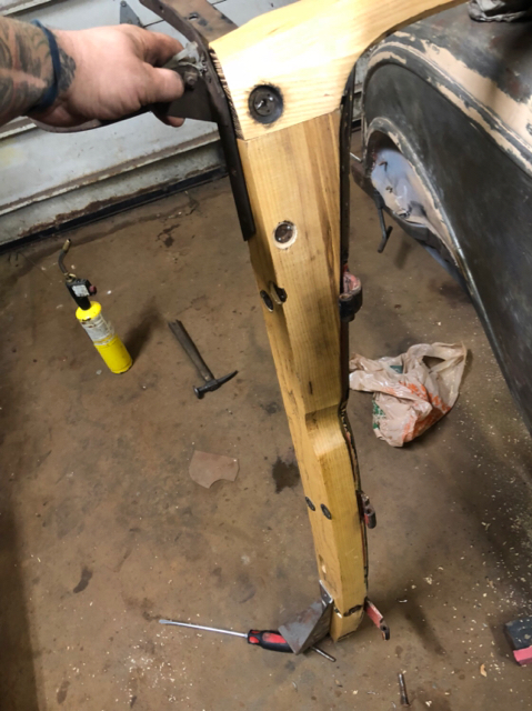

    Lots of time into that . So many variable setting that wood in place
    Gotta fix that before the wood above the door goes in

    More wood details
    You can barely make out the 1/4-20 stamp on them
    Back to looking stock even though the new brookville wood is missing the dovetails .

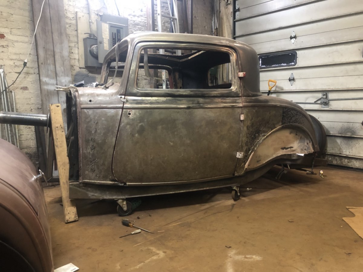

    Didn’t forget about ya Doc !
    Moving along
    finally getting somewhere on this car
