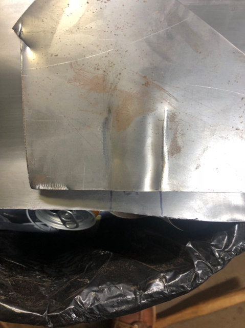

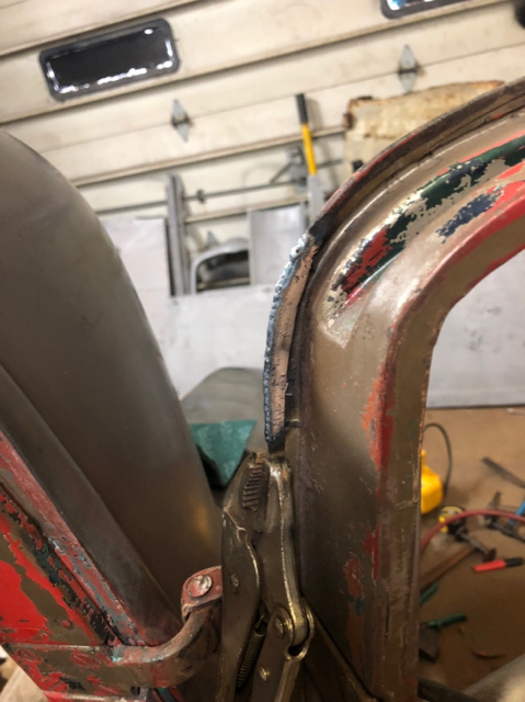

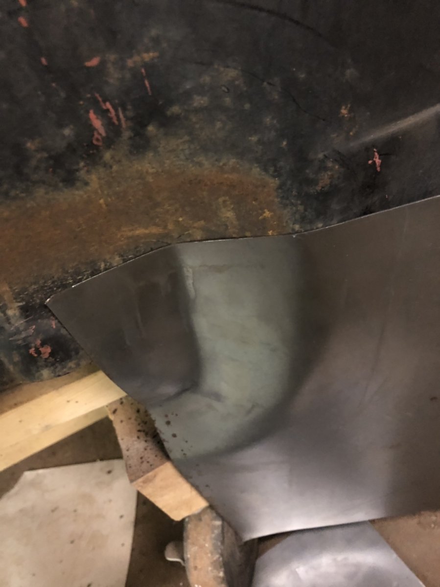

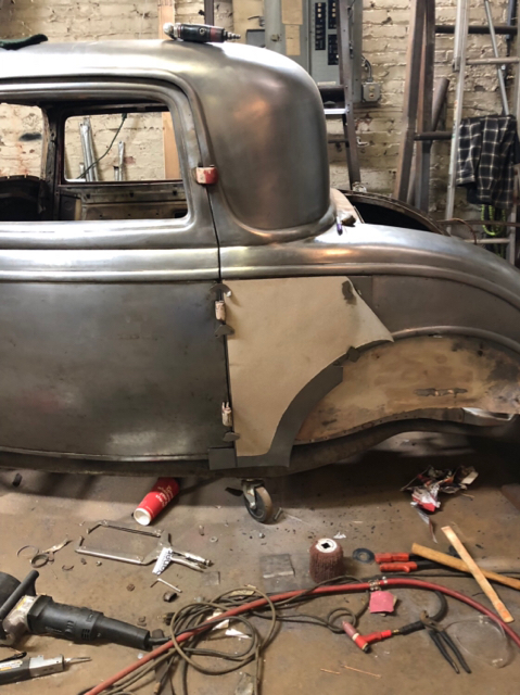

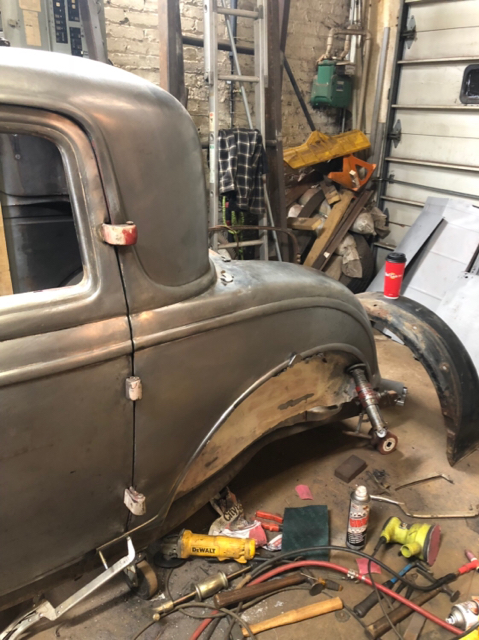

    Never liked the way this part of the cAt came together .so cut it apart and fix it .
    One last thing left to do . Make a quarter patch

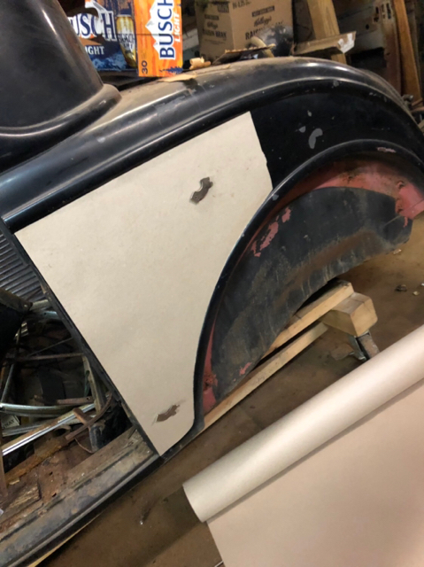

    There’s a quarter panel in there somewhere
    Now to place the bead
  8. Flop
    Joined: Jun 8, 2006
    Posts: 3,885
    Flop

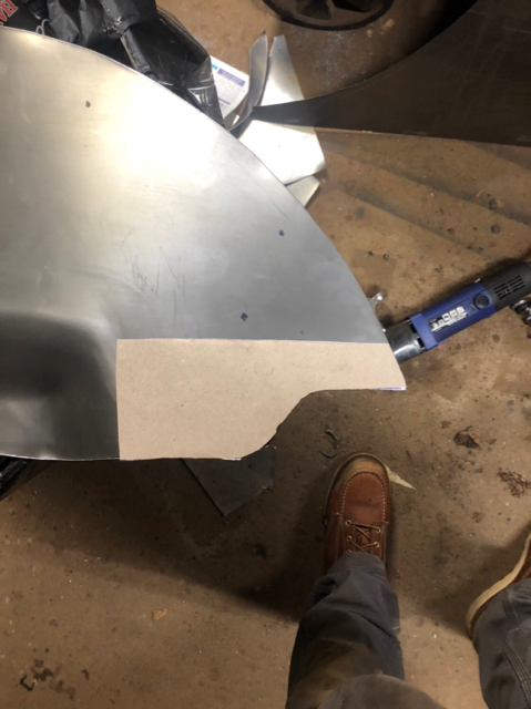

    Nice pattern pays off
    Cut a big hole
    Still not done . And I don’t know why the body line looks choppy at the top of the quarter

    It looks choppy because you haven’t touched it. Yet.

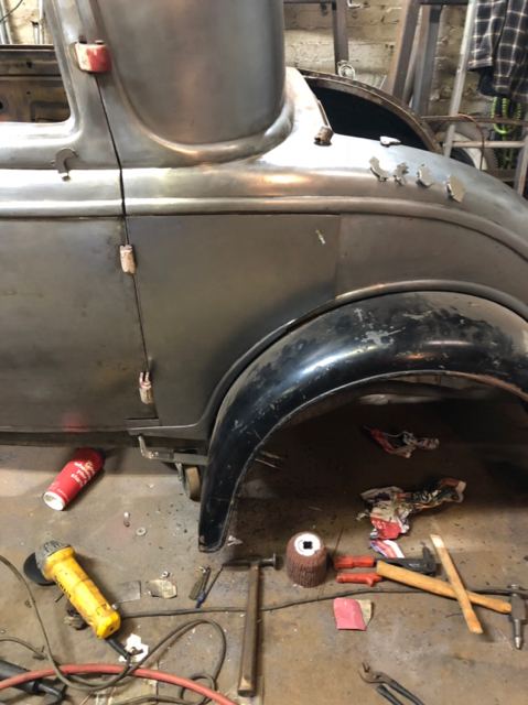

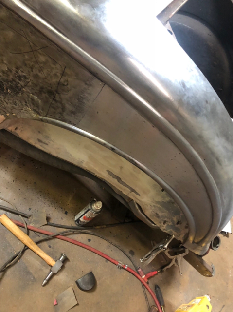

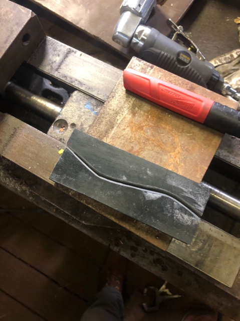

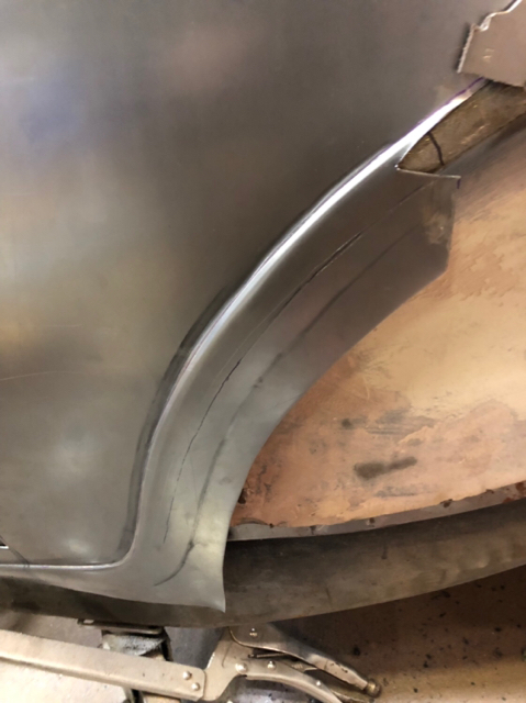

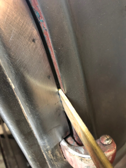

    Working on where the quarter laps the rocker
    Then realized how bad the wheel wells ****
    [​IMG]that should
    Do it
    Practice piece
    How the reveal is layed out . Starts from nothing goes to full shape on the right

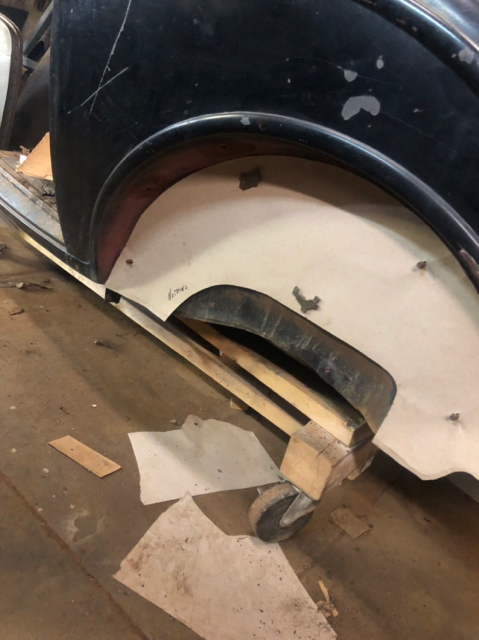

    Always helps to have an extra '32 3Window for patterns.:rolleyes: Bob

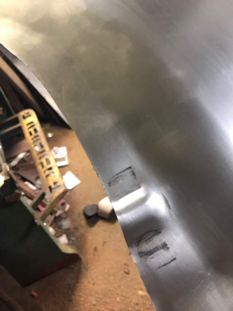

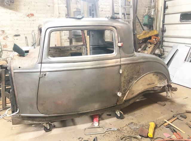

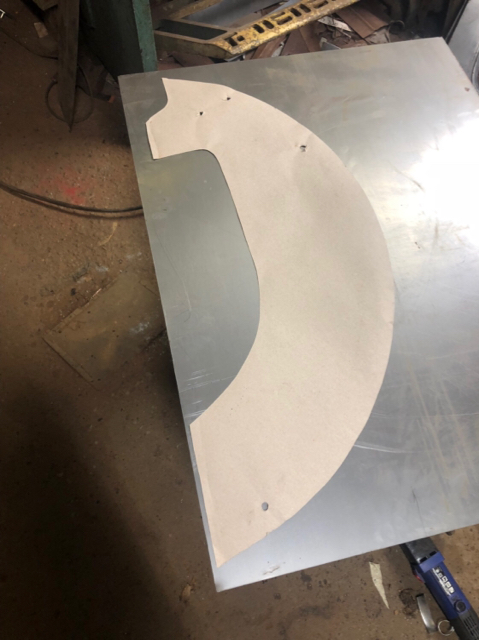

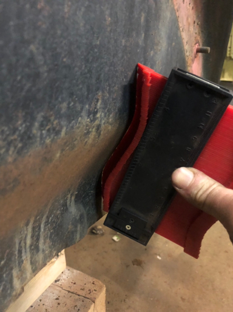

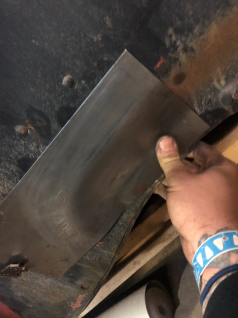

    There’s a wheel well in there ! I can see it !
    1/4 inch of mud in what’s there
    A lot of details missing

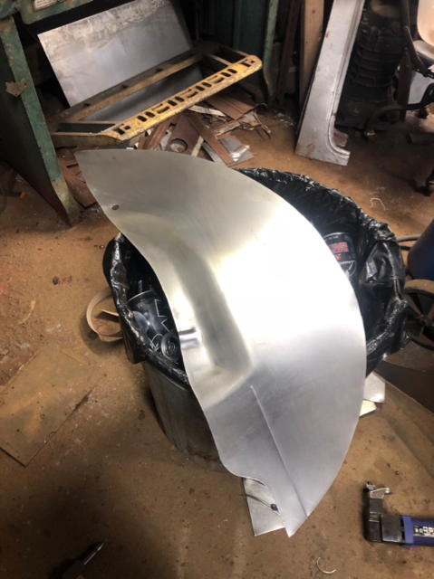

    Got the reveal in there
    Random ford hole
    [​IMG]that gives me the line for the step
    [​IMG]random die I had laying around will work
    If they don’t make it ya gotta make it !
    Still really surprised no one makes 32 3 window wheel wells .

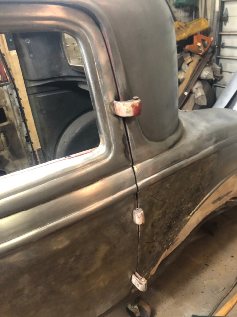

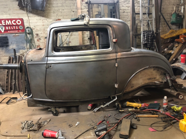

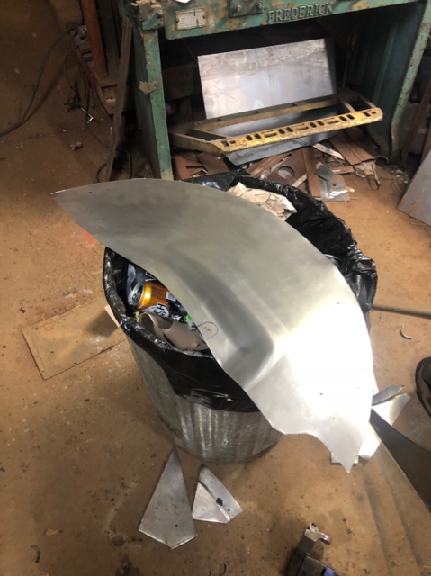

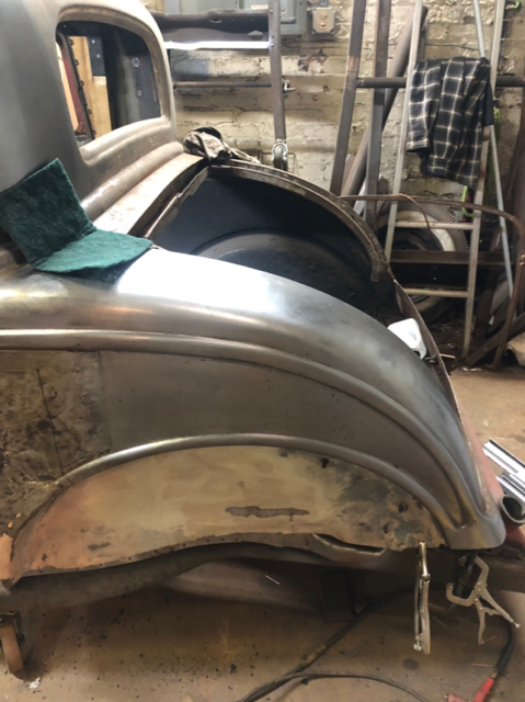

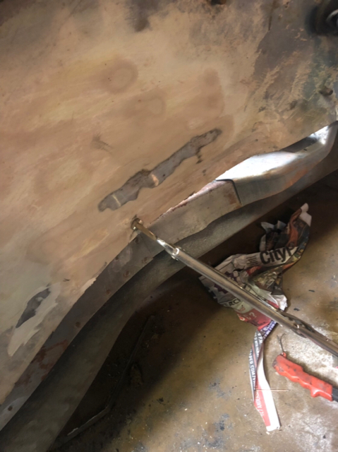

    Well the wheel well looked good but needed more draw in the reveal so back to the drawing board IMG_6671.JPG
    Made a new die

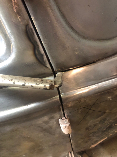

    Guessing external hinges at one point
    Cat walk just about done

    Thanks for posting here. The work is fantastic, but the part about "hmm, not good enough" is what raises the bar for the rest of us. 99% would just slap some bondo on the catwalk and send it down the road...

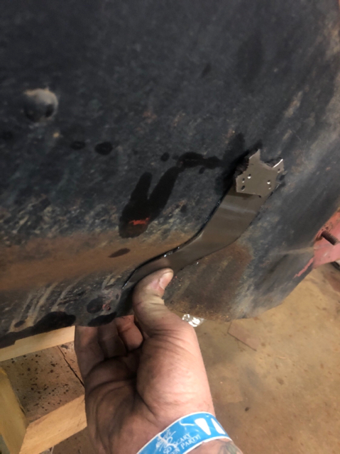

    What are these bracket looking metal pieces I keep seeing?
  25. kidcampbell71
    Joined: Sep 17, 2012
    Posts: 4,756
    kidcampbell71
  26. shadetreerodder
    Joined: Aug 4, 2006
    Posts: 291
    shadetreerodder
    Computer hard drive magnets. Super strong.
