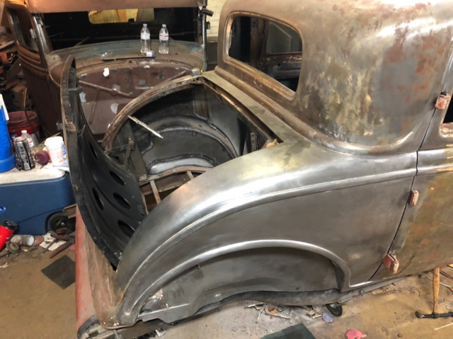

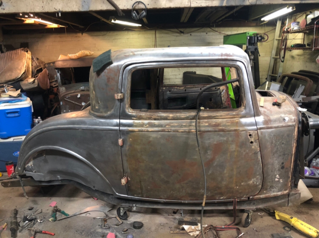

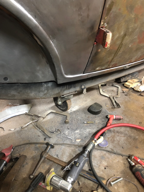

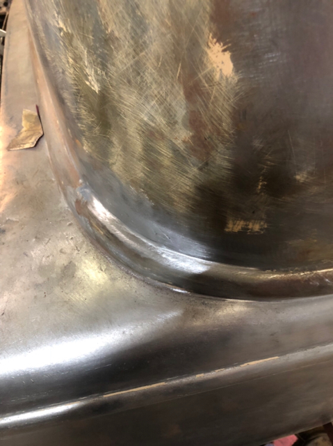

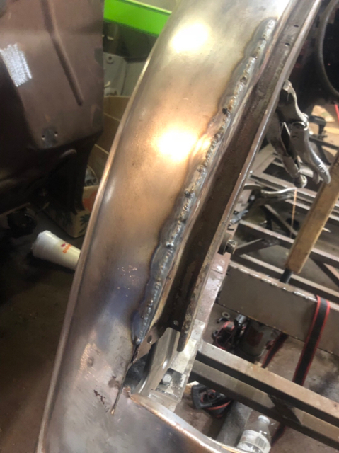

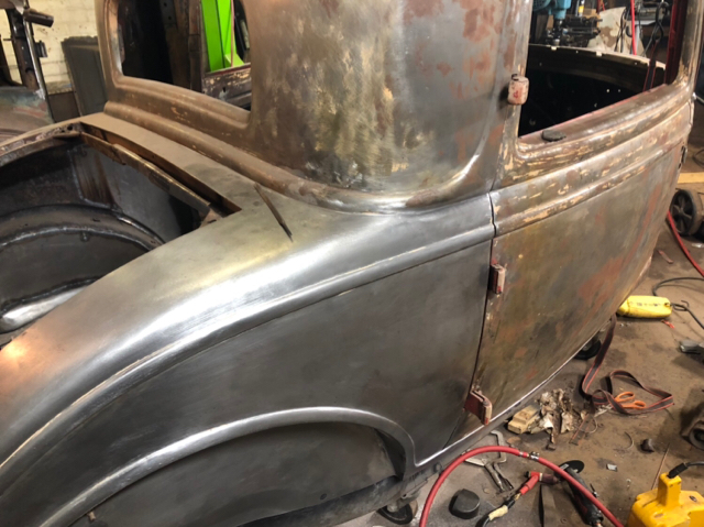

    Patch welded up .
    Also stepped the quarter on the rocker like ford did instead of just lapping it
    Quarter was cracked

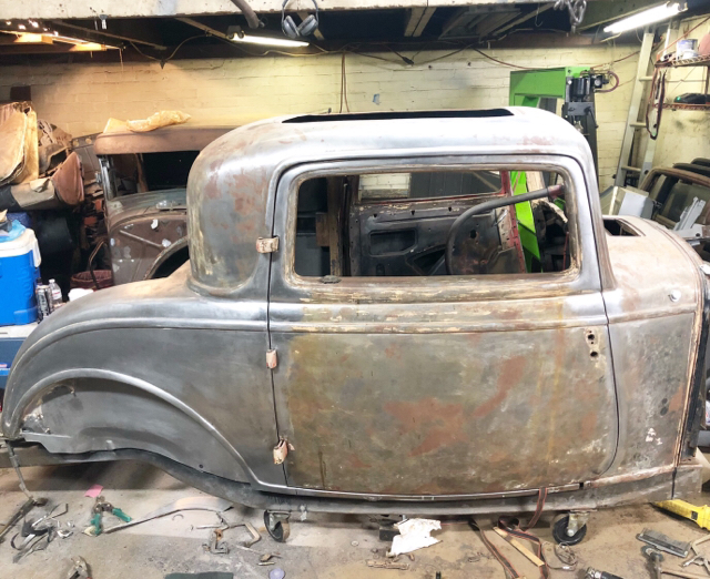

    Getting the door gapped
    Getting there
    Tighten up a little more and the gapping is gonna be done

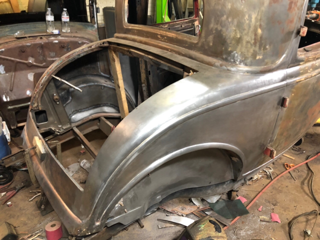

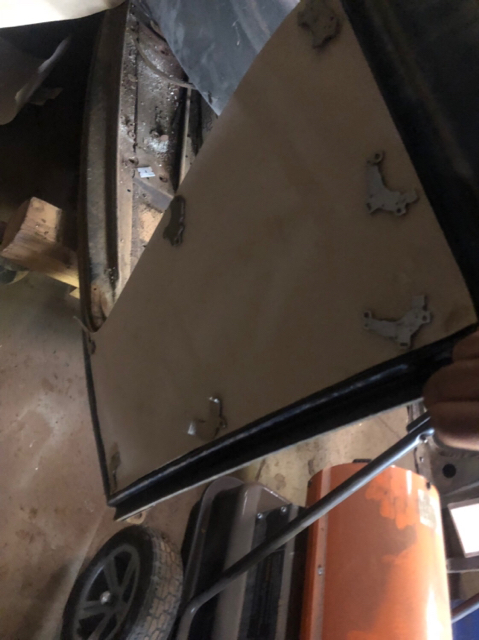

    Luckily a nice original to copy from
    Before all the tweaking
    Pretty happy now

    If you are talking about where I cut the back panel out no way . I would rather spot weld the panel in like stock then have 3 feet of weld with no access to hammer it.

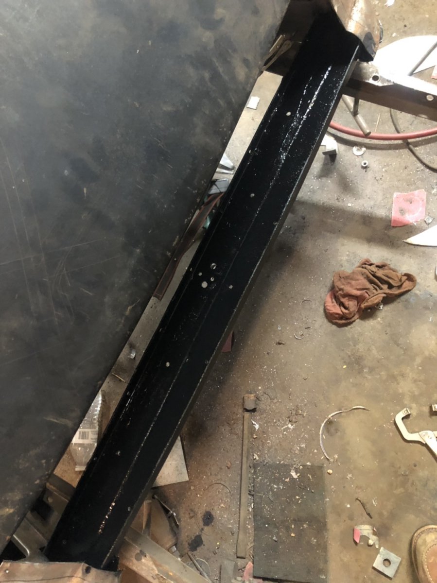

    Rust encapsulator while it’s all apart
    Brookville panel fits real nice

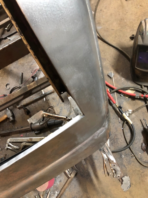

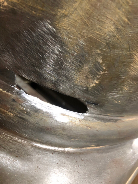

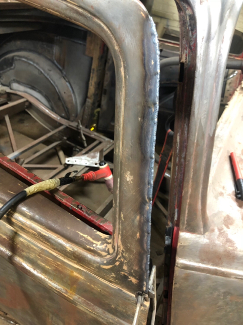

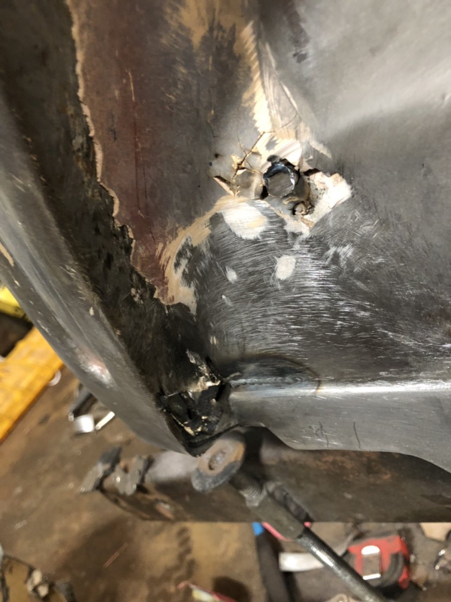

    Welded but some rust showed it’s facewhere the panels are doubled
    Same over here thin rusty and mig welds all over
    [​IMG] inner was cracked
    Only so much you can do with the double panels
    Got the damage out time for a new lower edge
    mgtstumpy, ls1yj, dlw1932 and 5 others like this.

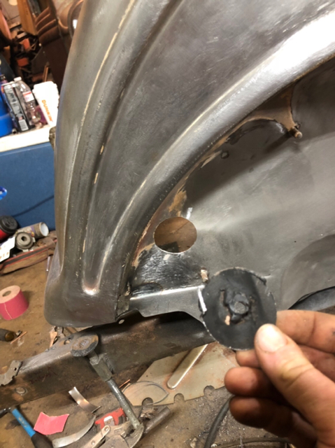

    Joined: Dec 6, 2010
    Posts: 2,674
    pumpman

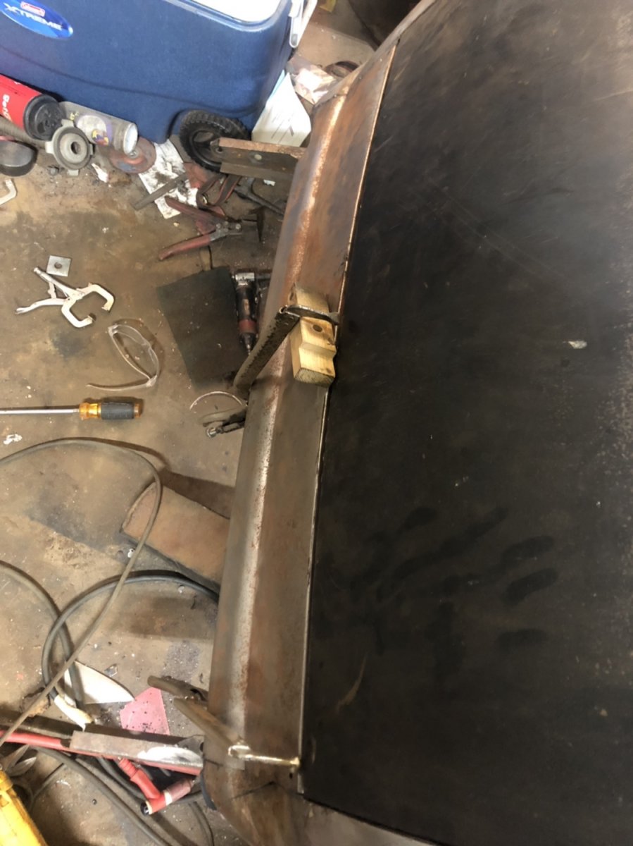

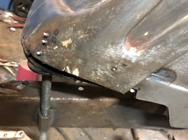

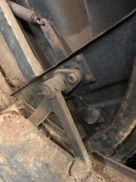

    Flop, is that threaded for lifting or to apply pressure on the bottom piece?
    loudbang and Stogy like this.
  11. James D
    Joined: Feb 8, 2007
    Posts: 5,133
    James D
    Great work...I´m amazed.
    loudbang and Flop like this.
  12. Flop
    Joined: Jun 8, 2006
    Posts: 3,885
    Flop
    Sets your body to gas tank gap .
  13. pumpman
    Joined: Dec 6, 2010
    Posts: 2,674
    pumpman
    Thanks Flop.

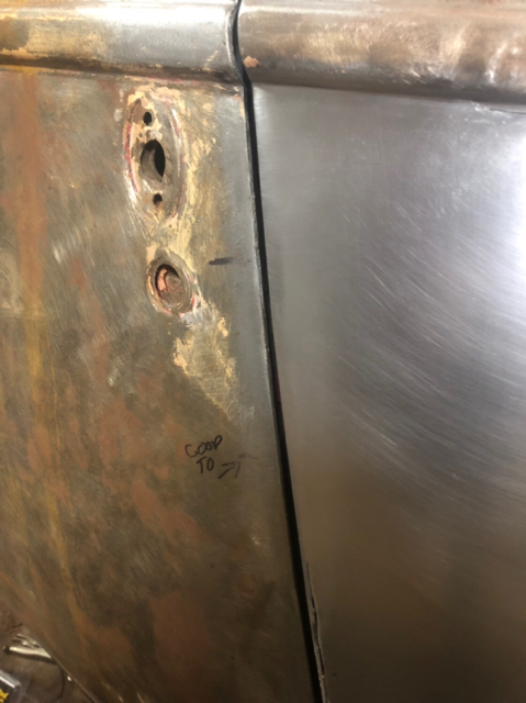

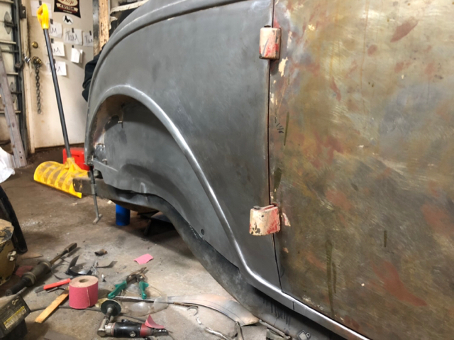

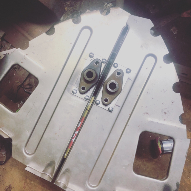

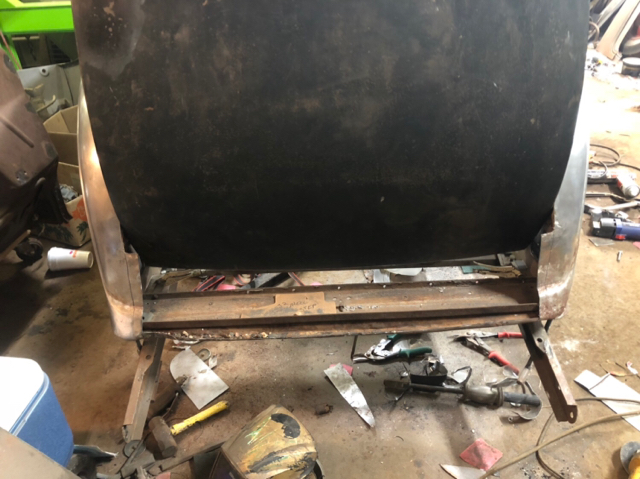

    Making gaps a tad nicer
    Riveted stippled braces in for the rumble seat hungers
    Als27T, ls1yj, mgtstumpy and 8 others like this.

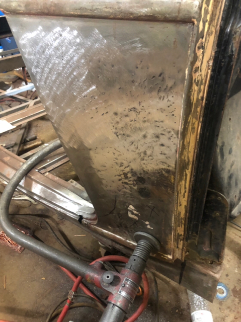

    Old thin welds
    And when we decided the cowl side needed replaced
    Als27T, mgtstumpy, loudbang and 4 others like this.

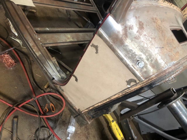

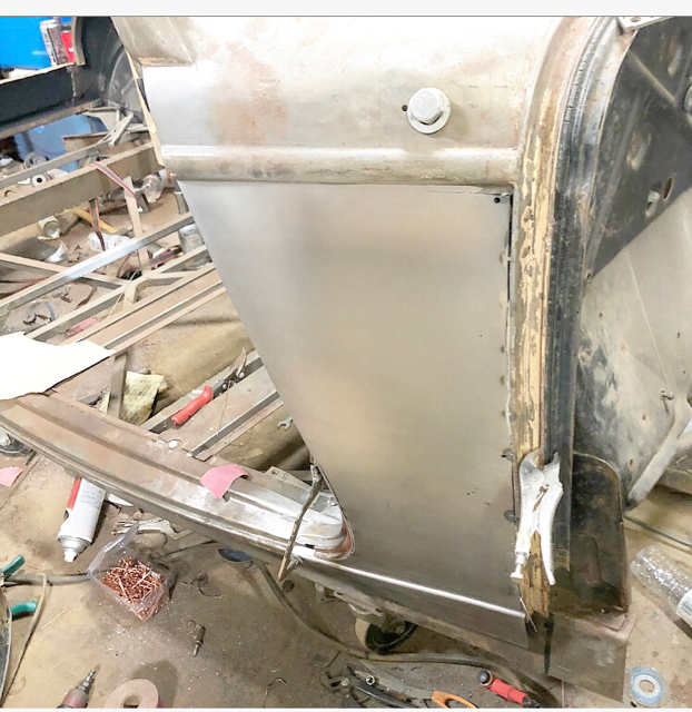

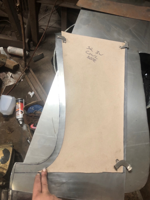

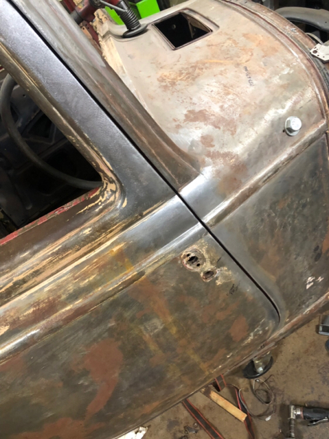

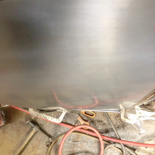

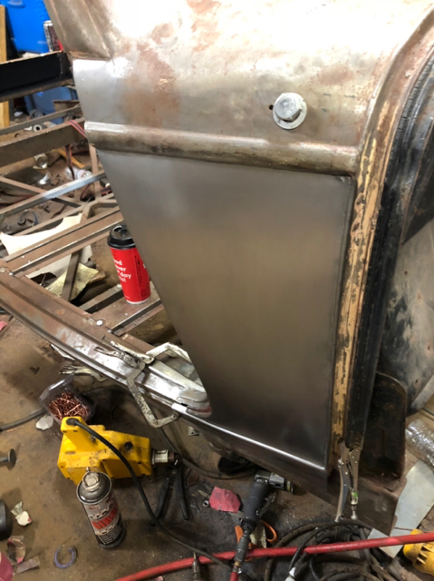

    Thankfully docs car is here as a great template !!

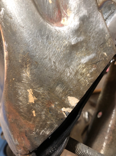

    On the bad panel . You can see the wrinkles where it is bad
    Template on the newly shaped panel ... no wrinkles

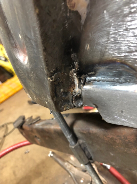

    Flop whats the purpose of the bolt on the cowl
    Stogy and loudbang like this.
  24. Flop
    Joined: Jun 8, 2006
    Posts: 3,885
    Flop
    Used it on both side to pull the cowl down because the feet on the inside of the cowl were missing .
    mgtstumpy, Stogy and loudbang like this.

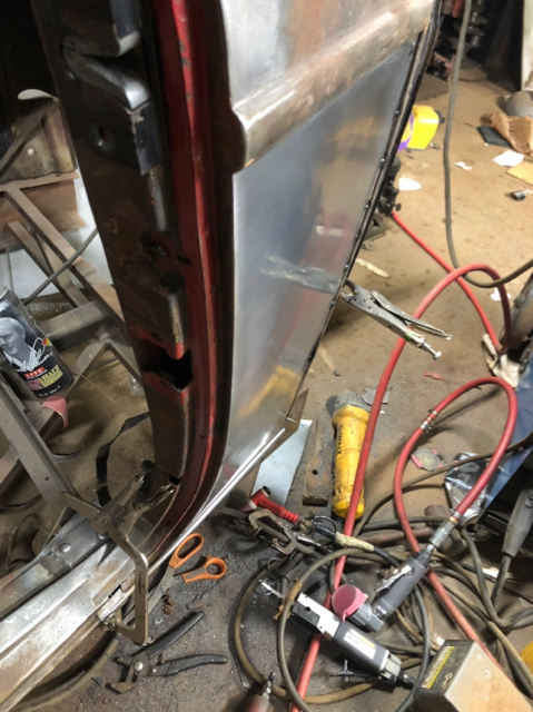

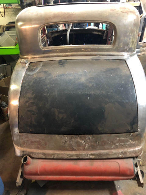

    Closing in on it
    Now to put a step in the rocker and work the cowl into the rocker .
