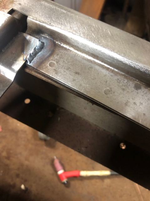

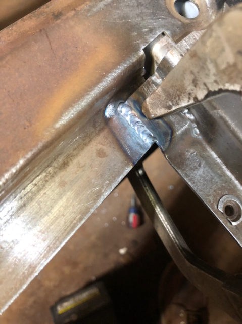

    Laying the cowl into the rocker
    Someday it will be done [emoji23][emoji23]

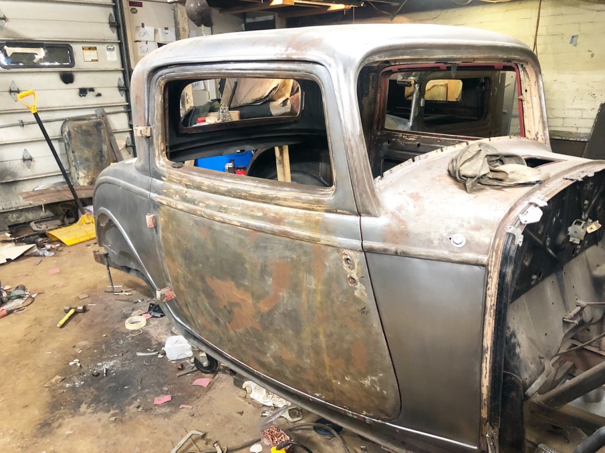

  6. Flop
    Joined: Jun 8, 2006
    Posts: 3,885
    Flop

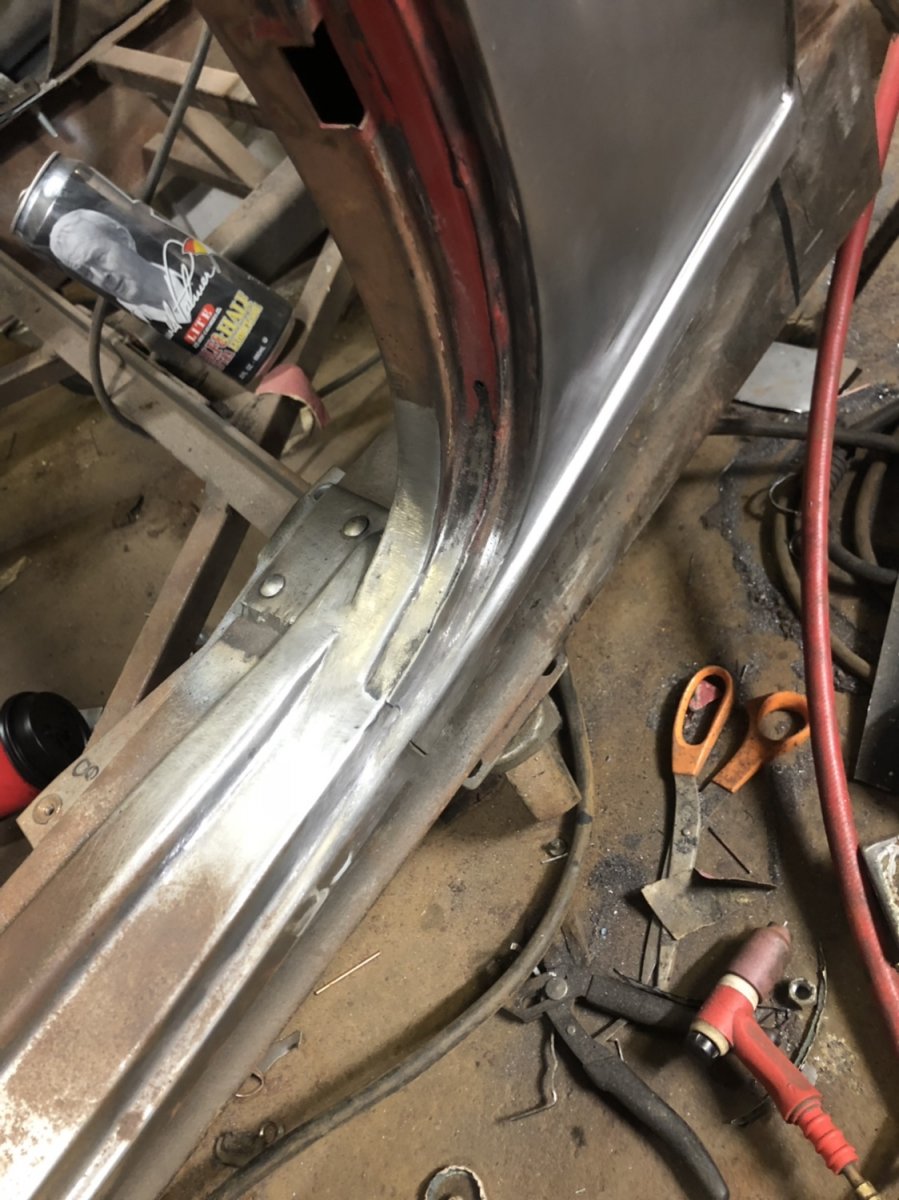

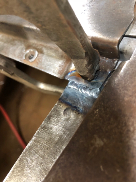

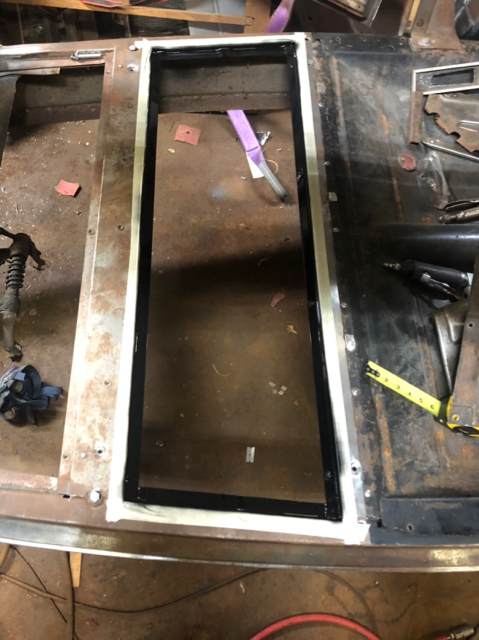

    Moving along

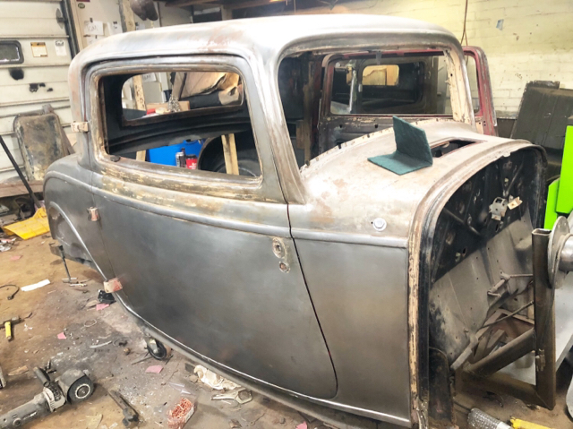

    Now for a bunch of little things to tie up . Then a stock floor is going in .

  7. redoxide
    Joined: Jul 7, 2002
    Posts: 773

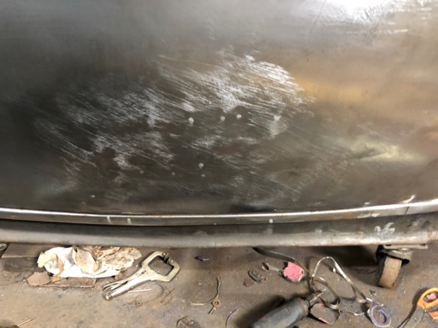

    redoxide

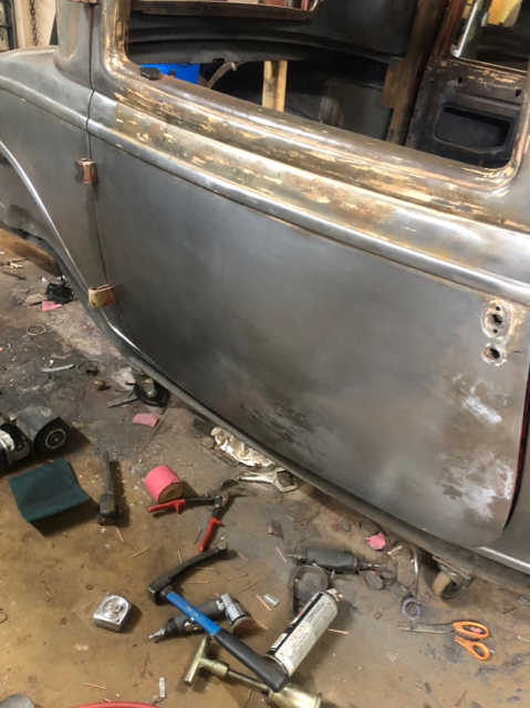

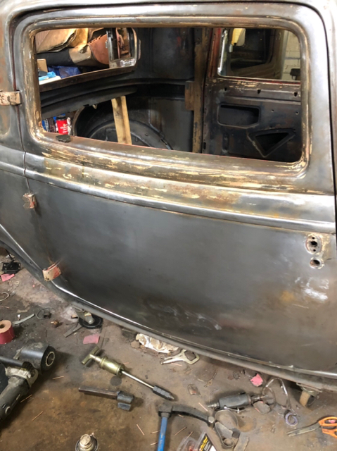

    are you managing most of the lows with a puller ? thats a stunning result on the door skin..
  8. Flop
    Joined: Jun 8, 2006
    Posts: 3,885
    Flop

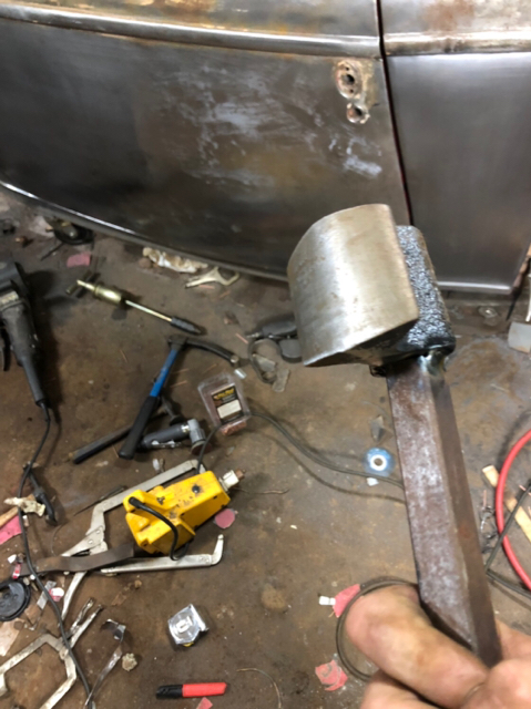

    No sir that’s only good for sharp dents in my opinion . Not lows that are large and shallow . Most of it was brought up with hammer on a high crown dolly
    Darryl Deir, mgtstumpy, Stogy and 2 others like this.

    Do you use a bullseye much?
  11. redoxide
    Joined: Jul 7, 2002
    Posts: 773
    redoxide
    are your arms made of super bendy pipe cleaner type things ? How do you manage to get in behind the skin.. ? Ive done a few big panels but I've often resorted to cutting out the inner structure, doing the planishing work and welding the inner back in.. or suffer being cut to shreds and a week of back and elbow pain having contorted myself into the best possible position to reach through the small access holes, but you never can quite get to the bbit you need to work.. :( Hats off to you, the finnish looks perfect ..

    Find some ****ty dollies clean them up to your liking and weld a stick on em !! [​IMG]

    Arghh .. one of those super simple "why didn't I think of that" solutions, bet you experienced lots of bloodshed before you came up with that idea..

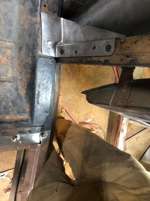

  16. Flop
    Joined: Jun 8, 2006
    Posts: 3,885
    Flop

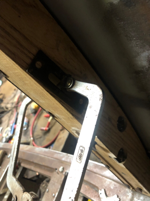

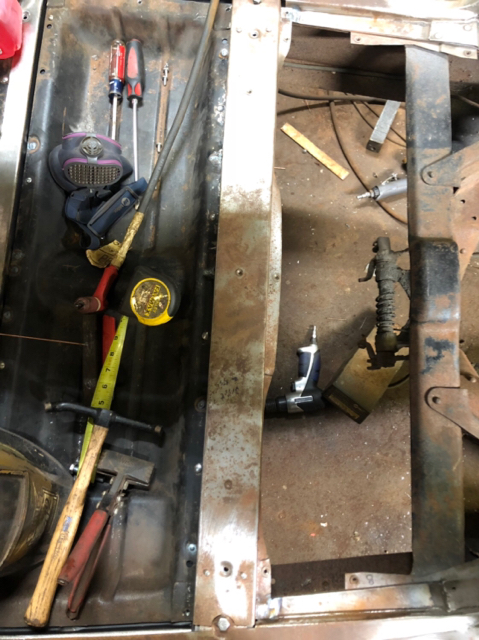

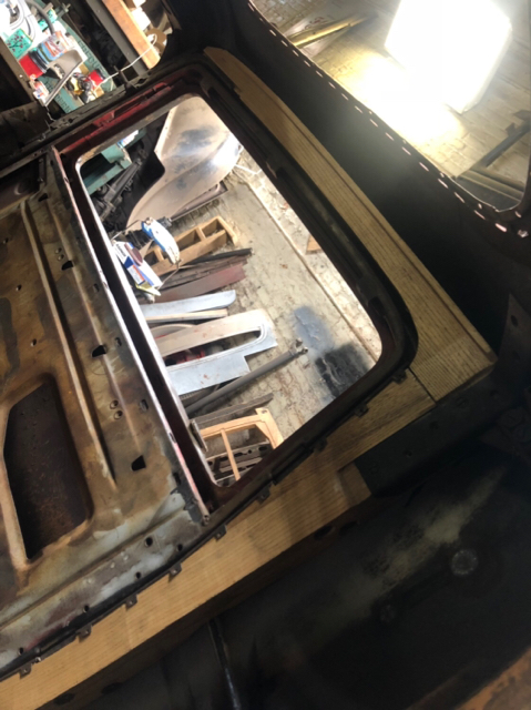

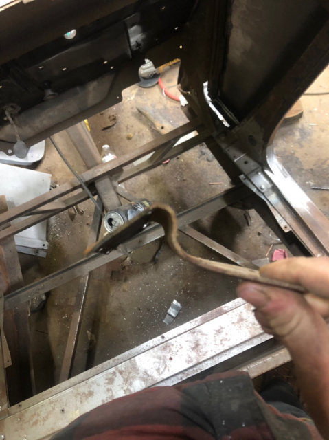

    Someone’s bent the hell out of the front brace for the top wood so that had to come out
    Also the wood above the door is permanently in
    Als27T, ls1yj, mgtstumpy and 8 others like this.

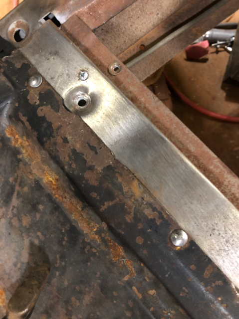

  17. Flop
    Joined: Jun 8, 2006
    Posts: 3,885
    Flop

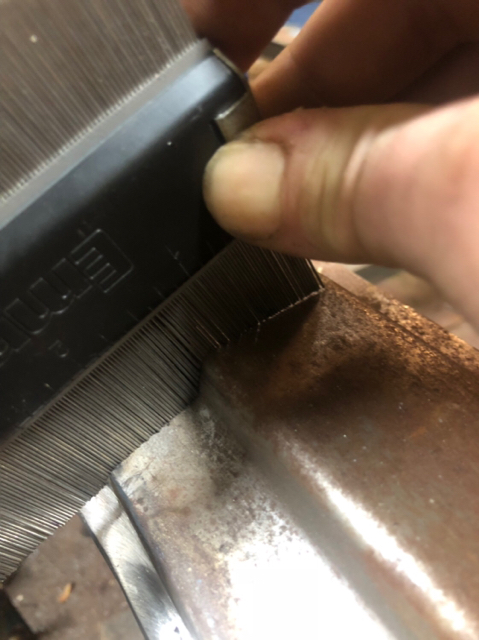

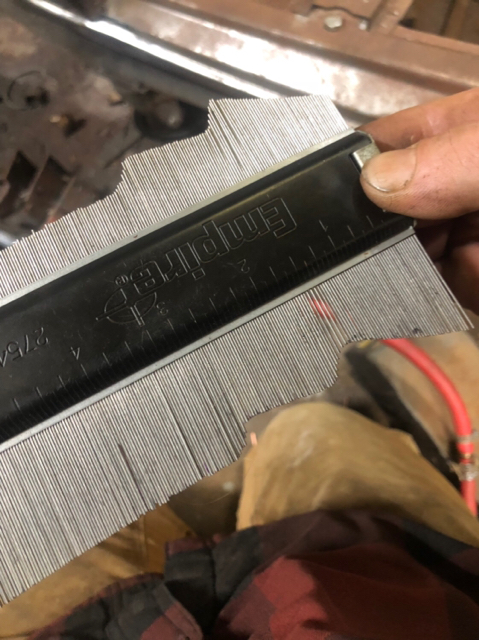

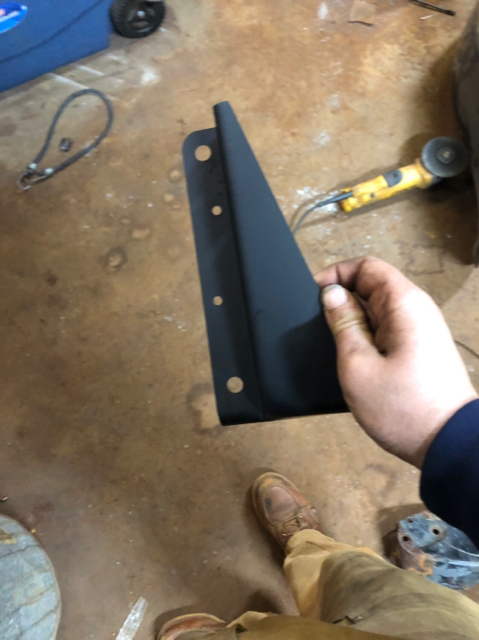

    Shape I need
    Check strap thing in
    Package tray block
    Made a die to make this inset for the running board brackets that goes into the cross channels on the floor
    Als27T, mgtstumpy, loudbang and 7 others like this.

  20. Stogy
    Joined: Feb 10, 2007
    Posts: 27,523
    Stogy

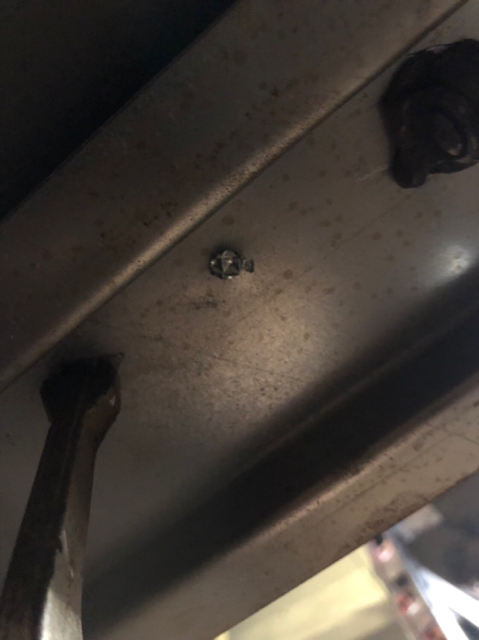

    I believe that is actually called dimpling as the material is to thin to countersink. There is to Male and Female Dies
    and it can involve several layers. Csk fasteners or rivets are the fastener of choice for this application.
    Always incredible to see your Metalsmithing Magic @Flop.

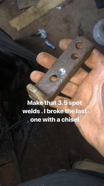

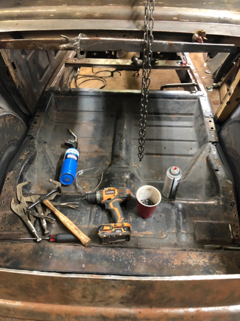

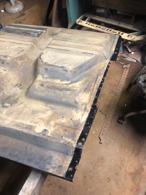

  21. Flop
    Joined: Jun 8, 2006
    Posts: 3,885
    Flop

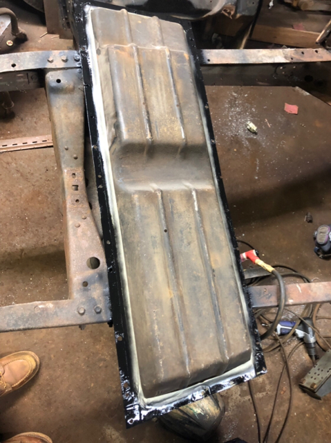

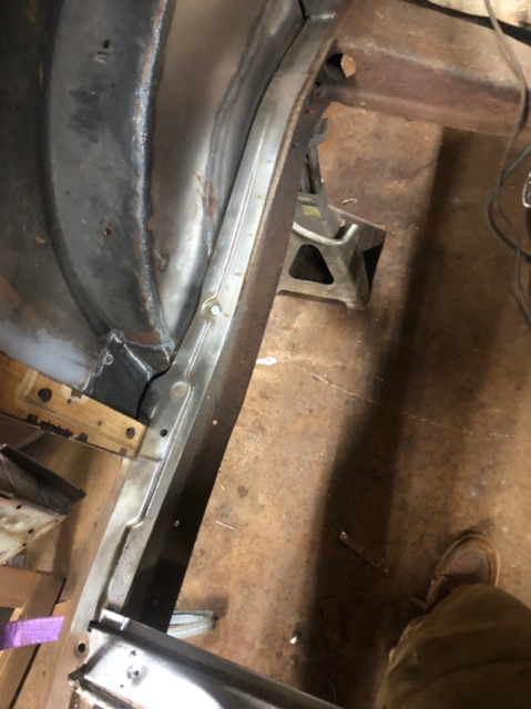

    Have to put it on an original fram to fit the new old floor pans
    De rusted the subrails
    Got the back riveted in
    Now for 347 spot welds hahaha

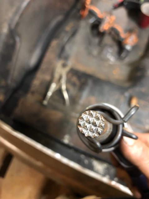

  27. Flop
    Joined: Jun 8, 2006
    Posts: 3,885
    Flop

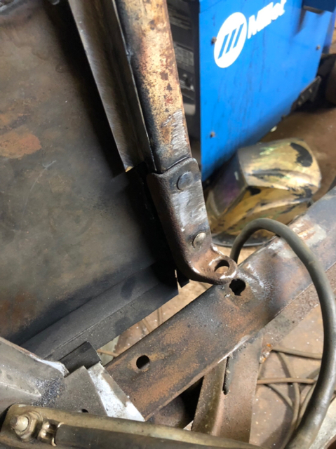

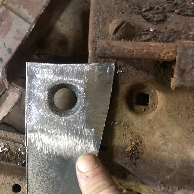

    Alll the details [​IMG]
    New original feet put on
    What an original looks like
    Bent the break like original
    Als27T, mgtstumpy, loudbang and 4 others like this.

    I can sympathize on those cowl band feet. I did a pair about a month ago. Henry sure didn’t want them to fall off.

    I don’t m ow what they are cast out of but holy hell the hardness [emoji15][emoji15][emoji15]
