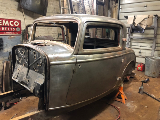

    I have a bunch of pieces for one .quarters roof pieces .1 door . Cowl sides and top . Firewall . Decklid . Dash . Top wood .

    Man you are making me want to hammer the top on a rust free 3W ! Fear , is the only thing stopping me . My top is filled so that’s a bit more to deal with .
  8. Flop
    Joined: Jun 8, 2006
    Posts: 3,885
    Flop
    What does a filled top have to do with chopping one ?!
    Als27T and loudbang like this.
  9. krylon32
    Joined: Jan 29, 2006
    Posts: 11,191
    krylon32
    from Nebraska
    Filled top will not hamper chopping the top, just lean the front posts back
  10. deathrowdave
    Joined: May 27, 2014
    Posts: 5,189
    deathrowdave
    from NKy
    I’m goin to by a new chainsaw chain tomorrow , and let the sparks fly !

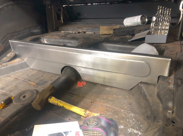

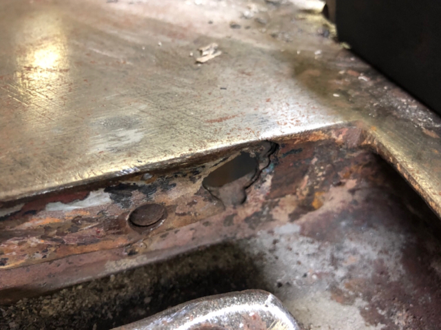

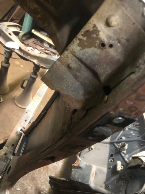

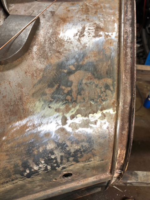

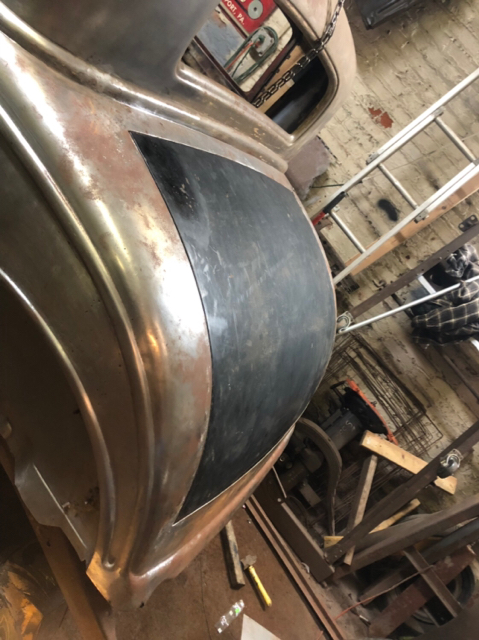

    Well trying to be cute with my metalwork I thinned out a small section of the cowl top . Always better to cut way out into solid metal
    Way better then before
    Few more things off the list !

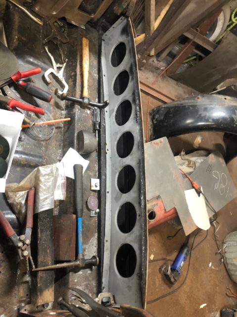

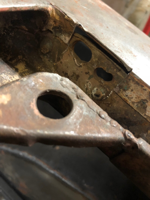

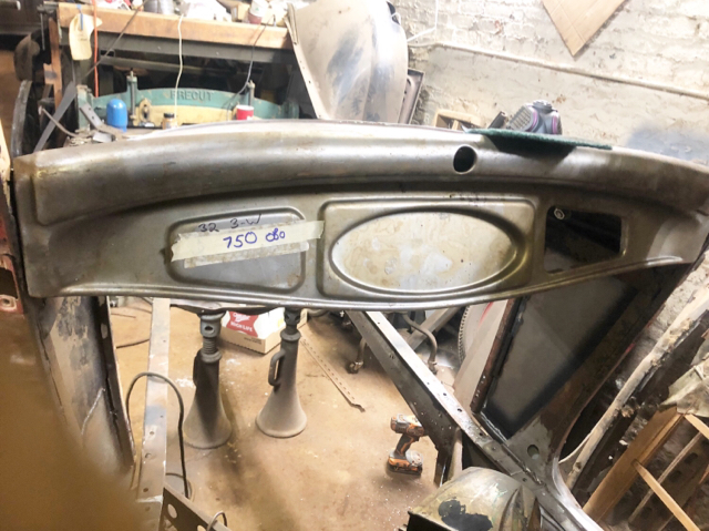

    Cowl top just about done
    Sadly very deep hammer marks that will stay

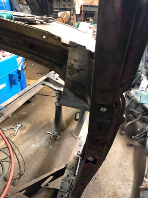

    Firewalls in
    Brace that runs across the floor
    Als27T, Mart, Fordor Ron and 5 others like this.

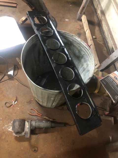

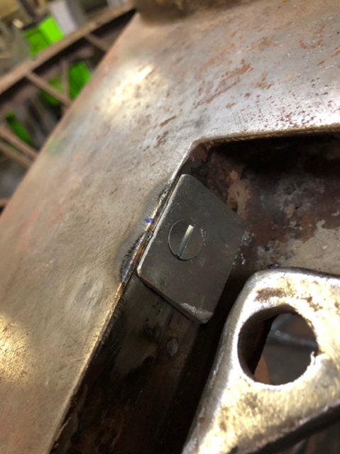

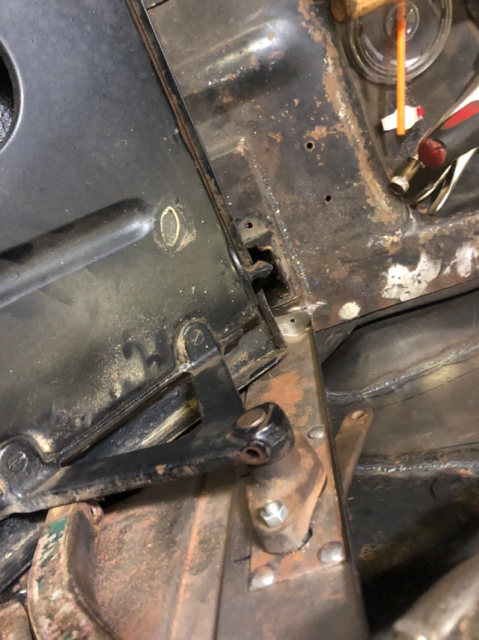

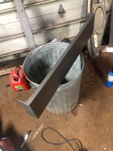

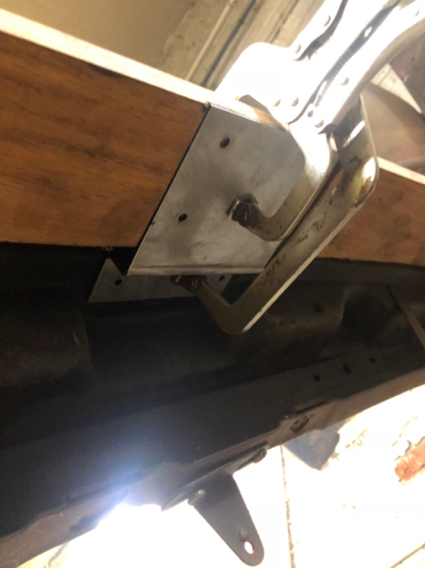

    Brace primed on the backside
    First time that’s done that in lord knows how long
    Rumble stops in
    Edge folded over
    Got it fitting the body really well

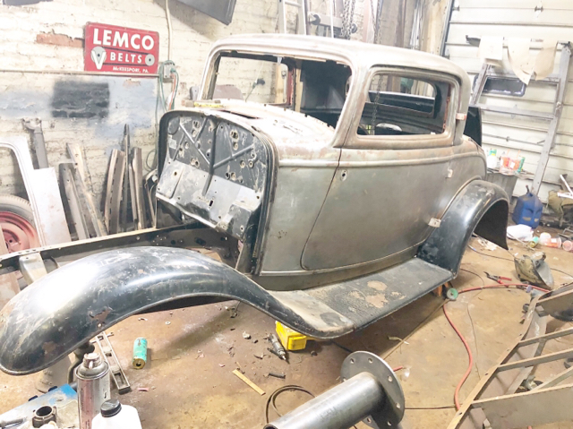

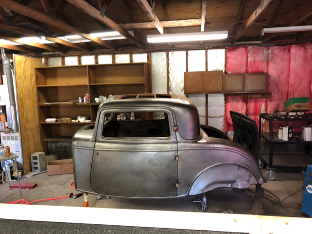

    And she’s going home now .thanks for following along guys . Watch for the next one .
