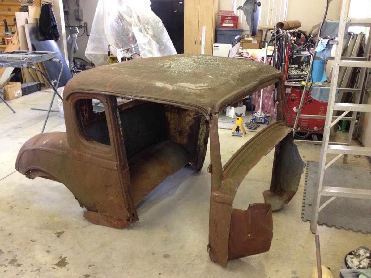

    Tom, Super nice work and a ton of patience. I have to ask you how you are backing up the weld seams across the cowl while planishing . I'm trying to imagine myself reaching under the dash with a dolly and then being able to see what I'm doing when planishing the weld topside. I'm just curious , I'm not that agile anymore. Bill

    Hammer and dolly nothing fancy . You pop through the windshield while kneeling in the car

    That makes my knees hurt just thinking about it. It ****s to grow old. :eek: Great work, Bill
