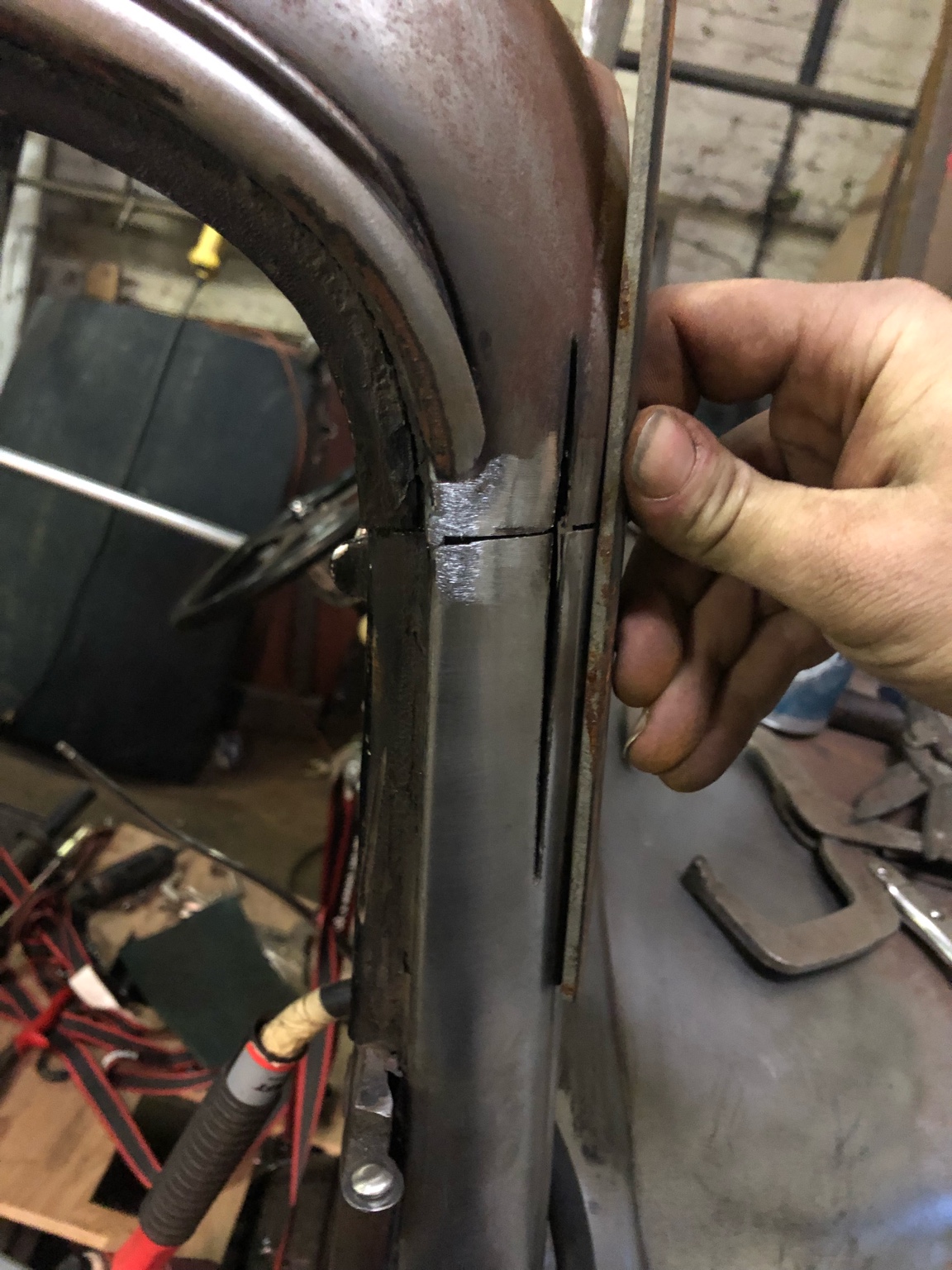

  6. I always enjoy watching a craftsman at work and this thread shows one of the finest. I have a question since some of this is kind of new to me, what exactly did cutting the cowl accomplish, was it stress relieving it from laying back the A pillars?
  7. Flop
    Joined: Jun 8, 2006
    Posts: 3,885
    Flop
    If you cut the middle out of a tapered angled pillar the roof does not line up at the a pillar while the b and c pillar line up . So the cowl is split to lay back the a pillars .

    Flop... does the upper hinge have to change in order to open inline with the lower hinge after you move the A pillar?

    Here's the answer from earlier in the thread........

    yea it didn't answer my question, that was why I asked again.

    Chad, the simple answer is yes. Any time you tilt the top hinge, you need to bend it back inline with the bottom to prevent binding. Using long rod in the pin holes can prove it is in alignment.

    Didn’t bend a thing . Zero bind .

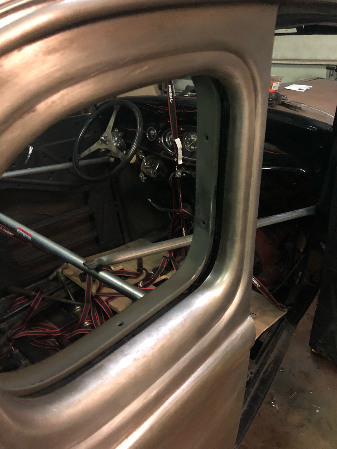

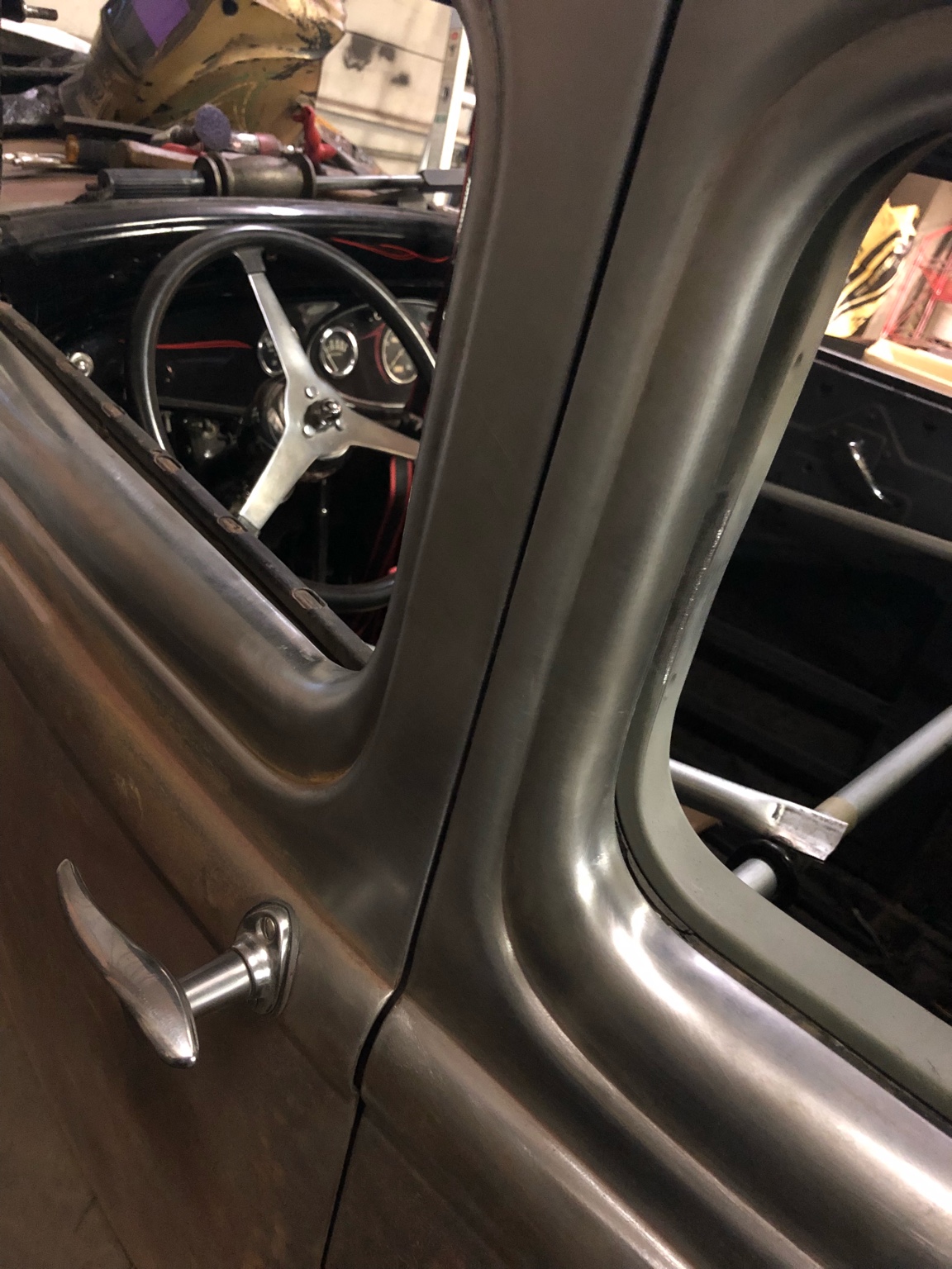

    It’s 2018 ... if you don’t center you counter sunk garnish screws you are a jerk
    Fit up
    brEad, Fern 54, Mikel50 and 7 others like this.

    I trust you'll use oval head slotted stainless screws, with indexed slots.:rolleyes: Bob

    Can’t drive a flathead screw with a powered driver into your die ! [emoji3][emoji3][emoji3]

    Those garnishes tho...
    ...slicker than snail *****...

    honestly, thats there is just 'next level' execution.

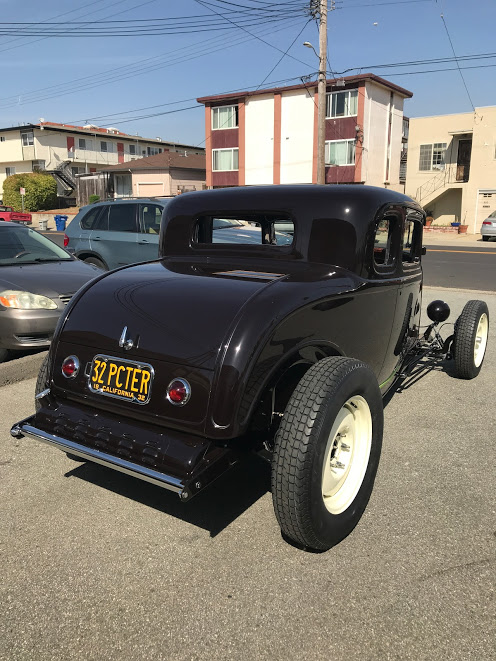

  26. GeeRam
    Joined: Jun 9, 2007
    Posts: 651
    GeeRam
    V.nice :cool:
    Parked outside Roy's shop by the look of it :D

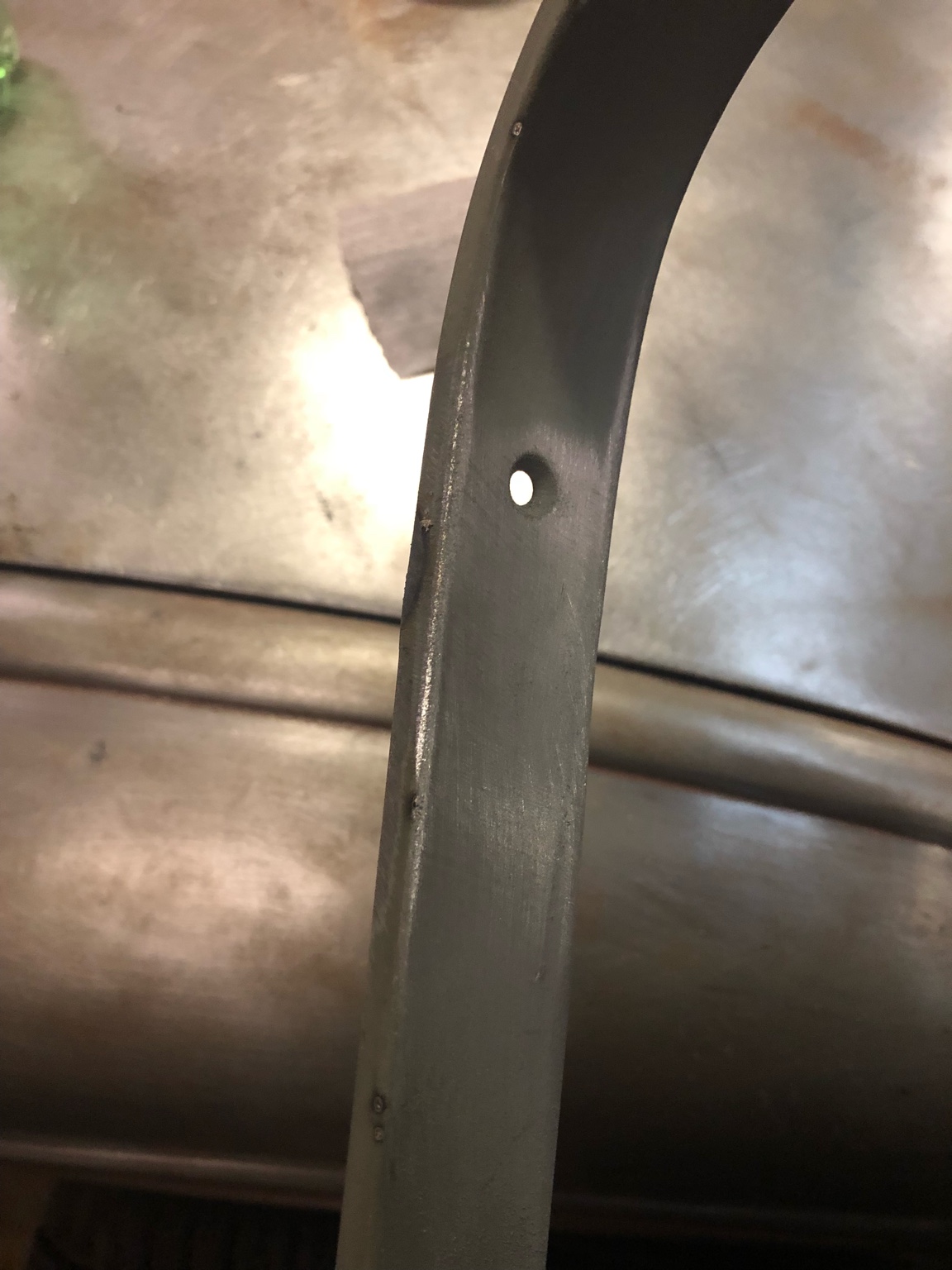

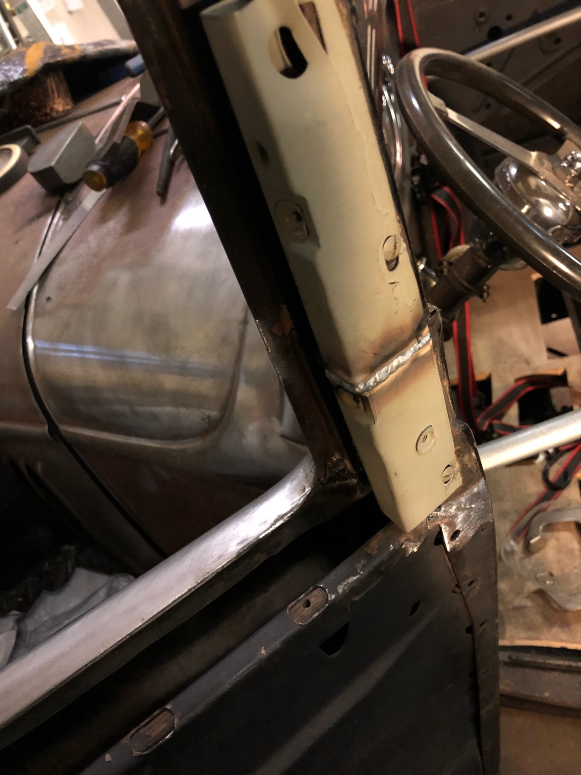

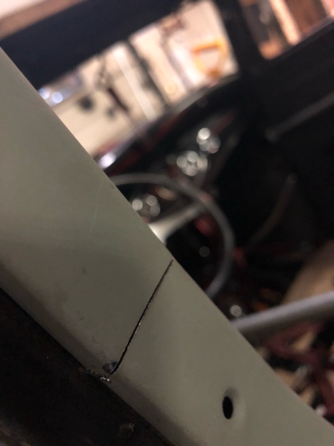

    All the non exciting things no one thinks about when chopping a car properly .
