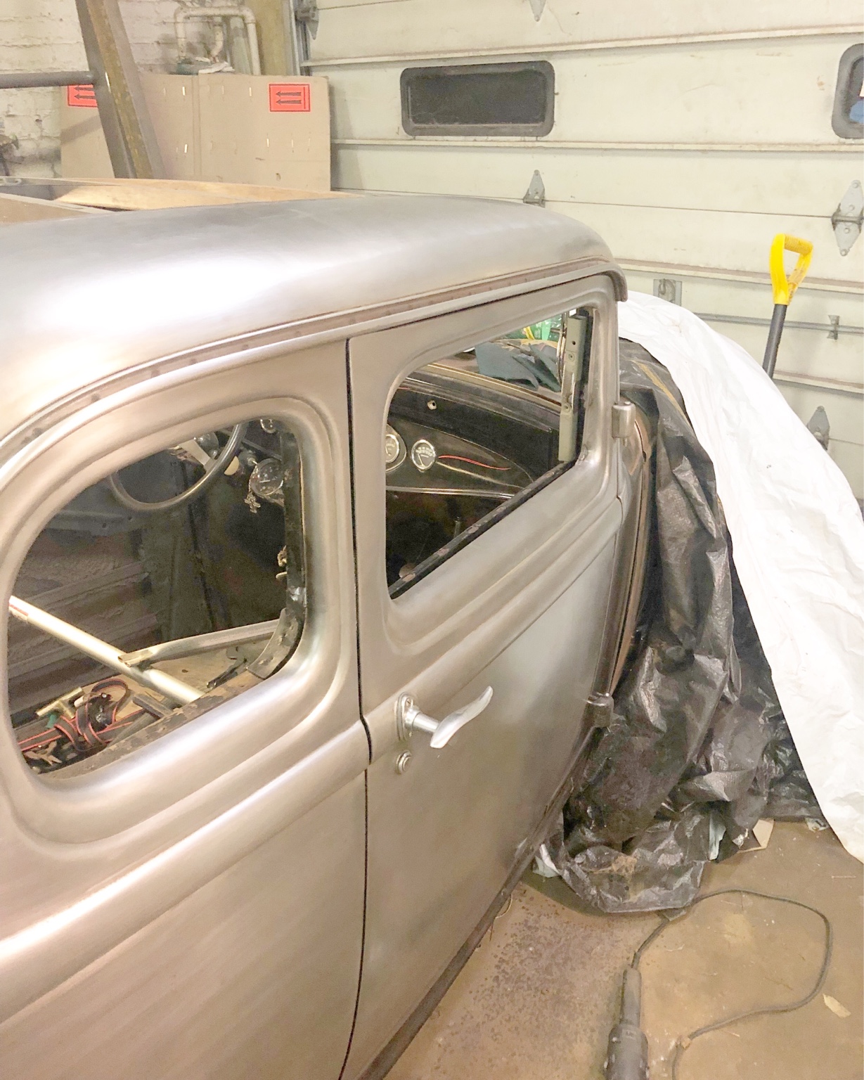

    Yes every cut you make needs welded . That’s why I cut the bottom of the pillar skin out so I could have access to all sides of the A pillar cut . Safety is the most important part of a chop . I know this because one of my cars was in a serious rollover and the chop took what was thrown at it .

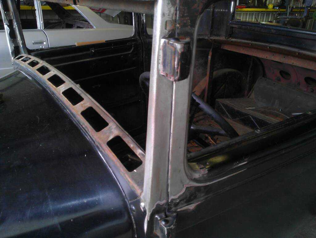

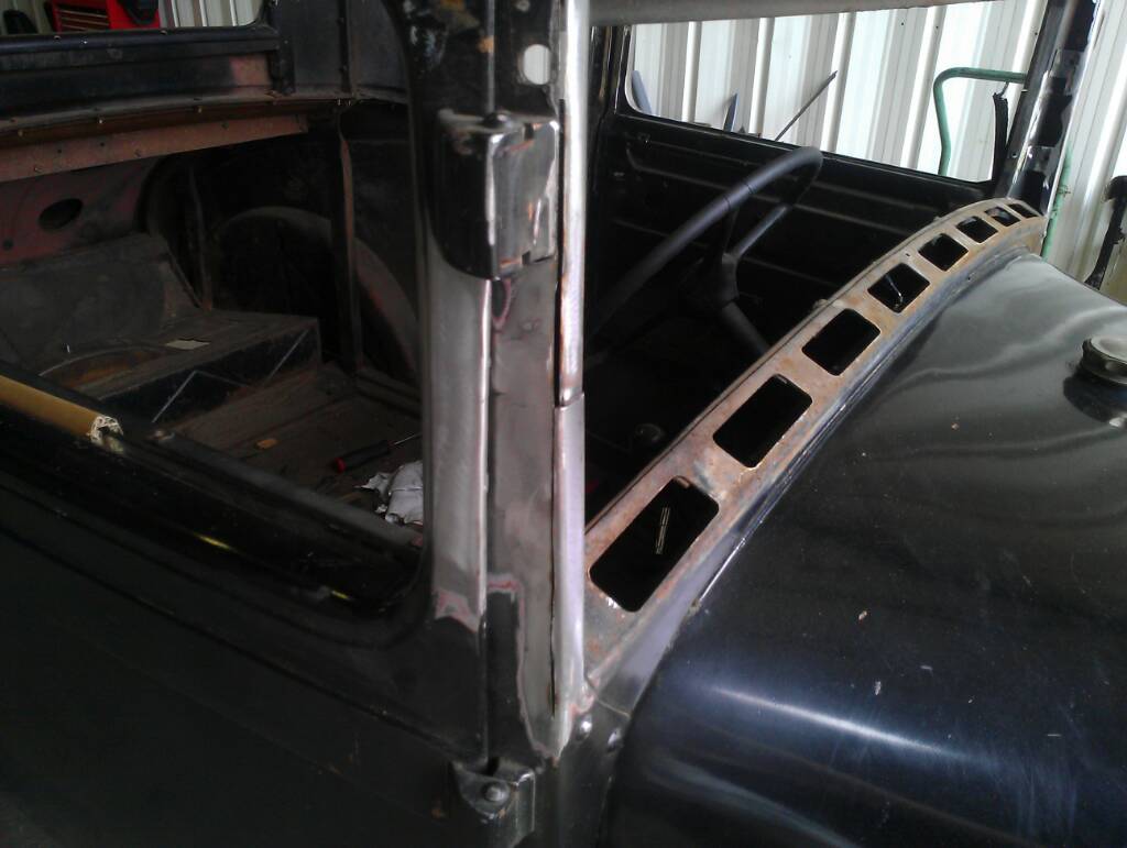

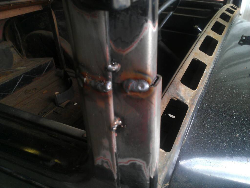

    Flop, once again, I love your detail pic in post #150. It shows how complicated a '33, '34 coupe chop is to do well. Before I followed this and another chop of yours, I thought the chop on my '34 3W was OK. Now it looks to me like it was done by a third grader...with an ax! At least it was done 55 yrs ago.
    For those guys that don't know exactly what they are looking at in post #150, I thought I would add these 3 pics of the A pillar of a '29A chop a friend did. 1st pic shows misalignment after removing 4". 2nd pic shows pie cuts. Last pic shows finished product (welded & ground). I do want to say that chopping an A is like reading "See Jane run" whereas Flop is just finishing "War & Peace"! [emoji122]

  11. I’m probably not thinking about this right, but when you cut the cowl and tilt the pillars back, doesn’t this leave the tilted portion of the cowl at a higher elevation than the rest of the cowl? Do you hammer it back?
  12. big duece
    Joined: Jul 28, 2008
    Posts: 7,222
    big duece
    from kansas
    It doesn't seem to be leaned back at a severe enough angle for the leading edge to "raise", looks as if it just creates an opening or slot that needs to be filled.
