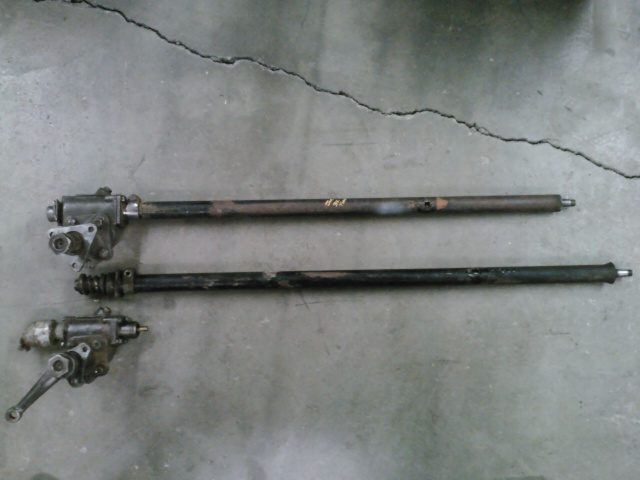

    Hello everyone,
    I was just curious to see if someone could help me out with some original 1932 Ford steering column measurements. Has to be car/light duty pickup. Is it the same as a BB?
    Here is what I have so far:
    * '32 BB (Big H/D truck) Column for reference/parts (Top column in pic)
    * '32 Car/Light duty pickup Box
    * '36 Car/Light duty pickup Column
    Thanks in advance,
    Joe

    Need Steering column tube & Tapered steering shaft lengths.
    Thanks
    Joe

    externally...yes, internally...no.
    The shaft and therefore the worm gear are different. I needed a shaft for my deuce box. I bought a 32 box shaft and mast at Hershey several years ago only to find out that the shaft is larger. From memory 7/8" not 3/4" You can't tell from external measurements.

    Your absolutely correct Tommy! My '32 BB column has a larger diameter than my '36 pickup column. Had no idea!
    Also, my '32 BB Column tube is approx. 36 3/8" in length..Is the car/pickup tube the same length?

    Car tube is 35 1/2 long.

    The BB truck tube is thicker wall also.
    The 32 passenger steering shaft is 40-7/8" total length. You can press the 36 worm off, shorten and re-machine the lower end and press on a 32-34 worm.

    How do you ID a 32 ford steering box? The sector housing as I understand is clocked slightly different to a 33/34.
    I have one that appears, based on my understanding, to be a 32 steering gear.
    I have not disassembled the box in an attempt to find out based on ratio stamped on the gears.

    The mounting flanges are oriented opposite on 32 vs 33-34. In the frame, 32 has 1 hole up, 2 down. 33-34 has 2 holes up, 1 down.
