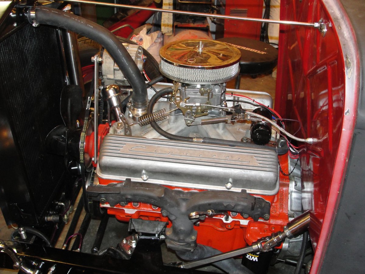

    I have this one in my 32 roadster with a 327 and l-79 cam with 3.55 gears , 31" tall tires and it works great at all speeds.

    Nice roadster!!! Just remember though, what works in a roadster might not totally work the same way for a 4000 plus pick up. Just saying. [emoji3]
