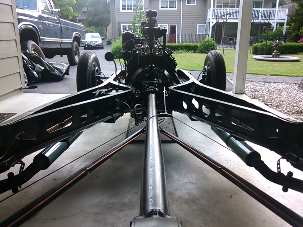

    The plan was to clean up the ch***is and build up a 59A flatty that came with the trade and a 4" merc crank I got from a friend. I also picked up a decent 39 ****** from the Spokane swap meet 3 years back. (I dont know about you guys but I am jonesing bad for a swap meet).
    Anyhow fast forward a couple years now I'm going on it with increased urgency because the injector pump on my old 6.9 idi is showing signs of needing a rebuild. I want to make this 34 my daily driver ASAP so I am foregoing most body work other than welding up holes, cracks, and cleaning out subframes and treating for rust.
    Money is tight right now so everything is being done a combination of old school, gas welding because that's what I have available now, 4" grinder with wire cups for rust removal, and lots of rust inhibitor primer plus rustoleum.
    I had some 48 ford brake drums turned at Raymer's machine shop Tonasket WA.
    Rotor rootered out the stripped 59A block with a squiggly coat hanger and my cordless drill. Got a decent pile of **** out before dropping at Paul's Machine in Oroville WA. Block p***ed with flying colors, Of course one bore needed to go .060 over so the whole block was bored out to match. Paul said it was his first flathead V8 block with no cracks.
    I got new pistons, valves, adjustable lifters, sent camshaft to Delta Cams Tacoma, WA for a Winfield SU1A. I'm running stock 59AB heads, a repop edelbrock slingshot with new $$ made in England 97s.
    Running a regular Ford 59AB dizzy and keeping it 6V because I had a battery and
    The stuff laying around. The theme of this project going forward and during this pandemic is using what I have laying around.
    Wire wheeled the frame off, repaired cracks and missing rivets, and ran brake lines for the first time ever. I really recommend Matt (Irontrap Garage on YouTube) videos. I learned everything I needed to know to do the brakes from him and HAMB.
    Just did the exhaust-wrinkle bends and gas welds 2" tubing from O'Reillys. Low budge and old skool but turned out solid and functional. Cheated a bit because I already had a set of Reds Headers for a flatty so using em up! IMG_20200723_190449_274.jpg IMG_20200723_190521_761.jpg

    The master cylinder bracket was a Hamb cl***ified score that I reinforced with angle iron. It was a little cast aluminum An IMG_20200723_190548_979.jpg sen piece but I just couldn't handle how it torqued when I pressed the brake pedal.

    Front axle is a 34 piece dropped by "Okie" Joe Casto. He did a great job, and dropped my 37 spindles for me also. I think its about a 3" drop. Removed a few spring leaves front and back. I was really impressed with how nice Spokane Chris' 33 pickup, (the Gumby green one) sat so I'm shooting for that full fendered, bit of a rake.
    Rear tires are Coker 7.00 x 16 and fronts are 5.50 x 16. I found some 1940 wheels after mounting the tires on the grey rims, so I will be swapping the tires onto black solids with 1940 standard hubcaps and trim rings.
    I used the bench grinder with a wire wheel to clean all the spring leaves, replaced the bushings, greased and painted.
