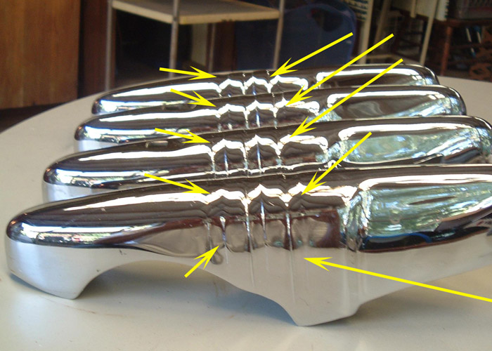

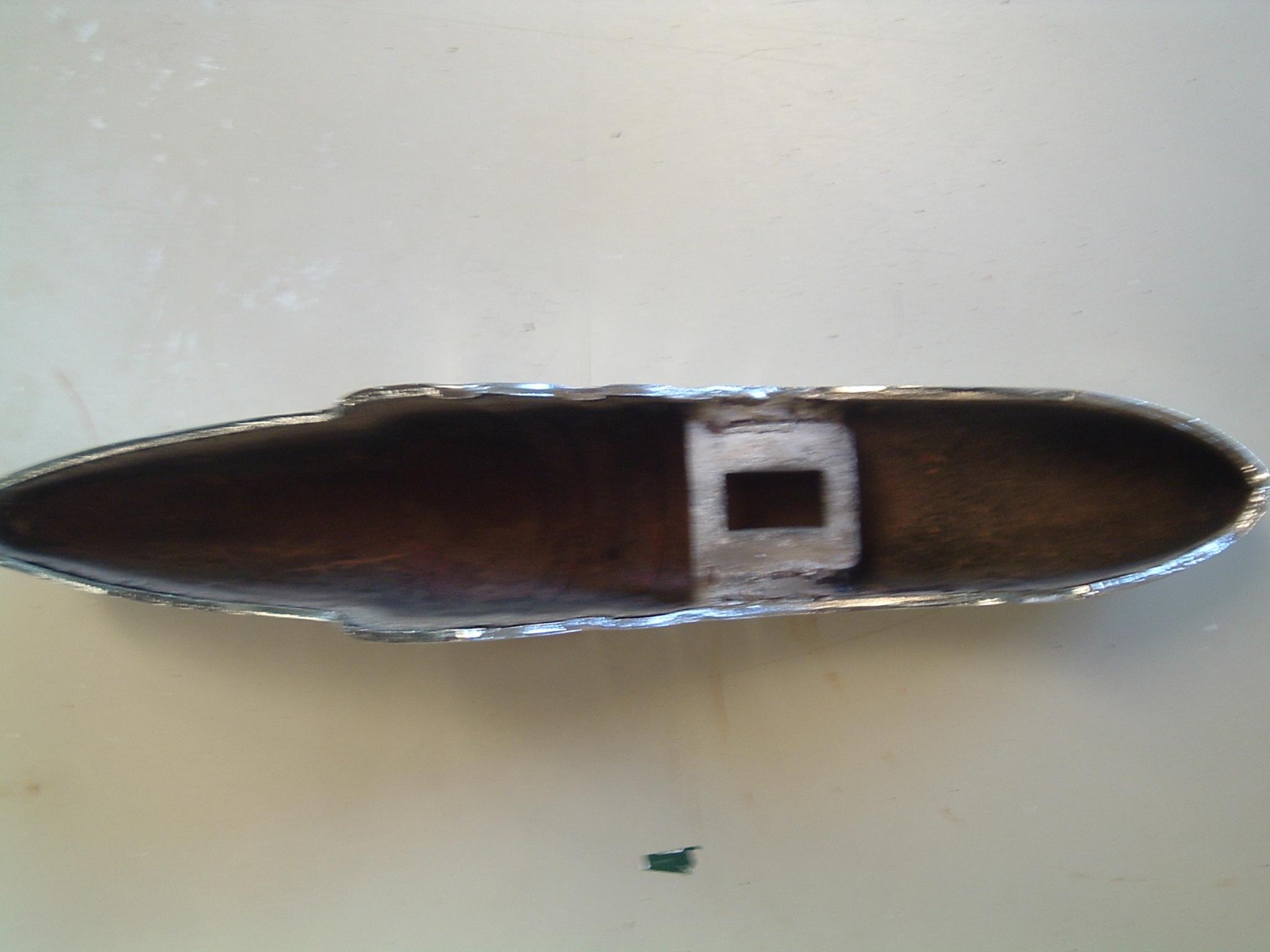

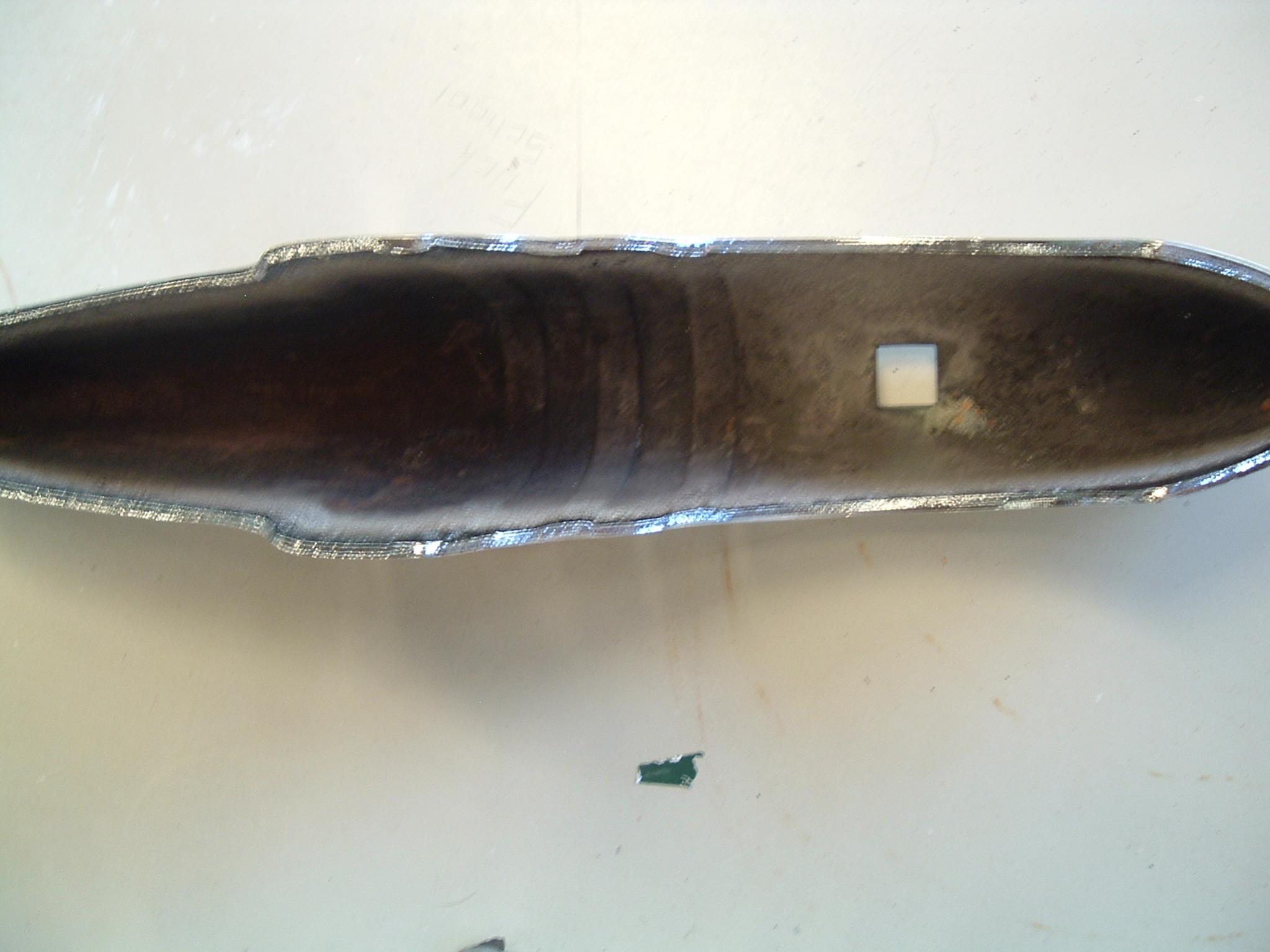

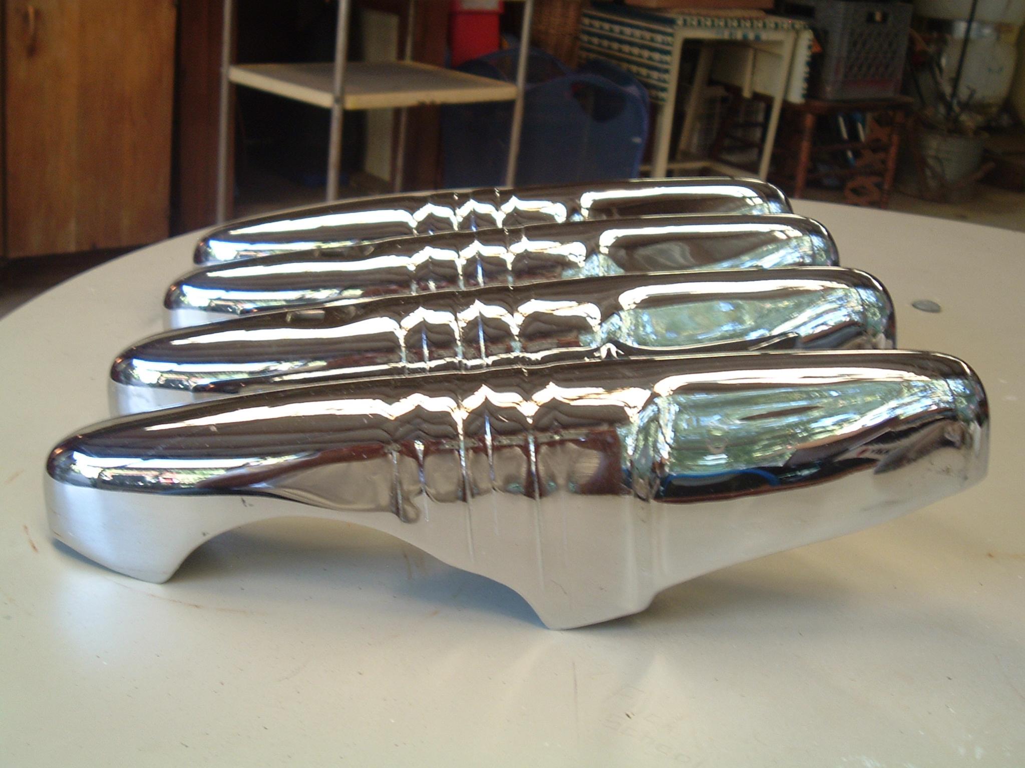

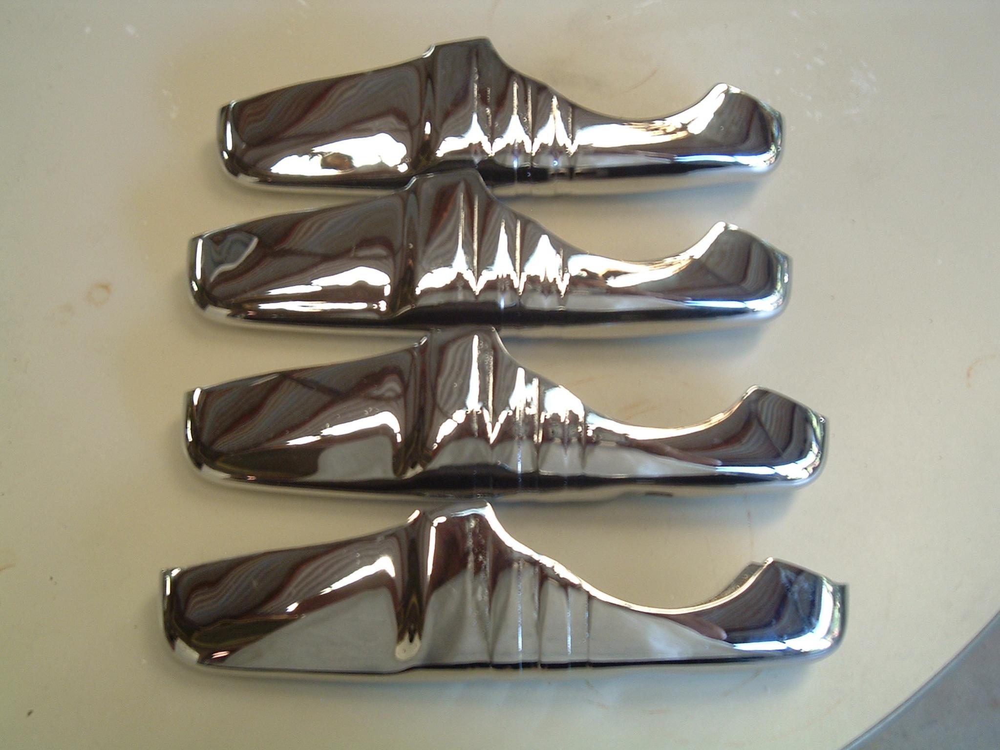

    Ok guys, Iam sorry but it is Me & these Bumper guards again. Thanx to
    Kuztomklaus, We have IDd these to a 41 Chrysler. Now wether its a Chrysler
    coupe,sedan or a 41 Barrelback Woody, I Dont know. I cant seem to find any
    numbers. Does that mean they are reproductions? If someone can tell by looking, please let me know. Thanx

    They look like the might be rechromed originals, but it's hard to tell from the pics. Are there any hammer marks inside? the hammer marks would be a narrow line, about 1/16" wide by 3/4" long, that's what they use to fix bumpers. Also a close up view of the recesses in the middle (the "stripes" around the outside) could show pits that might not have been fully removed when they were buffed before plating.
    I'd be shocked to find they're reproductions, for a car like that. Not much of a market for them, and it's expensive to make the tooling.

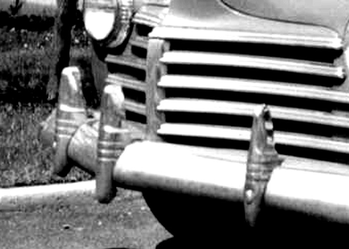

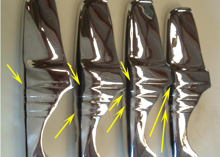

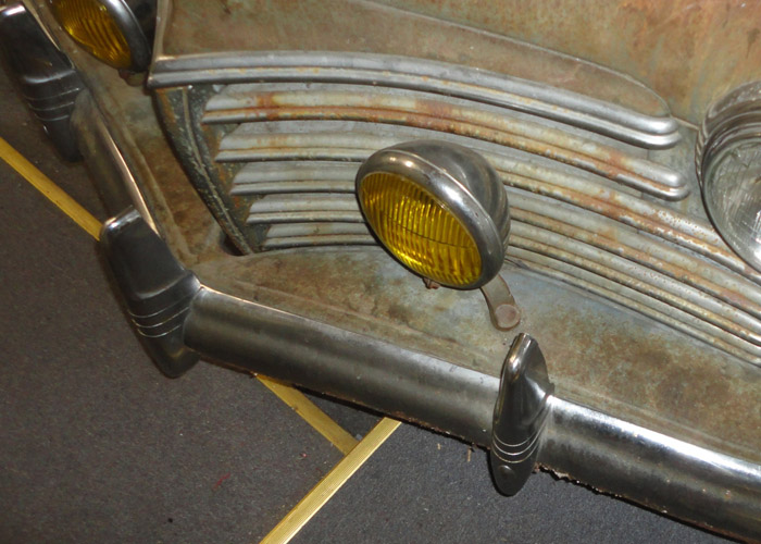

    Looks like replated (poorly done). Most of the features have been ground off in the plating process. A complete set would be 5 guards (3 front/ 2 rear)
