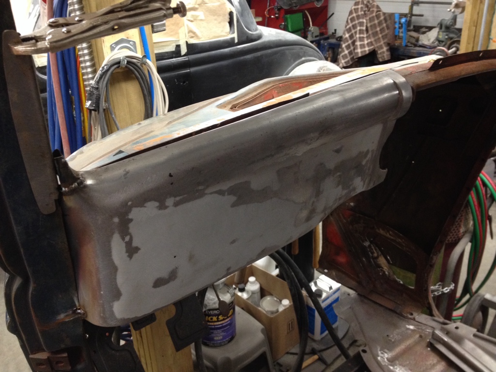

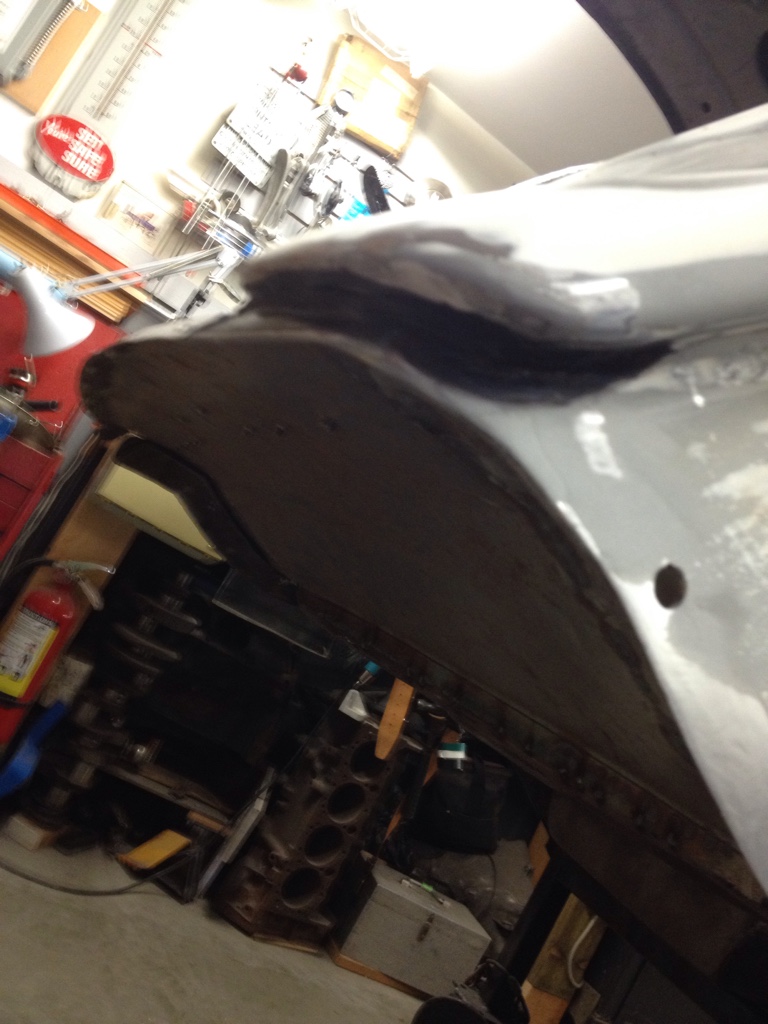

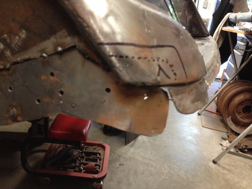

  5. I'm getting close to wrapping up the rear metal work. As mentioned before, I thought the transition from the wheel house, through the floor to the end panel looked awkward. This is how I've finished it. [​IMG][​IMG][​IMG]
    This is why I replaced the cap on the Rt 1/4.[​IMG]
    This is how I formed it.
    Make a light cardboard template. [​IMG]
    Transfer it to sheet stock and roll the lower edge profile with a 1/4" bead roll. I do this in 2 p***es to maximum depth. Make sure the piece is larger than you need. Its way easier to hold on to, won't distort as much and can be trimmed later. You want 1/2" to fold under. [​IMG]
    Now start to work the hem. I use 2 different Marlin Spikes ( God's gift to metal forming) one that I've rounded over (they're usually mushroomed when you find them ) and the other is an undercut. [​IMG]
    Start at the end furthest from the corner. With the Spike held securely, place the rounded over edge on the inside of the underside of the bead and strike the hem edge lightly with a close to flat body hammer. Work your way along in multiple p***es to fold the hem to 90 degrees. Also work the short side evenly. When the corner starts to pucker, apply some heat at the pucker only and work it down. Easy on the heat, you want to keep the carbon at a minimum. Repeat until you achieve the shape you desire. [​IMG][​IMG][​IMG]
    I wanted to do away with the shallow corner that meets the rear fender as I'm not going to run them, so the radius is smooth. [​IMG]
    Next I'll fit it, metal finish it and **** weld it in place.

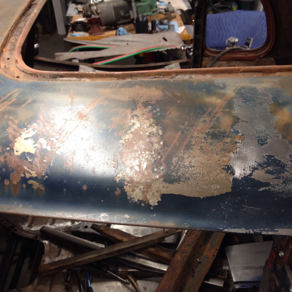

  21. I spent the afternoon removing dents from the roof(chaindamage) and Lt 1/4. Managed to save some of the paint but some did flake off. More bare metal to love. [​IMG][​IMG][​IMG][​IMG]
    Thor1 and dwollam like this.
  22. Step 2, how to make it look like it is not a work in progress.
    I'm fine with rust, as long as it is old established rust and not perforation.
    I am not OK with dents. In my mind, dents are the difference between well worn and beat to ****. Weird eh?
    Dolly'd out the dents yesterday and I need to do something about the "shiny" area.
    I had an idea that Cold Blueing compound would work, as I've used it to antique projects in the past. If the metal is clean and grease free, it colours it a rich dark rust shade. That's what I want. I boarded the repair area with 80 grit, being careful not to remove the old established surface rust. Then treated the whole area with Picklex20 to kill the rust, 2 applications to keep it wet for 10 minutes, dried it thoroughly and applied 3 coats of Birchwood Casey Super Blue with a Q tip, keeping it wet. When I had achieved the colour match that i wanted to the established rust, I neutralized the blueing ( or in this case Bronzing) with water, dried and hand buffed it with towelling and hit it with Gibbs, my finish of choice. [​IMG][​IMG]
    Thor1 and Outback like this.
