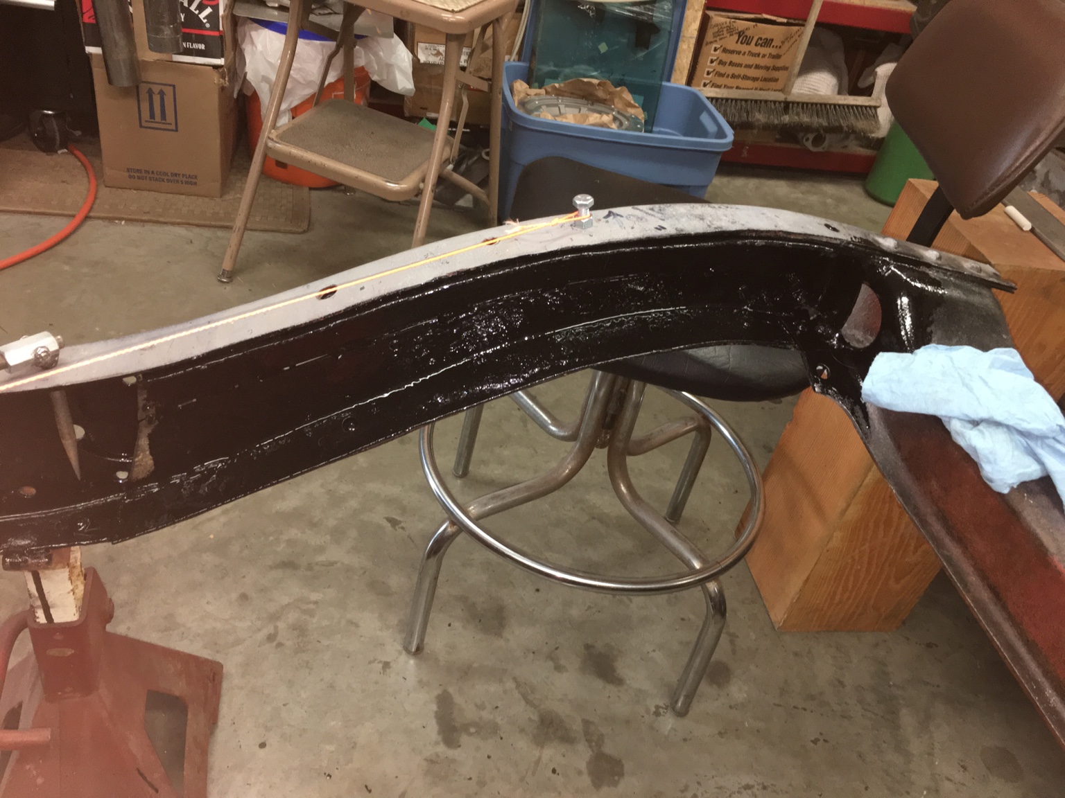

  14. I had a pair of cast off frame rails that were rust perforated at the torque box area. I decided to cut these up and use them inside the frame as stiffeners. I didn't want to box the frame, as I consider this as a more modern approach to frame reinforcement. Had the rails blasted and treated them with Picklex 20. One area at the peak of the right kick was torn, so repaired with a doner section from behind the cmbr.

    The idea of adding supports to key stressed areas/known fatigue points without going to fully boxing makes a lot of sense. Was curious about "treated them with Picklex 20", so watched a couple of videos. Looks like impressive results.
  16. Hendee, I could go on and on about Pickex 20, I think its a great product. As long as you keep the treated parts dry, they will not rust. It rejects weld spatter and when you're ready to paint, I wipe the part with wax and grease remover, then a cloth dampened with Pickex just in case and paint it. No need for etch primer. They should pay me for this endor*****t.

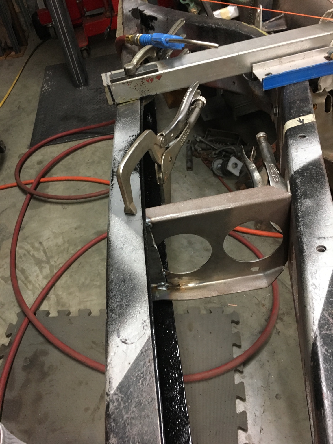

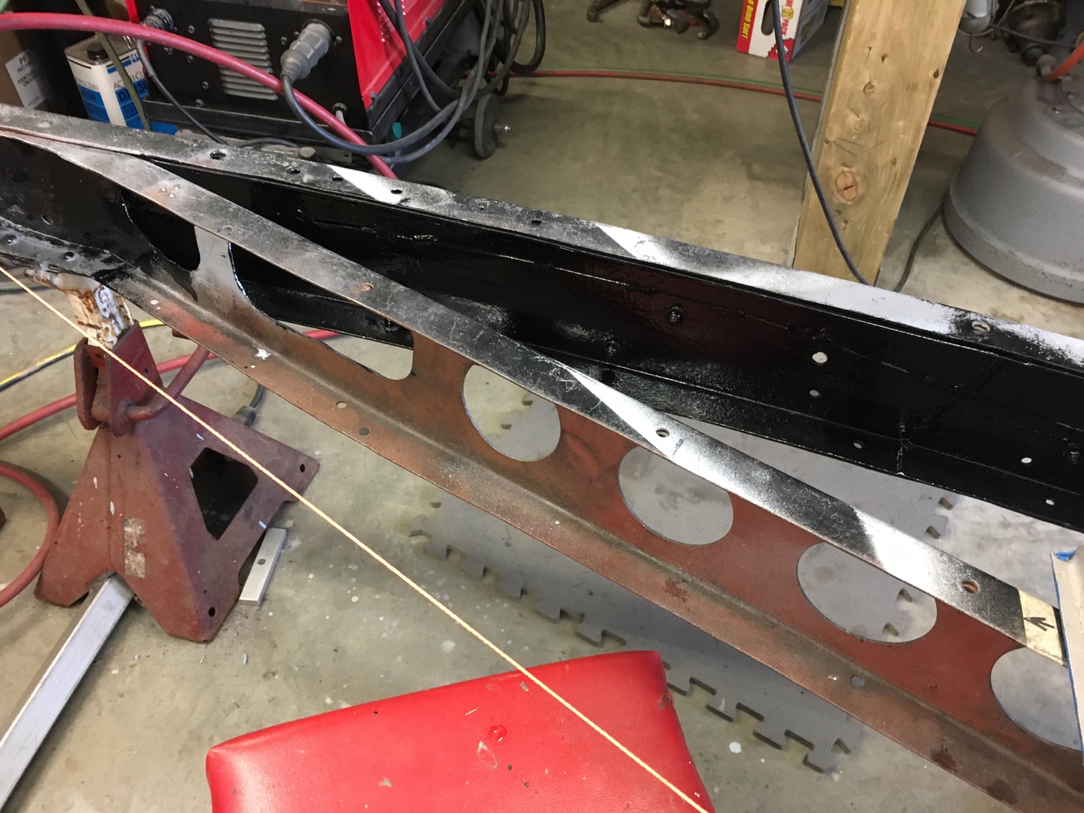

  20. Left side ready for paint and ***embly. Weld through primer on seam areas, por 15 on the rest and inner rail, then Por15 top coat. [​IMG][​IMG][​IMG][​IMG]

  22. I made some frame braces out of one 35-40 original. The front will be braced by the battery box on the left and exhaust hanger on the right. [​IMG][​IMG]

    I'm enjoying following your progress. I was wondering what the reason might be for the stiffeners being split top from bottom. Thanks for sharing your build!
  25. They are old 34 frame rails and are the same height dimension as the outer rail that they fit inside, so must be sectioned horizontally. In order to get them in place, they had to be cut lengthwise, which I did at an angle to increase the strength. Then just a matter of slotting the stiffener holes slightly and bolting them in place, using only original holes and s***ch welding them back together.. I had to hammer dress the flanges in several places, where distorted, but so far the fit is very good. I am confident that this will increase the frame strength by 50%+
