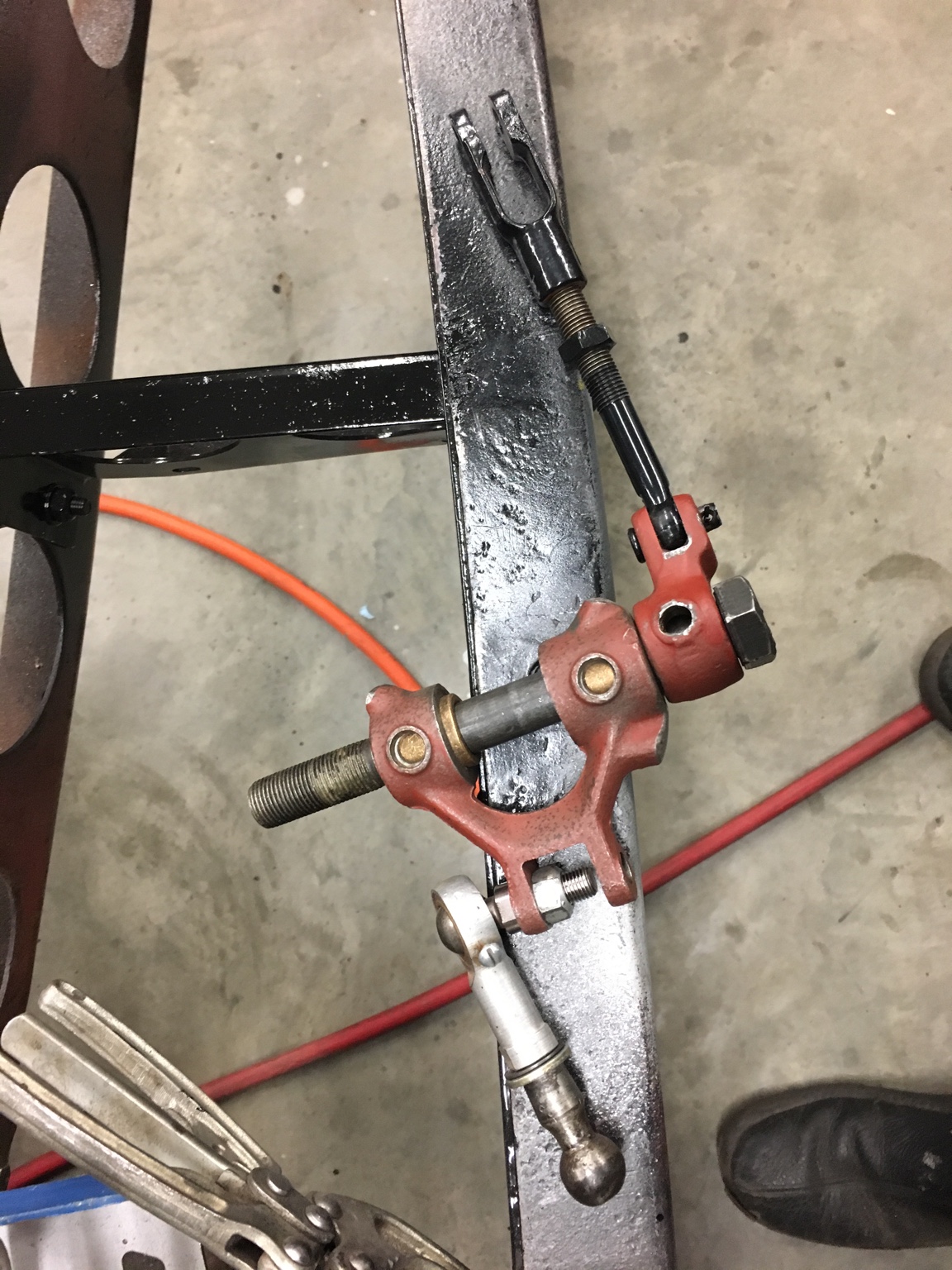

  2. I'm struggling with the clutch linkage, the 34 pedal intersects the Buick throw arm as it comes back. I know I need to make a bell crank to convert the pedal push to throw arm pull, but it is just to tight.
    I hate to break up an NOS 39 pedal ***y that has taken me 10 years to collect, piece by piece, but what's a fellow to do. A hydraulic throwout bearing would have to be custom made to fit the Cadillac transmission, that's out, so I'm cannibalizing the 39 and a 36 ***y to work.

  10. I think I have the clutch/ brake linkage problem sorted out. I found a 47 ton & 1/2 brake/ clutch pedal bracket ***embly at my local old Ford parts supplier (Terry-250-743-2814)
    and mocked it up with a 36 brake pedal as a clutch pedal and the 47 ton&1/2 brake pedal. I threw the 47 clutch pedal into my metal bin. It is flat stock and not attractive at all.
    The 47 brake pedal is 1.250” longer in the ratio than the 36 p***enger brake pedal, but after some heating and bending, will be close to the same length from pivot point to floor opening. The bell crank is a 36 brake relay bracket piece, or brake equalizer piece and will transfer the clutch pedal motion. [​IMG][​IMG][​IMG]
    More on this, after I get the mounting bracket made from 3/16” plate instead of wood and get the ratio and linkage dialled in.
