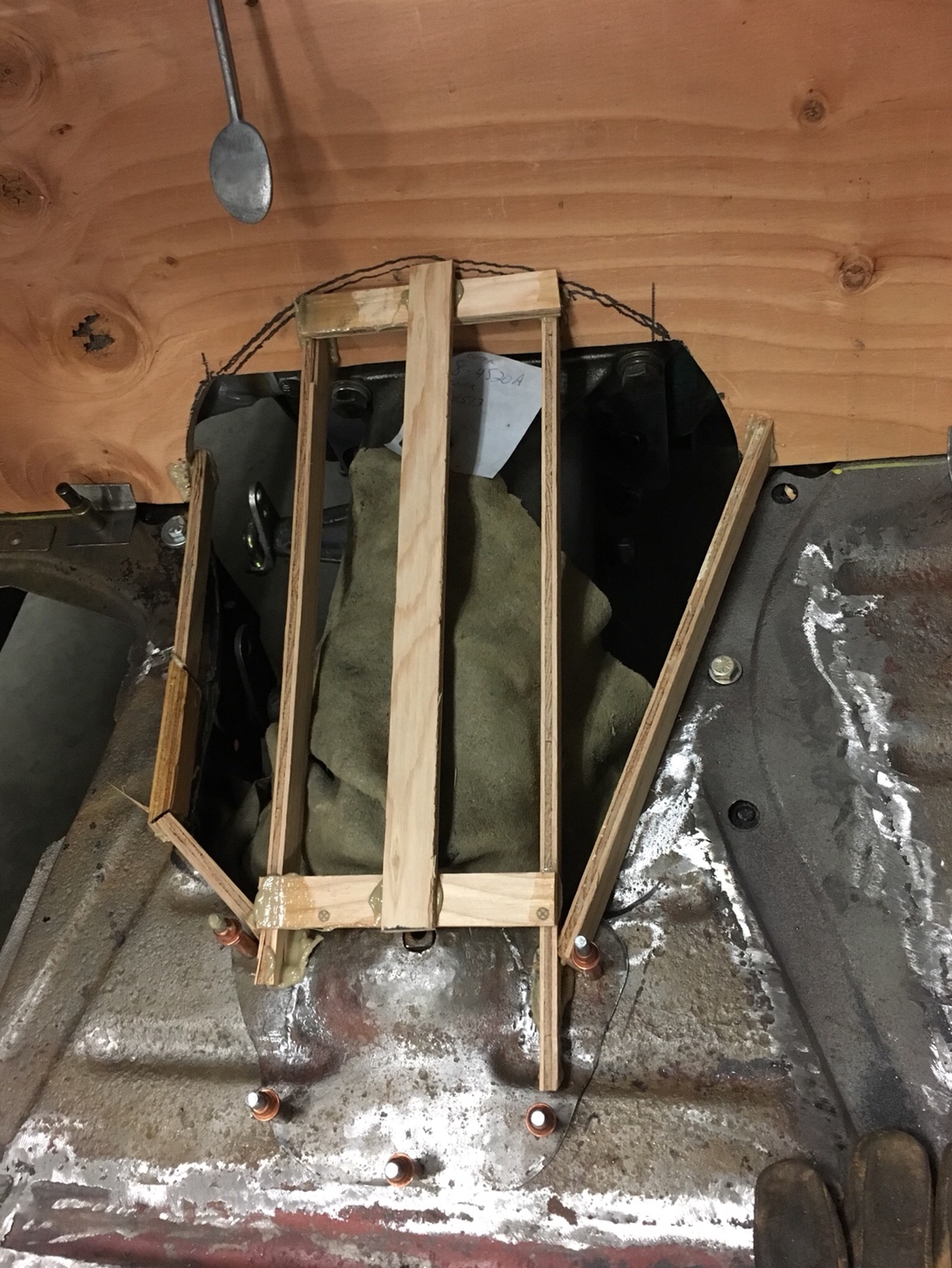

  25. You can do it. I used 18 gauge, but I think 20 g would be strong enough. Make a quicky wooden buck like in the photos and go from there, roll the piece to basic contour with a slip roll or over a gas bottle with 20g. go around the perimeter, defining the flange area with your smallest bead set, on a cheapo bead roller to start tipping it up and use your shinker/stretcher to work it the rest of the way. You'll need some heat for the tight corners. I'm not saying its easy, but with a little thought, as to which way you want to move the metal, it can be done. I got lucky and did it in one try, but if it screws up, start over. D
