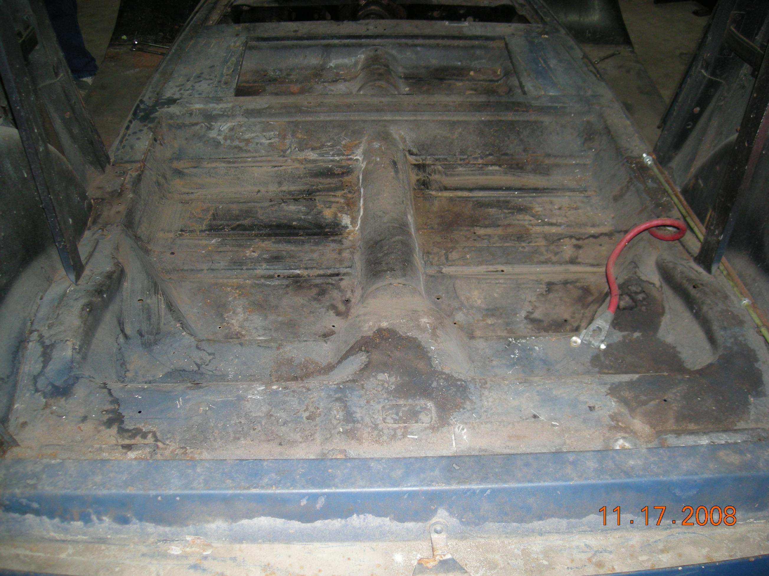

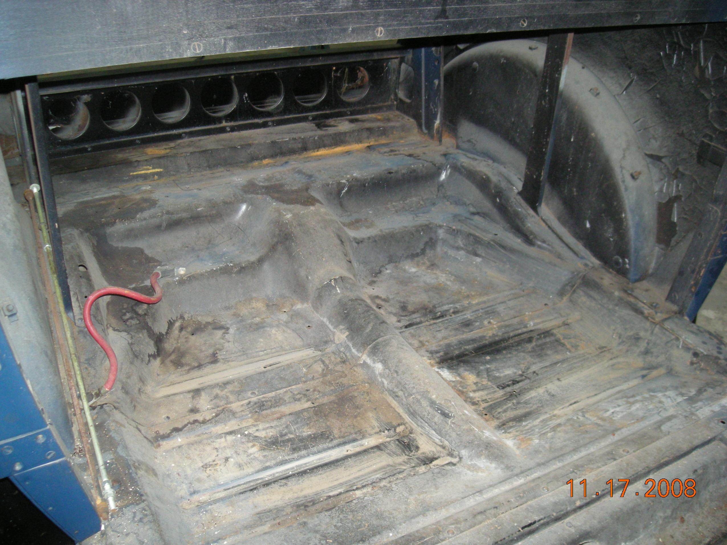

    Here's an original 3W floor.

    A 3 window floor is unique to the 3 W and very hard to locate in good shape. A Vicky is different yet.

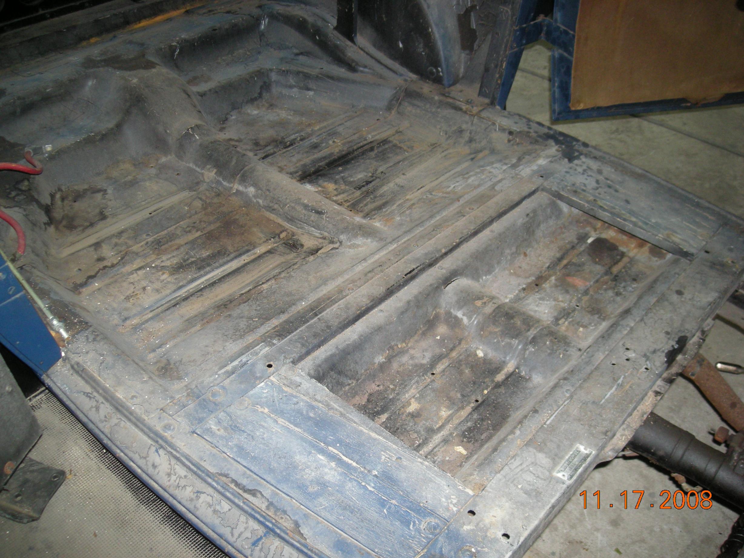

    Here are more pick from a 3 W. only the 3 W and Vicky the floor dips in between the frame rails.

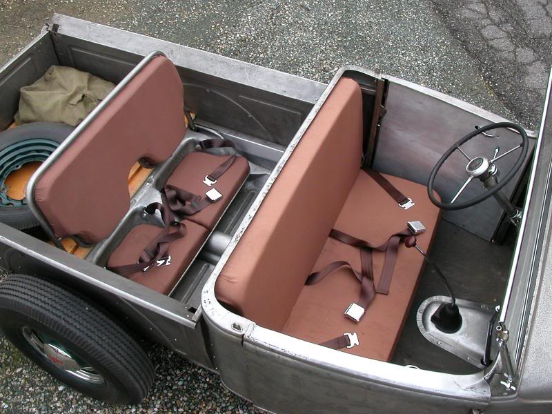

    Brookville made the logical choice by using the flat Roadster/5 Window floor. More often than not their body will become a hot rod and be mounted on an after market frame. I put a roadster floor in my 3W for clearance. The original floor was rotted out and not worth saving plus the foot wells in the trunk were useless and interfered with the suspension and exhaust.

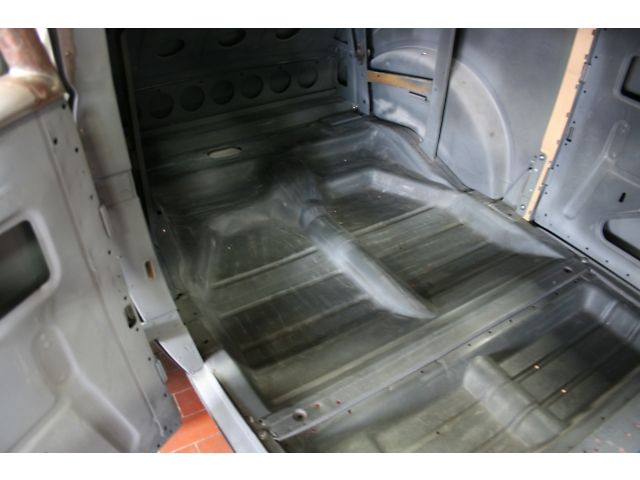

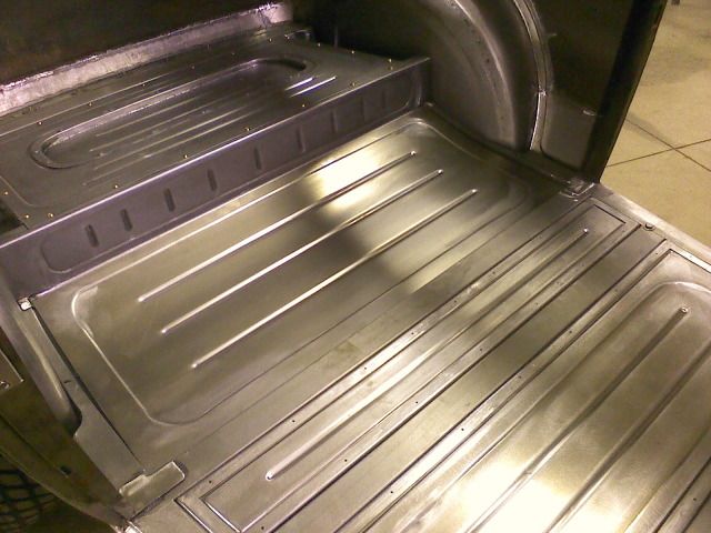

    Here is a real 3 window floor and a new one built by Steadfast. As stated above, most hot rod chassis require a flat floor. A stock 3 window in this shape would be one you would want to save for a restoration and the other one is pure art with a master craftsman behind the bead roller.

    And the rare RPU rumble seat option...haha. I had access to both a 3W and Vicky floorpan to get ideas for my floorpan.

    Gorgeous rpu floor.

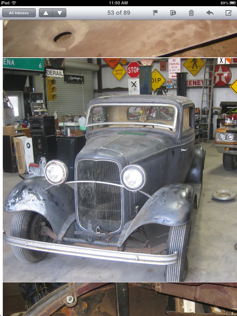

    My floor is shown above and I have an extra floor, just wondering what it would be worth. Here's a pic of my car, cause I don't know how to post it under my name, like I did at the hamb. G-man

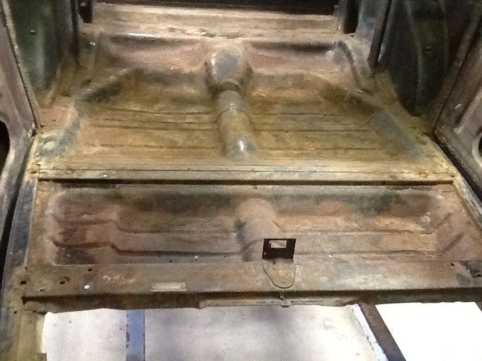

    Here are floors from 3 different 32 3W Cpe’s. I lined them up to give you an idea what different section look like.

    try again, orig 32 3W Floors/
    Halleluiah! The 10th time worked.
    the back section is just sitting on the floors in the foreground, they are from a diff 3W Cpe.
